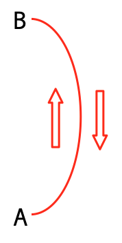

I want to machine a curve (point A = start of the curve, point B = end of the curve).
Millmage machines from point A to point B, then raises the spindle, returns to point A, lowers the spindle, and machines the second pass, etc.
Is there a way to machine “back and forth” to save time?
Best regards ![]()

Let’s imagine that I want to machine this curve. Millmage only machines from A to B, then returns to point A in a straight line (without machining) and then starts again from A to B (machining).
What I would like is for Millmage to machine from A to B, then from B to A, then again from A to B, etc., in order to save machining time.
Is this possible?
Best regards

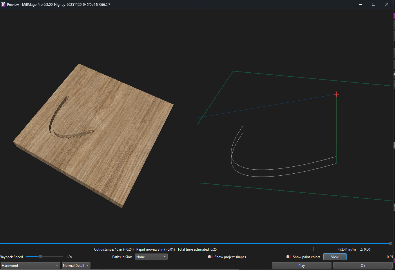

I thought I replied with a .mage file last night. Are you running a double posting? Anyhow, I did this with a 1/16” slot, 1’16” tool, 99% stepover, and Pocket operation.
Curved Slot.mage (18.2 KB)

I just duplicated the first operation, and changed the cut from Climb to Conventional

Apparently, your solution is the only solution… So we have to duplicate the operation, changing the direction each time. In other words, if I have to machine 16 mm with 1 mm per pass, I have to define 16 operations.
What I would like is for Millmage to change direction with each pass, with a single milling operation at a depth of 16mm with a 1mm pass…
Best regards.

I cheated. I made the pocket the same width as the cutter (actually 99%, I was afraid to try 100%).
Technically, you cannot mill a line because it has no width. That is why I selected a Pocket operation.
