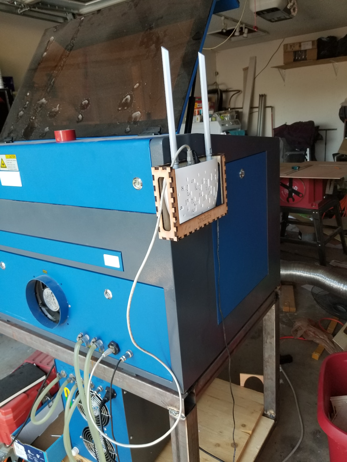

I currently have a T-Link bridge (router configured as a bridge) that works fine and it’s pretty cheap from Amazon. I paid $12 back in 2021 and now it’s advertised for about $15.

If you use the LB Bridge, you want the Ruida set to it’s default 10.3.0.3 IP.
If you’re putting it on your lan you only need to tell the router the devices MAC address and to associate that MAC with whatever IP you put on you laser. If it’s on your lan, all devices have to be in the same domain.
You don’t modify your PC, it gets it’s address via the routers DHCP firmware. If you put it on your lan behind a bridge, it doesn’t matter much what IP it’s has, as long as it’s unique.
