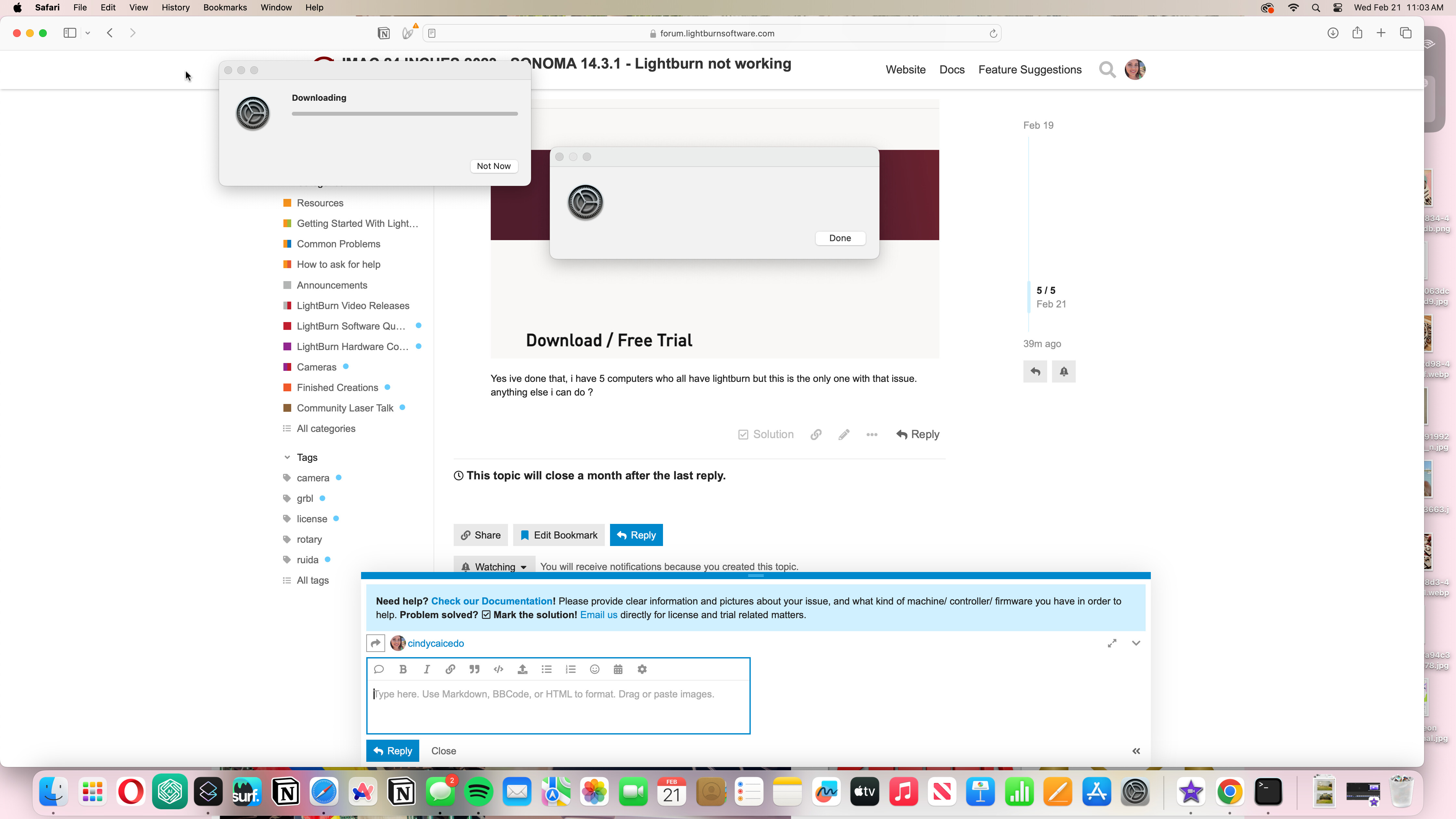

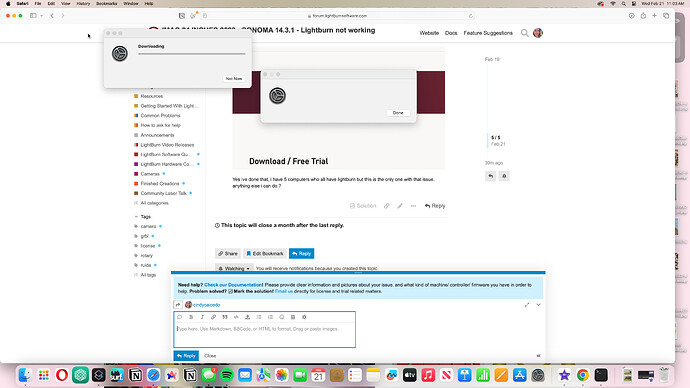

Hey thank you for answering me, I downloaded the download trial, everything downloads but when I press the red icon ( light burn icon ) to open it says downloading and then it goes to the full bar but nothing else comes up , and then when I try again the whole announcement square just comes up clear doesn’t show the bar of the downloading or anything else. I can send a screen shot around 3 when I get home.

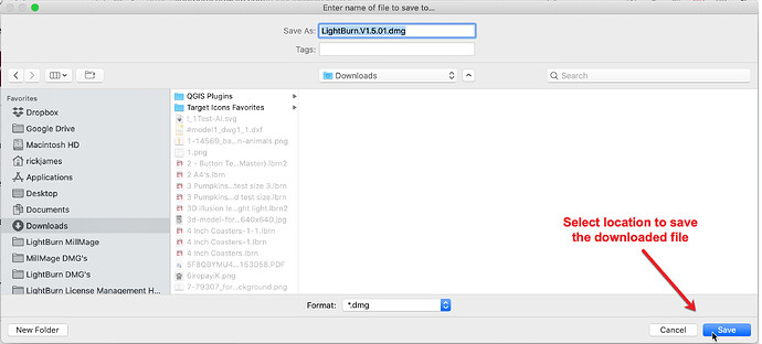

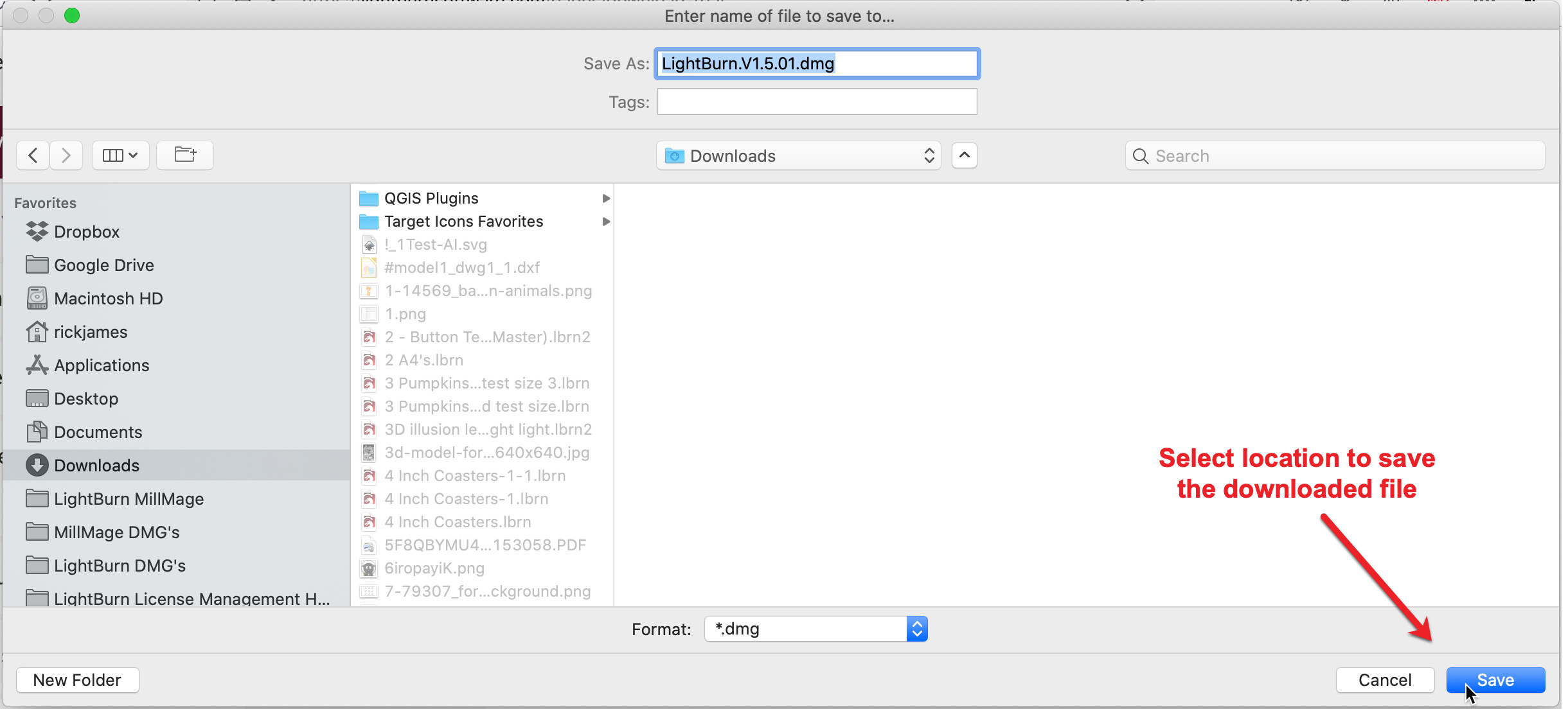

When I hit the download button from our site, I get the following Finder window allowing me to select the location to save the downloaded file. The file should have a .dmg file extension.
Then open Finder and navigate to the location of the saved file, then double-click the downloaded file to start the installation of LightBurn.

Yes ive done that, i have 5 computers who all have lightburn but this is the only one with that issue. anything else i can do ?
or either the one that says downloading not now, and stays stuck on it.

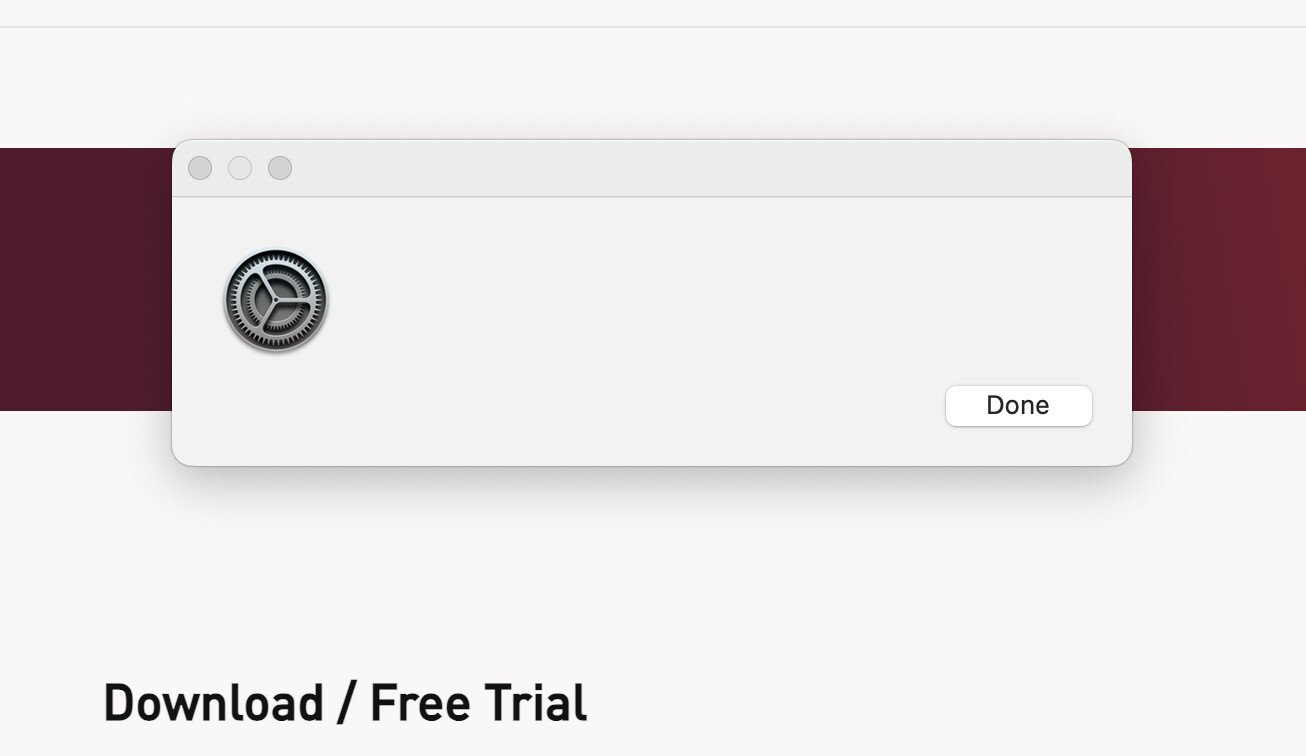

after downloading this is what I get and gets stuck like nothing else… idk what to do …
I GOT IT !!! the computer needed to install something called ROSETTA so it installed that and boom it worked. thank you so much
FYI, Rosetta is the translation layer in MacOS that allows applications made for x64 architecture to run on ARM. This is necessary since Apple moved to their own CPU designs a few years ago. LightBurn does not have a native ARM build currently.
