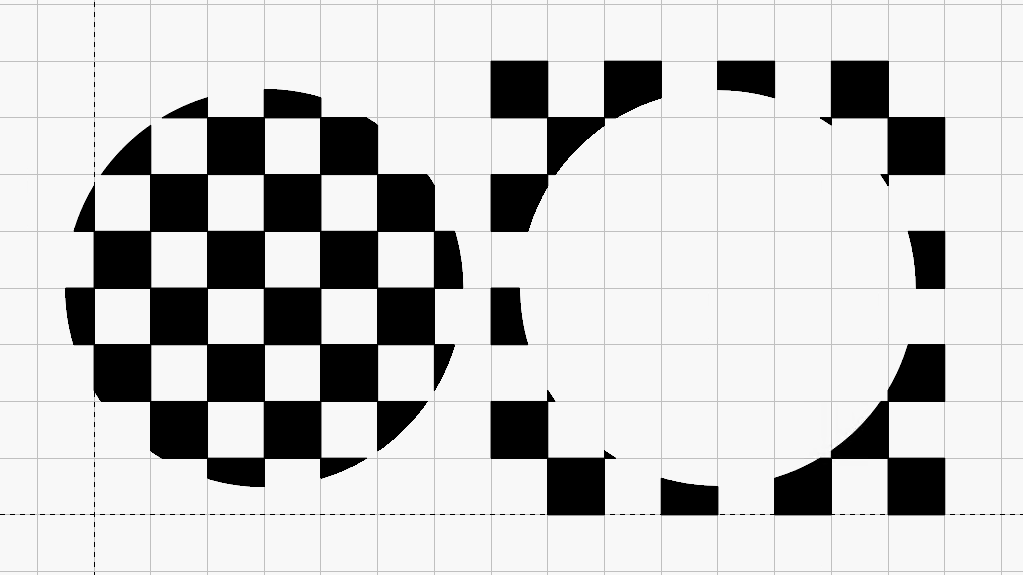

Perhaps applying a circular Cut Shape to a Grid Array of boxes would do the deed:

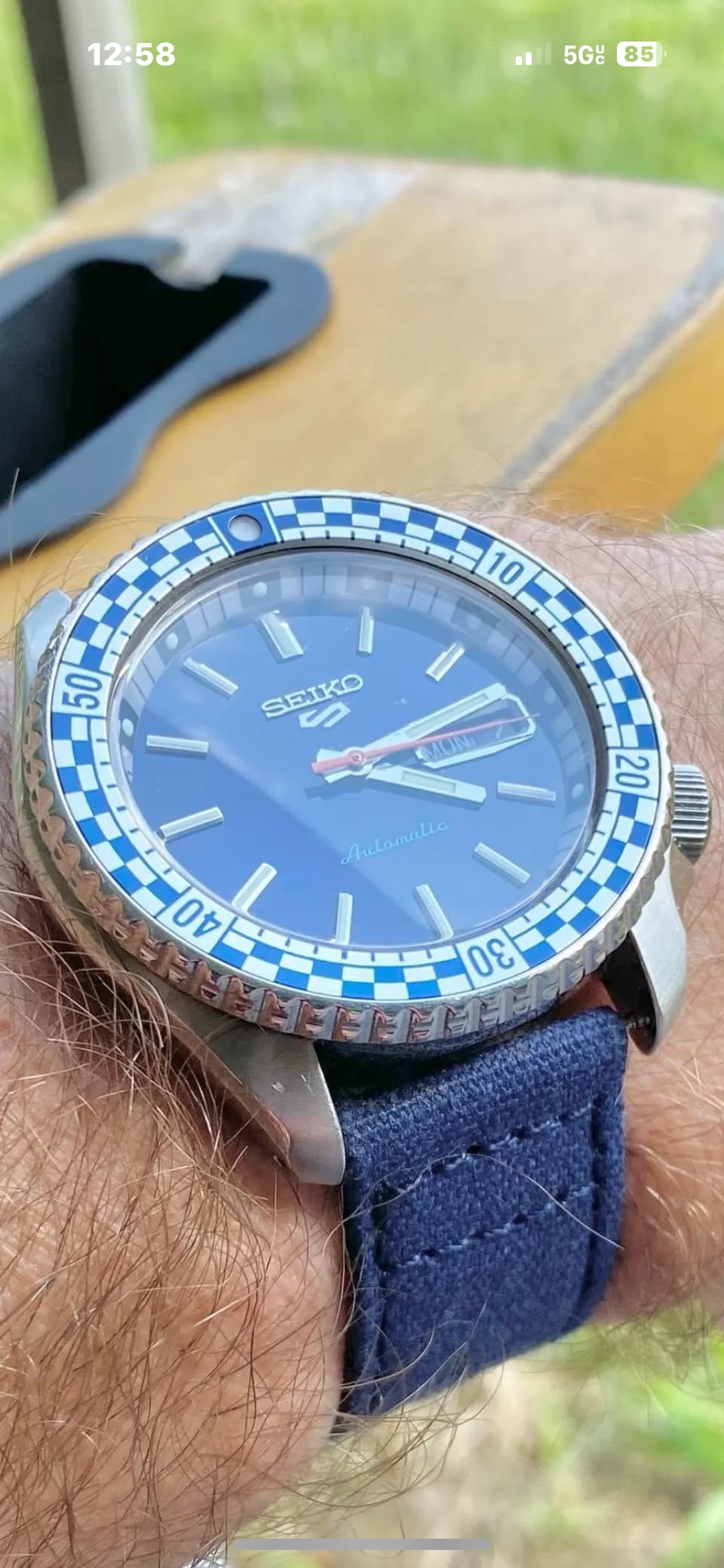

No that won’t work but thanks. This is for a watch.
That helps visualize it!

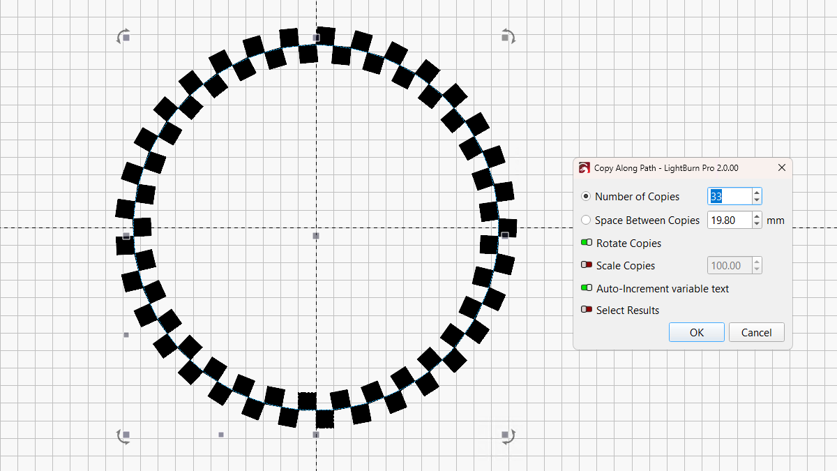

Perhaps Copy Along Path gets closer to the goal:
You’ll want to spend a bit more time figuring the distances & number of copies, but that’s the general idea.

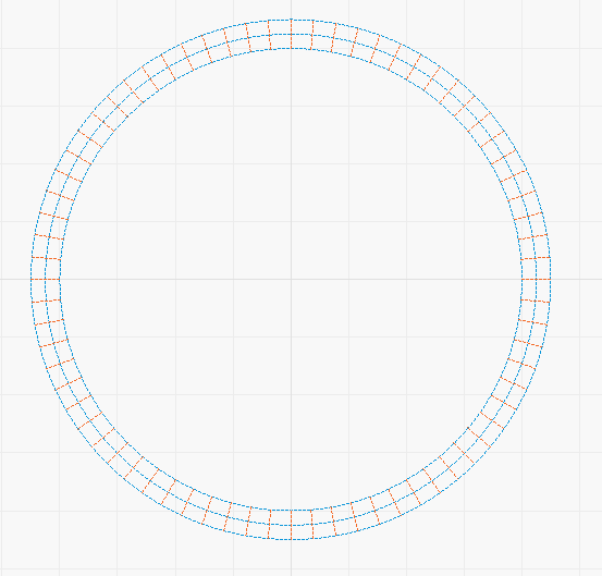

From what you’re describing, it seems like you might do well by drawing yourself a template to build the shapes you’re looking for. Something like this?
To recreate:
  1. Draw three circles (outside of bezel, inside of bezel, middle of bezel)
  2. Draw a line from the center of the circles to the outside. I had mine go straight up and down because it was easy.
  3. Trim the excess line that goes through where the watch dial would be.
  4. Use a circular array (with the center of the circle as the center point) to repeat the line.
From here, you should be able to draw the shape(s) you want and use circular array to repeat them. I’m including a copy of the LB file I created here as well.

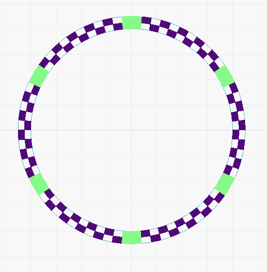

That’s what I finally came up with and in line mode trim what you need to connect everything
