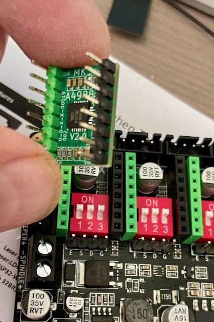

Protip: Pay attention when you plug the modules into the board:
Thanks for the info, the modules are color coded so that helps! :wink:
While colour coding is good, they can still go in backwards!
Eh, how?
Ahh I see what you mean. Physically they can, but that sure makes it unlikely.
FTFY. :grin:
Also, you can still plug the little board with colors matched, offset by a pin like I did, and kill the board.
Memo to self: Next time, double-check!
