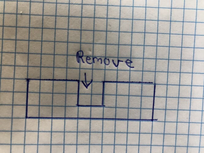

I am about to cut out a RC modelplane i 6 mm black epp, and the cut is dialed in.
My problem is that I want to make a hinge in the wing, by removing 80 to 90 % of the epp within the red lines (not cut through)
How do I do that?

Do i set the red layer as Fill?
For your purpose no, you’d want a line. You’re basically doing an incomplete cut. You’d only want fill if you were trying to engrave some sort of lettering or pattern onto the surface of the material.
Hmmm if I choose line, then it wont remove the material between the red lines or am i wrong?
What I would like to do is to remove 80-90 % of the material in the red area.
Sorry if I am being a pain…
Ah. Ok. Very different. And yes, you probably want to try this with fill.
This changes or at least modified what I said earlier. Certainly will require experimentation. Depending on your need you may need to do this multi-pass to get the surface finish you want. I’ve found these types of operations extremely finnicky to get very precise depths.
I’ve not tried to get such a deep engraving on such a wide area. Give it a go and report back on results.
Also, you may want to experiment with scan angle in the cut settings.
@berainlb - What you write fits in nicely with my experience of “depth engraving”. However, I have only used it for acrylic. Here it is important to evaporate and not to melt the material. Depending on how deep it gets, it requires many passes because only relatively little energy can be used. I like to use crosshatch 45 degree for that with a single turn line for sharpening the edges at the end. For the first part of the task I use a relatively large line spacing but for the last mm approx. 0.1mm. That said, the most important thing, in my opinion, is to avoid melting the acrylic, how it works with EPP I can unfortunately not say.
I suspect it will be similar but even more sensitive to melting. This will depend much on how precise @Highboy’s needs are. He may be able to tolerate more melting for this application than you would otherwise want for a normal engraving.
In my experimentation with lettering on XPS it was extremely difficult to control a consistent depth of cut due to melting. Even if it was fine for the middle sections the starting areas would be inconsistent I assume due to acceleration. I’m confident that with enough tinkering this could get dialed in fairy well. This is one of those situations where a lower power laser might be at an advantage.
