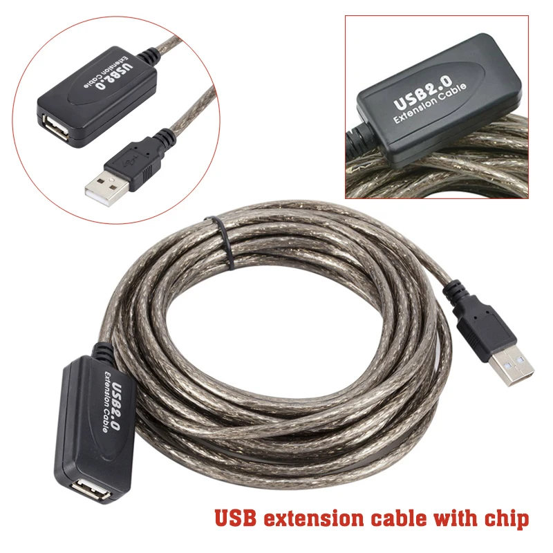

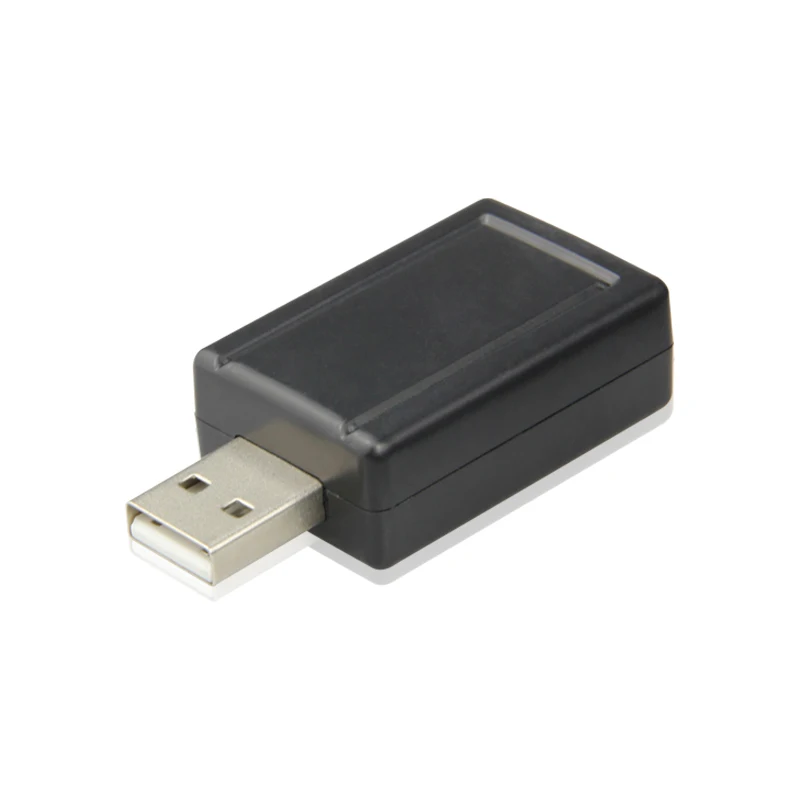

I had the same problems with long USB-cables, in my case it was a camera.
I solved it with the use of a USB amplifier, link below.
You can also get them also as a complete cable in different lengths up to 20m.
Link as an example for a 10 meter.
