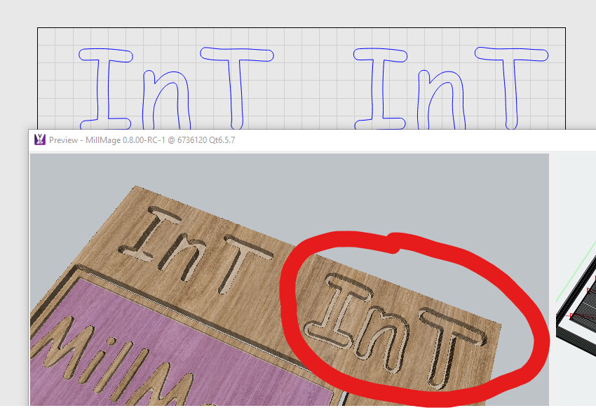

When doing the male plug of the inlay, what is the best way to have it clear out an area around the selected letters so don’t have to cut each letter out?
When that tool was designed, the intent was that it would be a profile that cut the parts out. It works, but we are rethinking the workflow now based on lots of these questions, haha.
I have been doing it by adding a square around the shapes and doing a pocket operation with .25-.5mm “stock to leave” set, and running the male inlay op immediately after.
Thank you for the details that makes sense.
