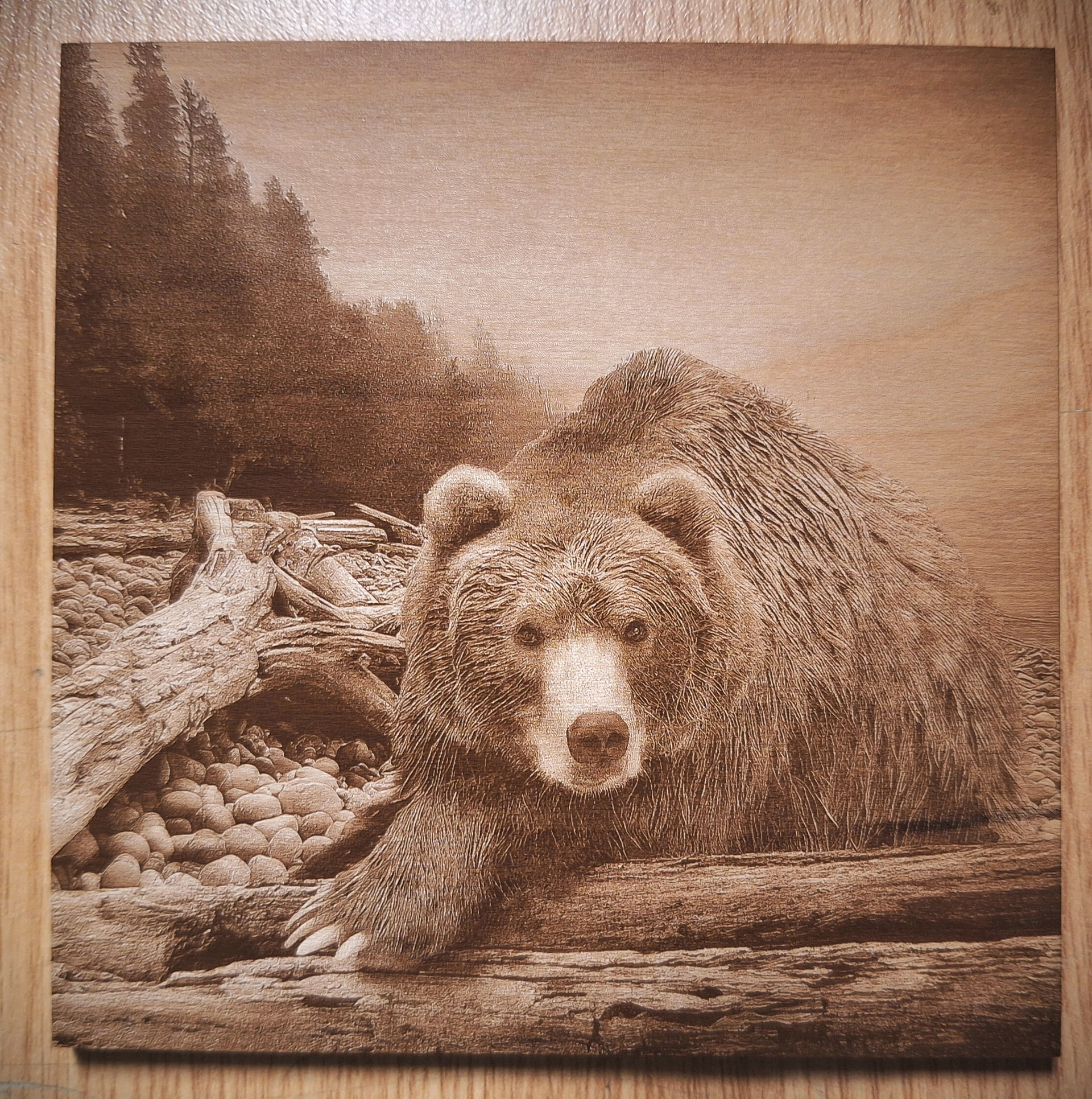

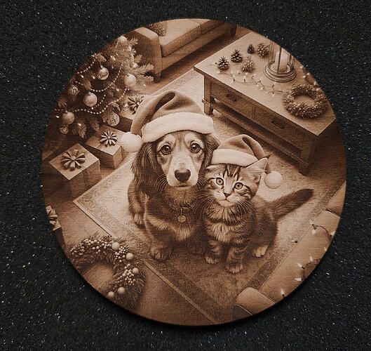

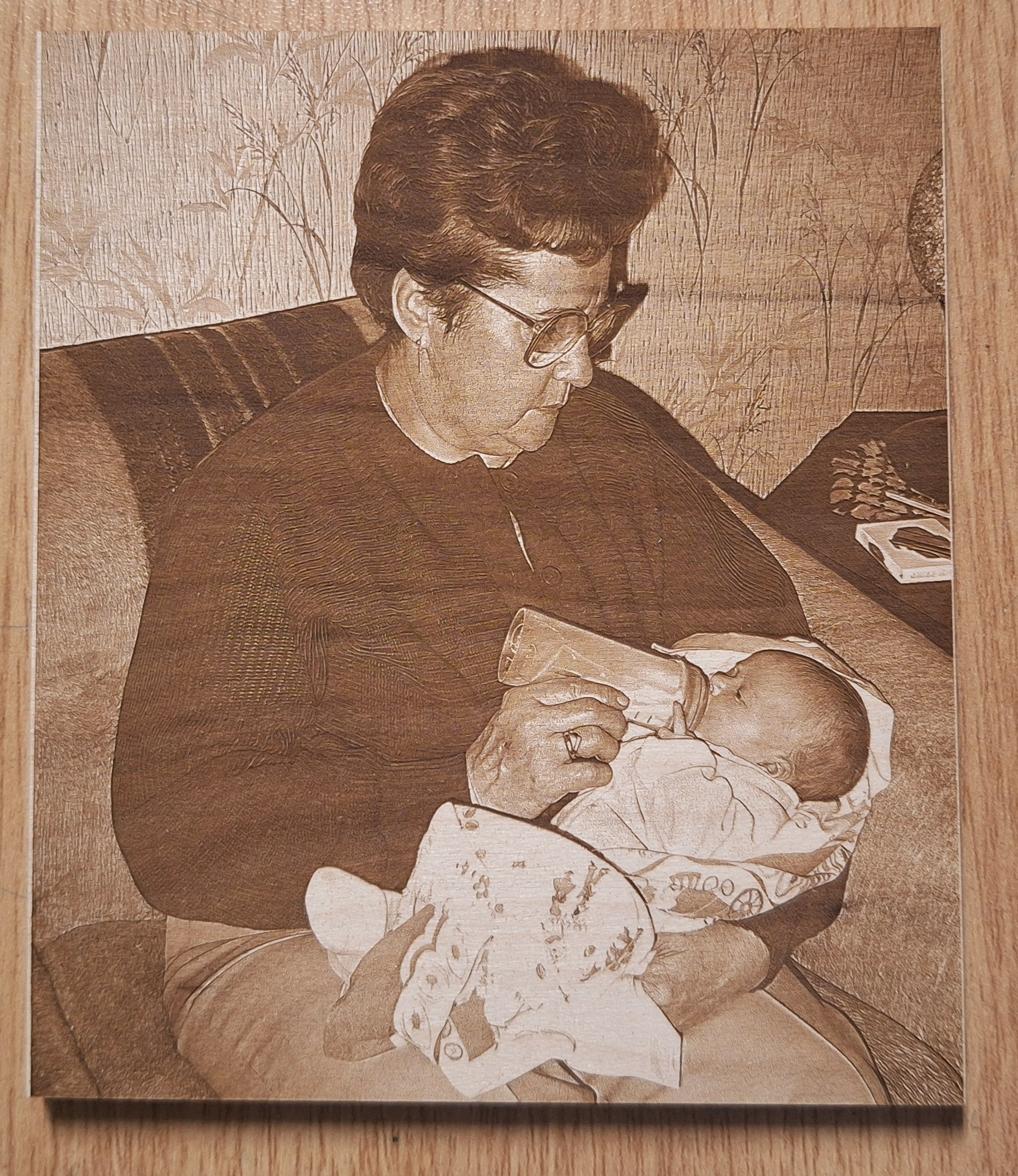

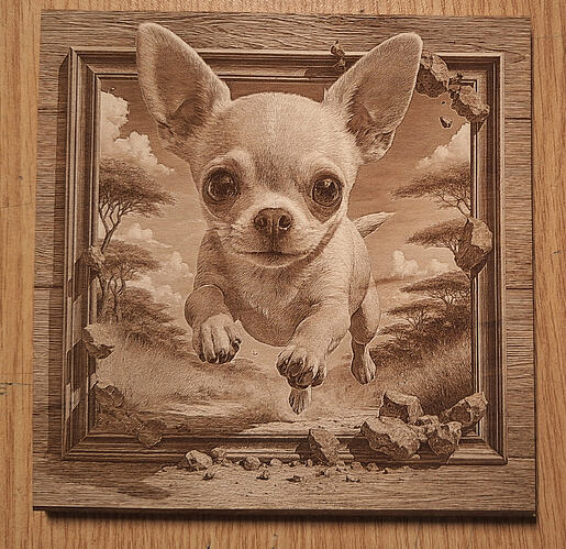

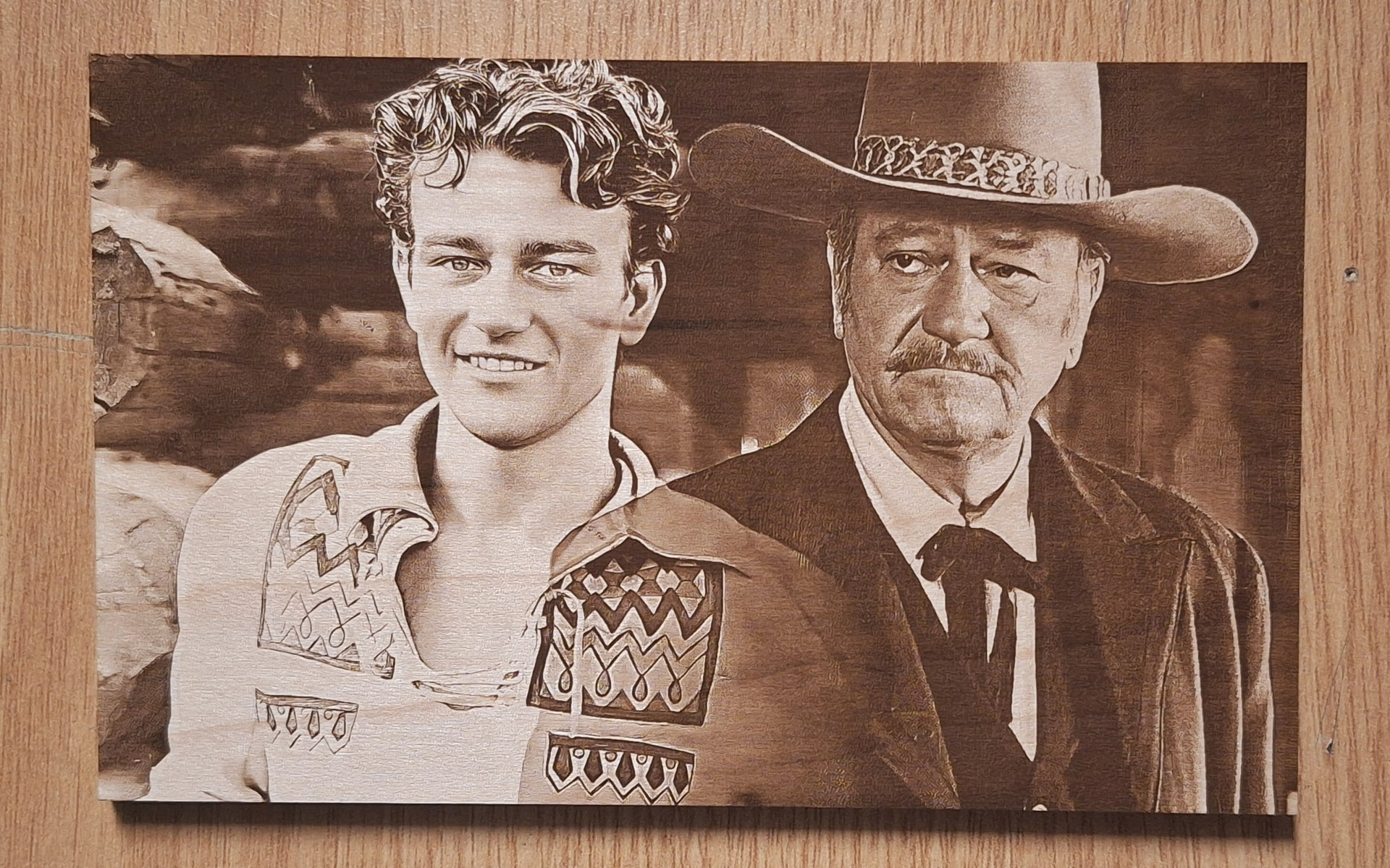

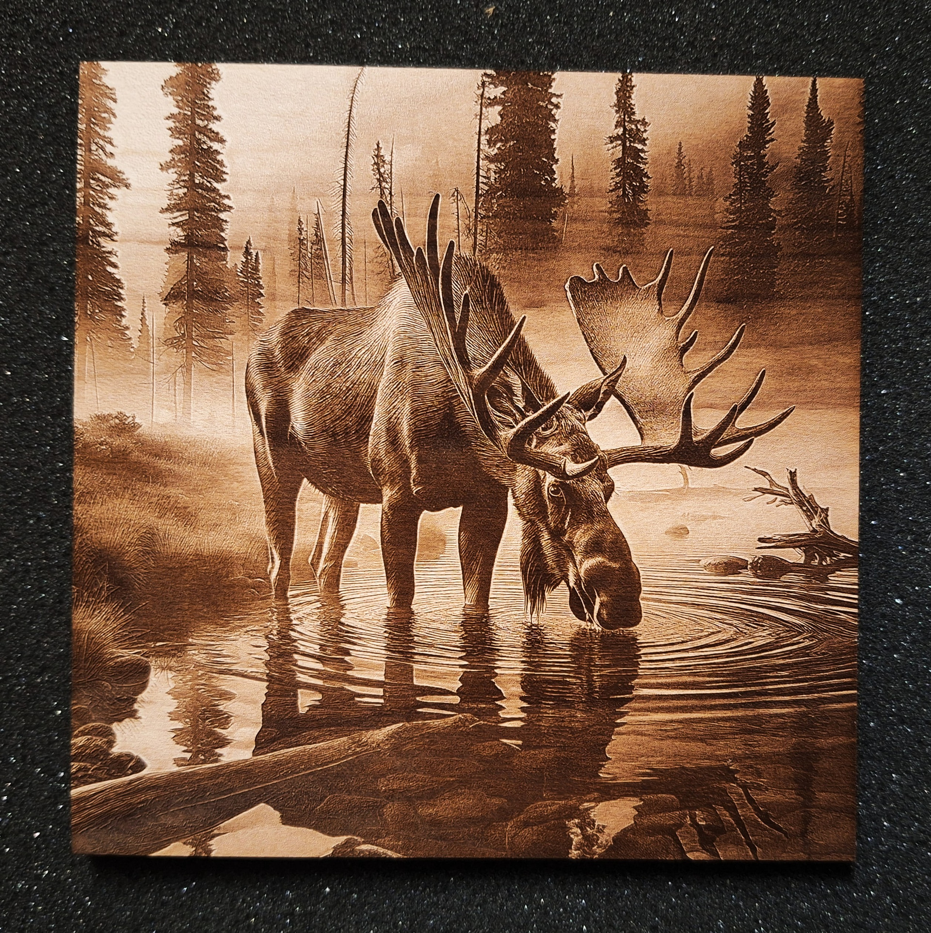

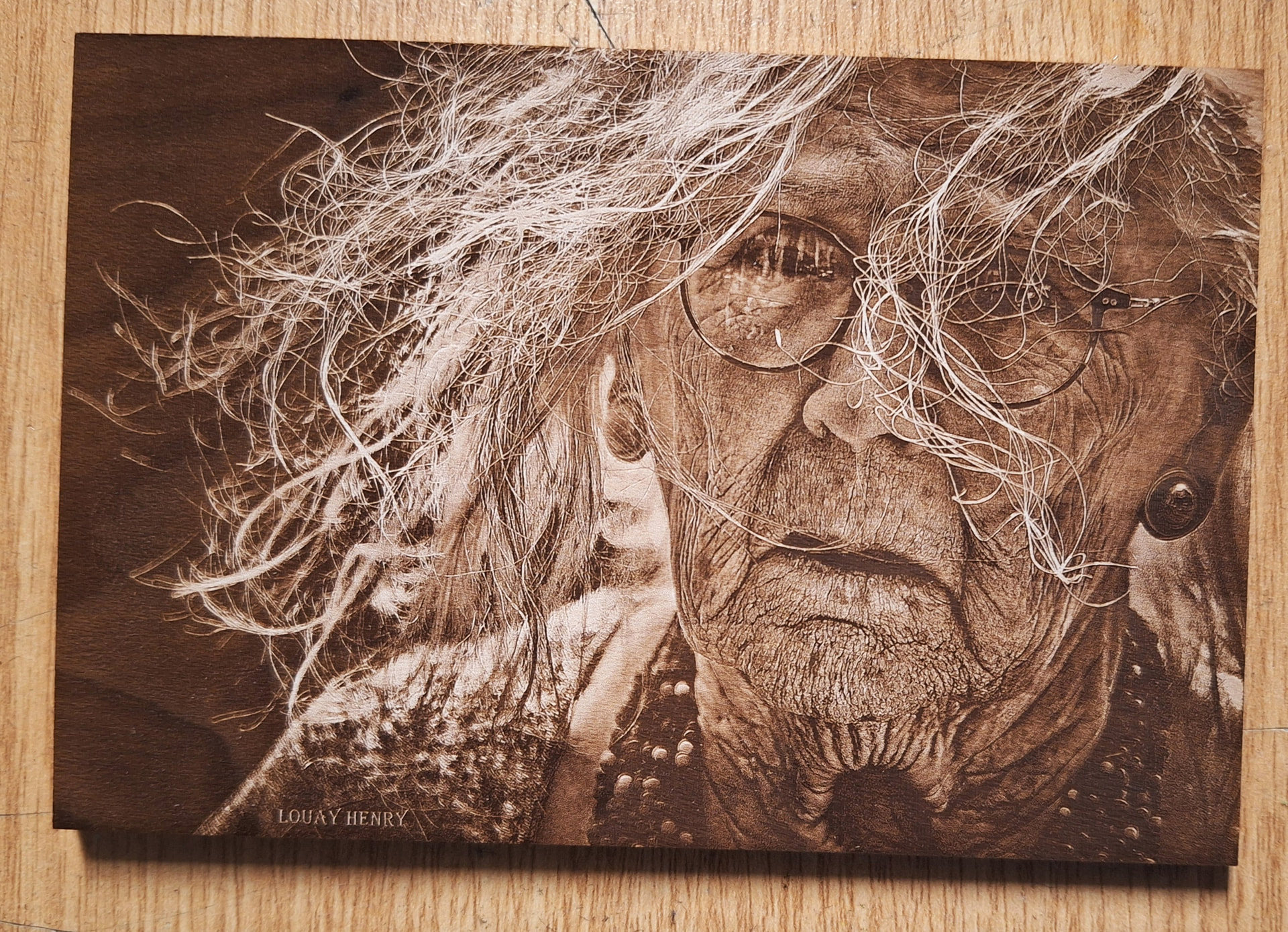

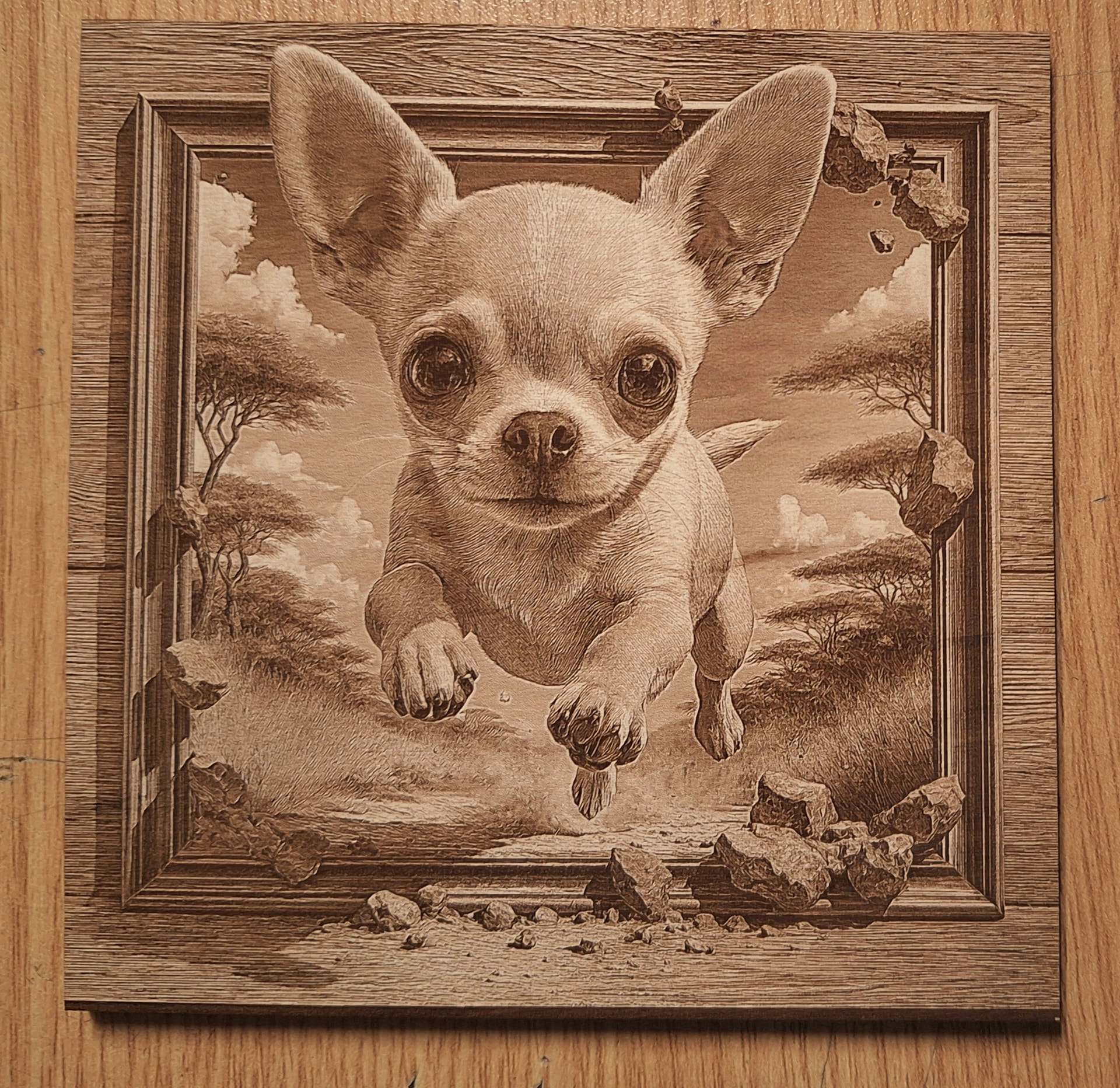

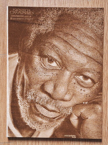

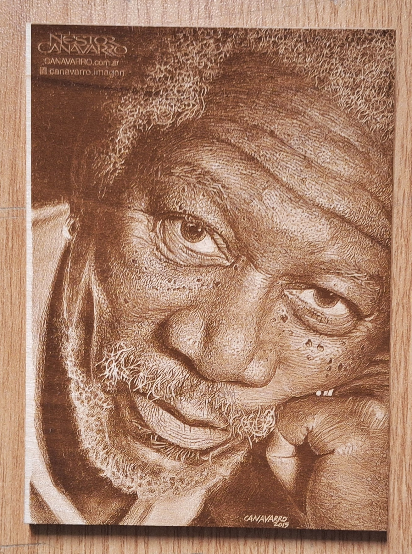

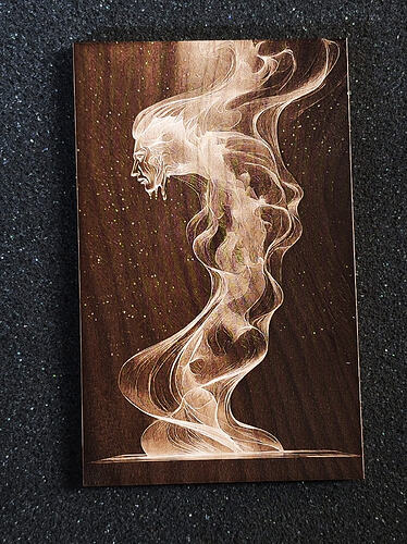

Maple Plywood engravings with 5 watt Uv
Dialing in settings
Maple plywood
5 watt UV F330 lens
85/45/4 ns
LightBurn 410 DPI stucki dither
All really nice to look at and especially liked the dither on Morgan F, the texture on the santa hats and the water around the moose…and also the knitting on the right arm of cardigan worn by the lady.
All fascinating but the “Louay Henry” hair contrast is absolutely fabulous.
