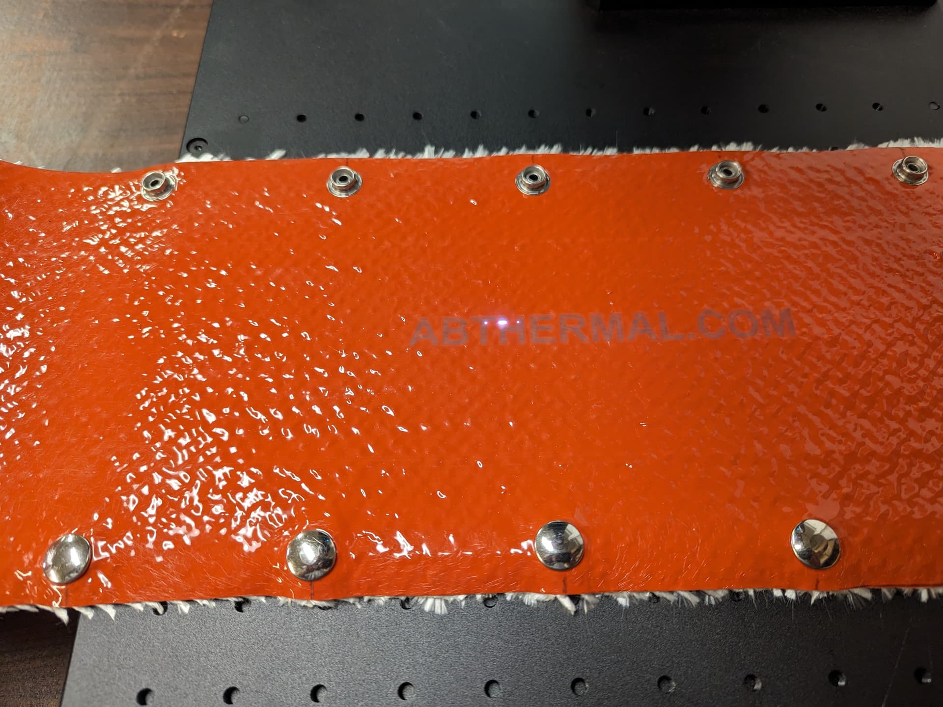

Using a 5w UV commarker - etching on an irregular silicone rubber surface that is an oxide-red color
Results are satisfactory but would like deeper/darker result.
Current settings are Speed = 90mm/s / Pass = 7 / interval = 0.1mm / q-pulse = 175 / frequency = 30khz
Any recommended changes?
