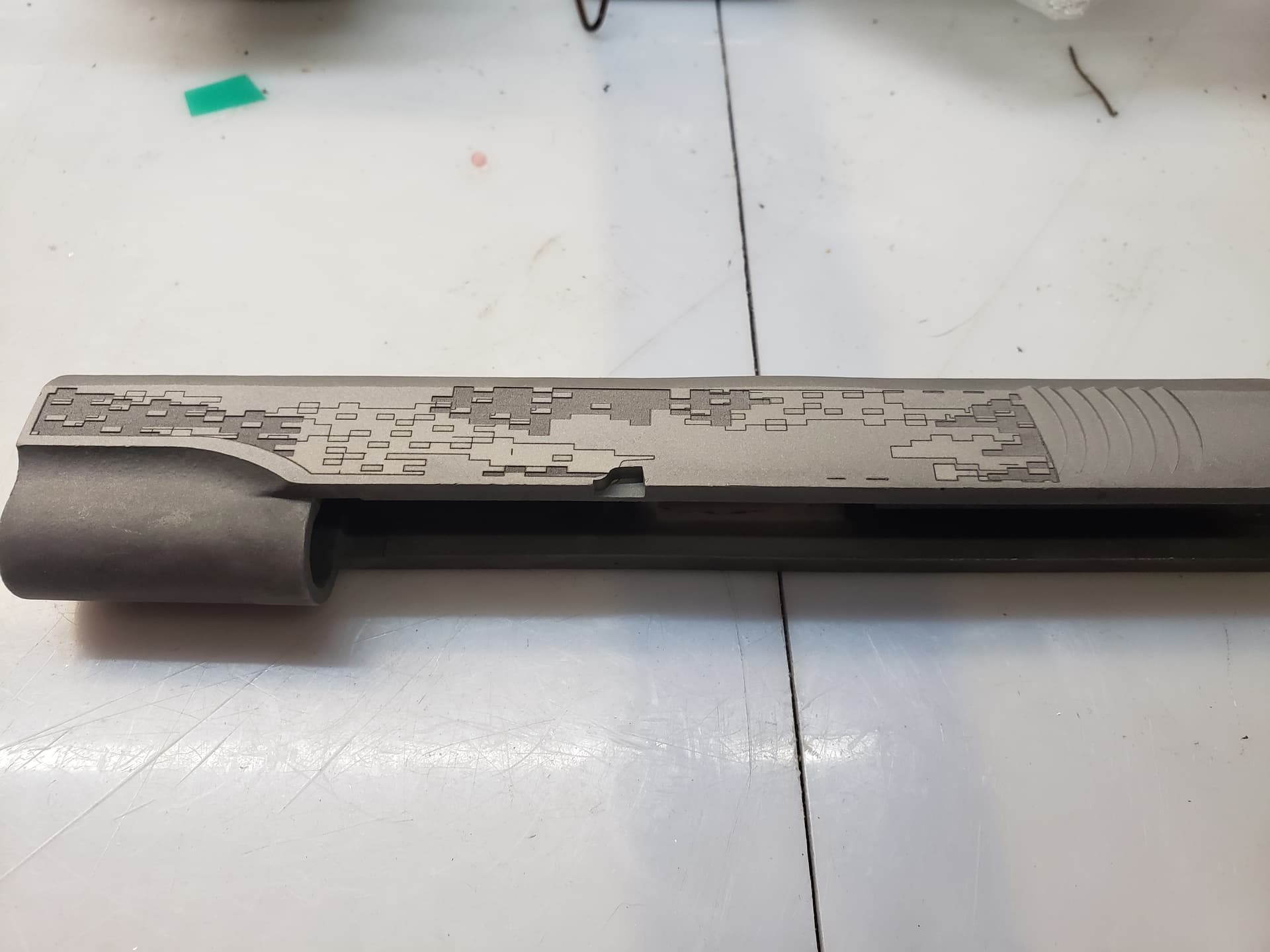

Do you have a few slides laying around to set this up as far as settings go? Looks kind of digital…
I do like it.
Downloaded a camo pack from etsy. Try a few more styles before I apply to a functioning piece, but the digital does look good.
Looks nice!
