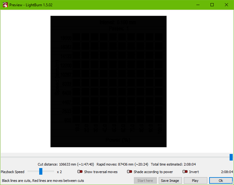

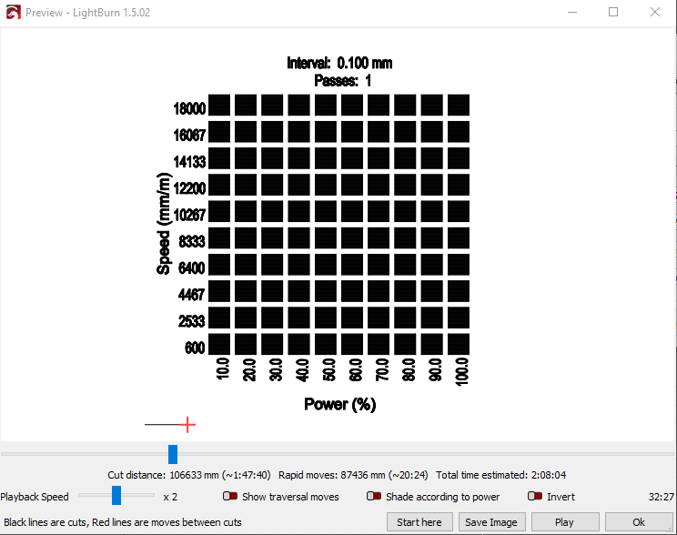

Hello everyone, sorry if I missed this issue, but I have been googling and reading these forums for a day and a half now.
Using 1.5.01, and now using 1.5.02, when I click the Laser Tools >> Material Test, the dialog box appears, and even without changing anything, when I Preview the lase, it always goes for 2+ hours.

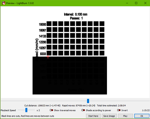

The problem is that the test completes around ~30 minutes, however, after the last box is lased, the head moves to the bottom left corner and then Fills the entire Framed area.
Please, what am I missing? :thinking:
In the material test window click edit border settings and change it from fill to line.
Or you could just turn off output in the settings.
FOR THE LOVE OF PETE! :man_facepalming:
Thank you!
** EDIT **
Oh I totally get it now. This is what everyone was asking about for “cutting out” the test at the end. Thanks again Mike!
