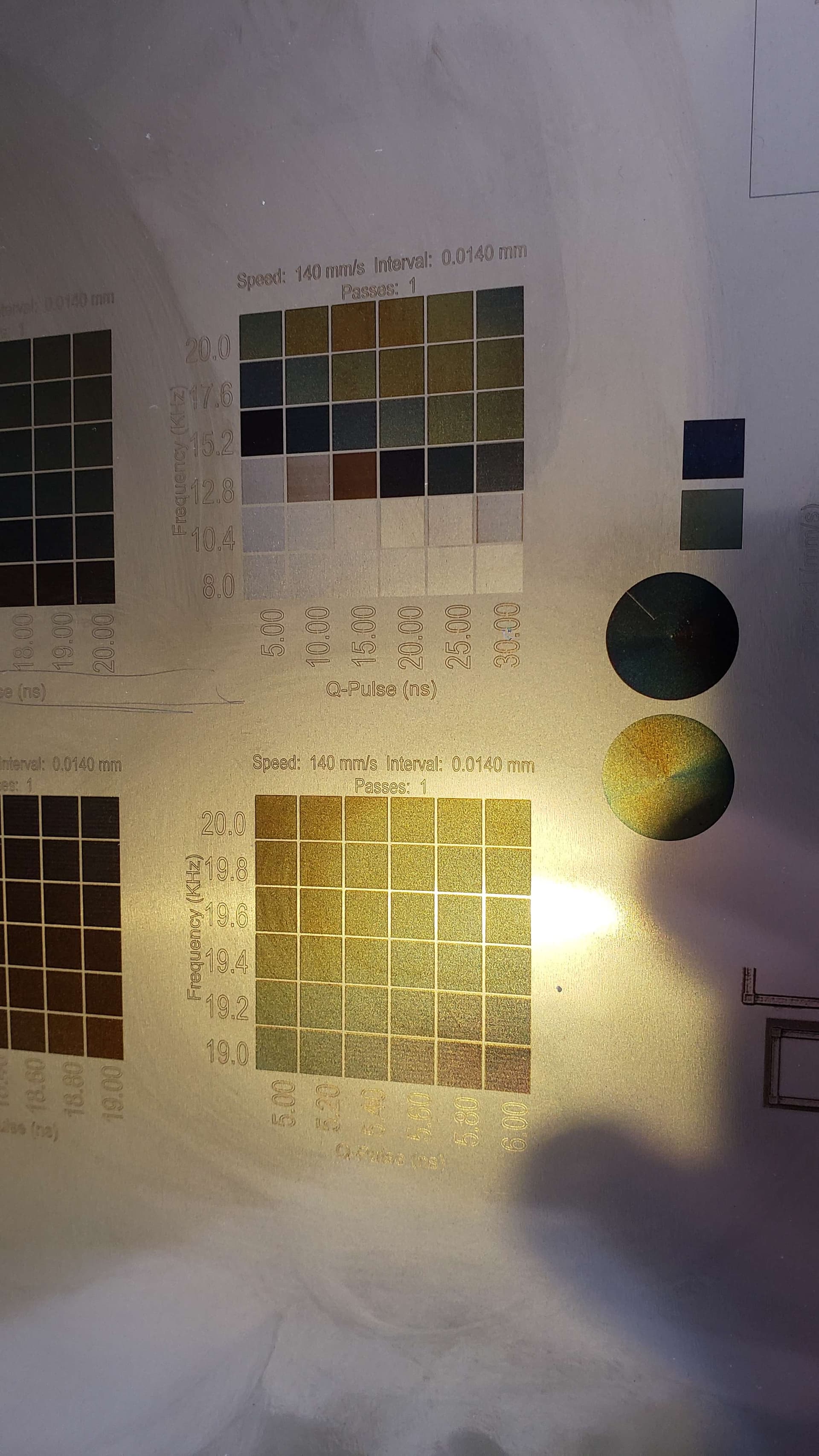

I am running a ComMarker Omni 1 (5 Watt) model and am doing some color marking tests on Stainless Steel surfaces (Polished).

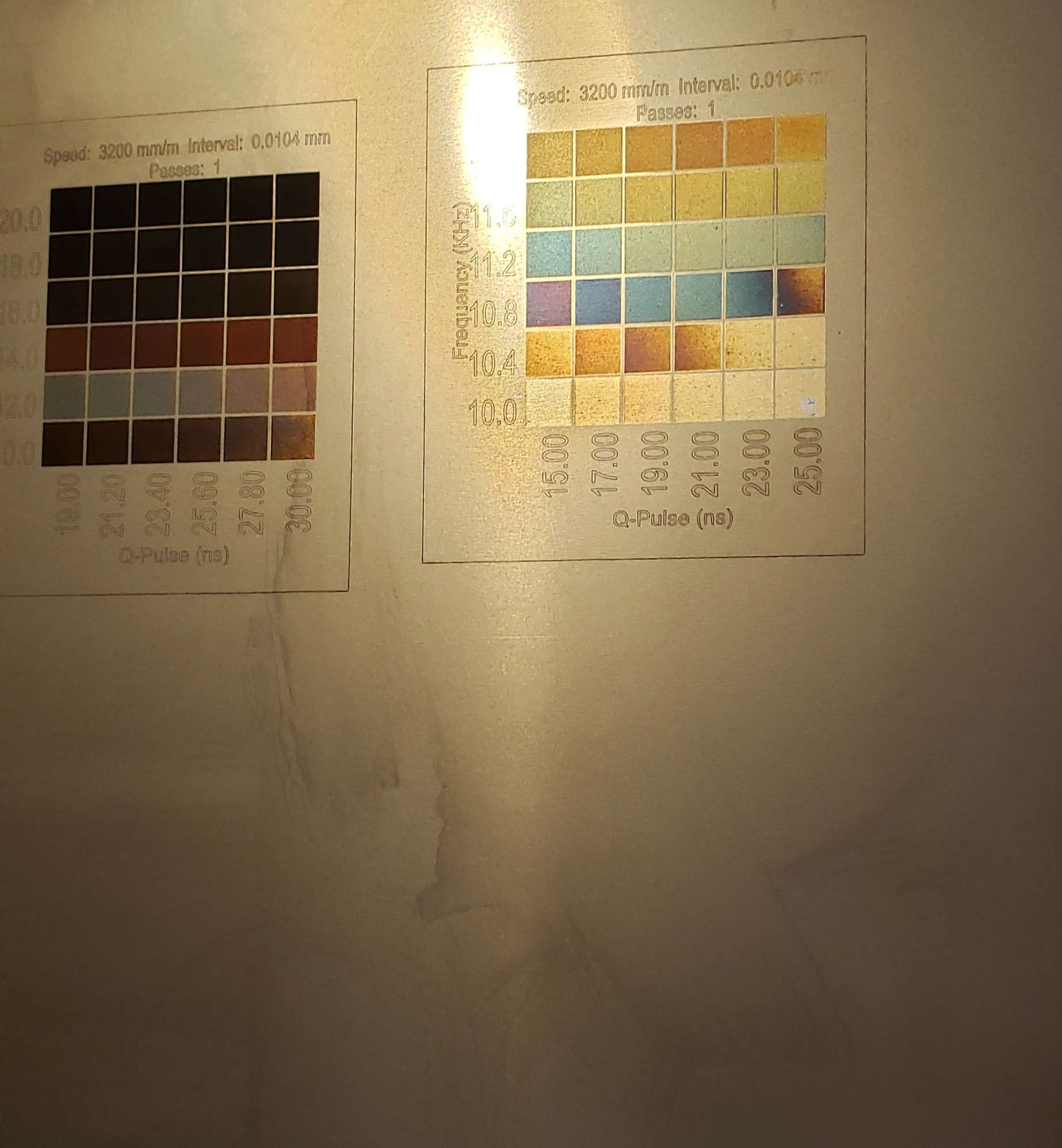

I am using the Material Test Tool in order to get a nice grid. By varying frequency and Q-Pulse i got this wonderful Palette of colors at 3200 mm/min (53mm/s), 0.0104 mm line width (2440dpi) and 1 pass.
You can see the purple-blue bands that i want i want to replicate. These settings keep the surface very shallow and smooth to the touch.

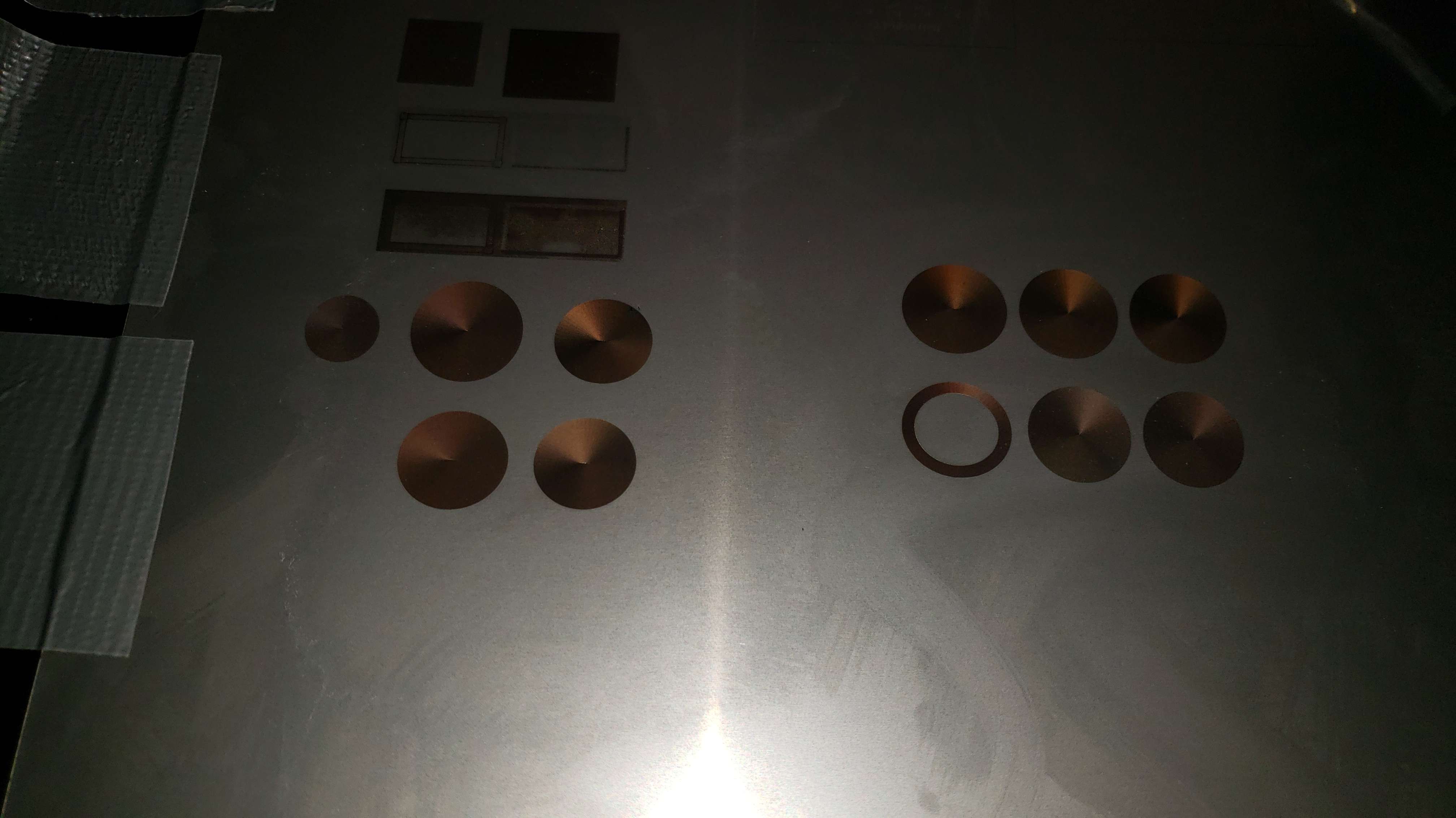

Unfortunately i cannot replicate these colors separately. If i just draw a square and use Fill with the Exact same settings as Material Test, then i only get red-brown shades. (Not best pic but the colors are almost all the same with darker lighter variations of red brown)
For example that Blue hue was 11KHz @ 17ns , 3200mm/min, 0.0104mm, 1 pass in the Material Test
But for the actual Test with the exact same settings it remains dark brown. And the other dark brown circles are actually supposed to be the other colors, but they are all dark brown.

I do not have a fiber machine, but I can do the same with a diode laser. You have two tests in the first image. In the second image, you are expecting the same results as you got in Image 1 right side. Yet your burn pattern is entirely different if I am seeing it right. It appears the circles were done with Offset Fill, but the squares were Fill (a raster scan). The heating of the stainless will not be the same.
Speaking of heating, There is a very fine line between the anneal colors with stainless. You are coloring it by basically heat treating the metal. How much you put in an area in a given time impacts how hot you get the stainless in that area. Not only do power and pulse rate make a difference, but also how much area your trying to heat and the path used to heat it. Stainless is a poor conductor of heat, but it does conduct. Even the ambient temperature will affect your results.

I actually fixed it. You indeed cannot really touch power settings but the problem was with speed.
For some reason the Materials Test was taking my speed incorrectly so i changed it to the device settings in mm/s as default and it was going smoothly. I managed to get colors for both a straight raster and offset fill. Very accurate to each other. Both Blue and Lilac

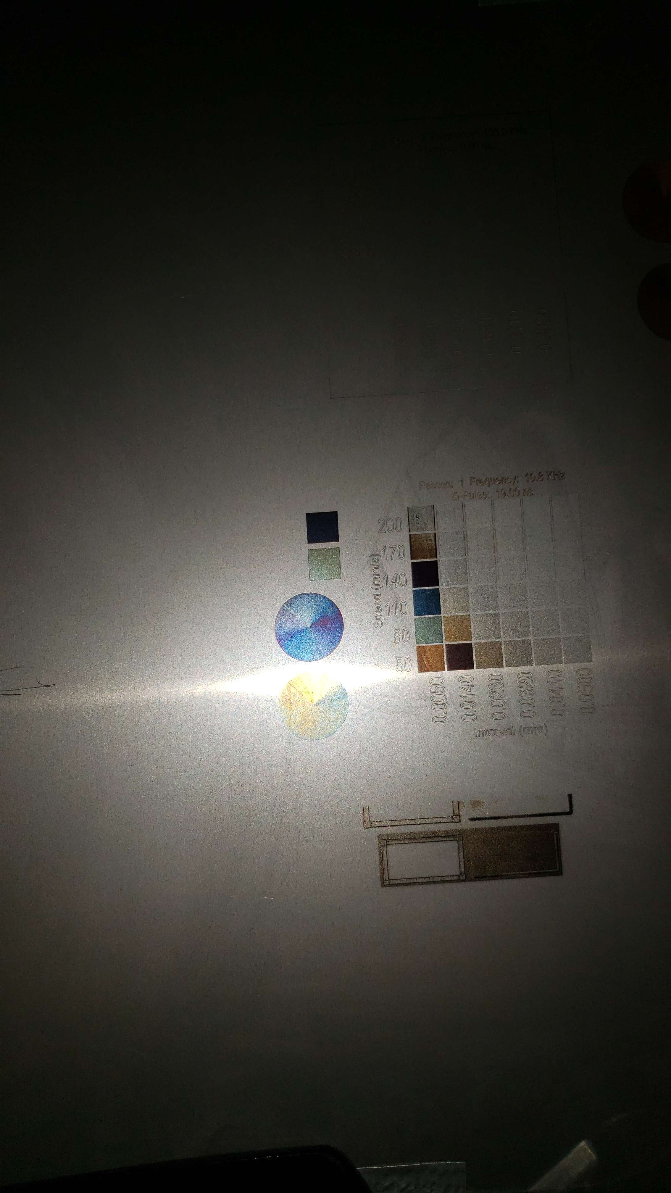

For reference above those 2 circles are 110 and 80 mm/s at 0.005 mm line width. The 80 mm/s variant (light blue) started glaring a bit brown on the left side of the circle.
Atm am trying to keep the place very dry at 10 degrees celcius. The 0.4mm polished steel sheet has been tensioned on the engrave board as to have very minimal surface bumps. Also well cleaned with IPA at regular intervals.
I found that when engraving with some of these settings red oxide powder forms at the edges and can remain deposited on second passes. Becomes impossible to get off. Which is why i am trying to achieve these in 1 pass/constant speed.

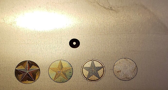

This is my fav palette that i have produced thus far. Very intricate colors in the 19-20 KHz @ 5-6ns range.
Even tho the photo may not be the best, it really looks like a continuous stable flow of colors.
I cannot wait to do some tests today with lightly dithering an image over a colored surface
edit: star designs with the above palettes for my custom cards

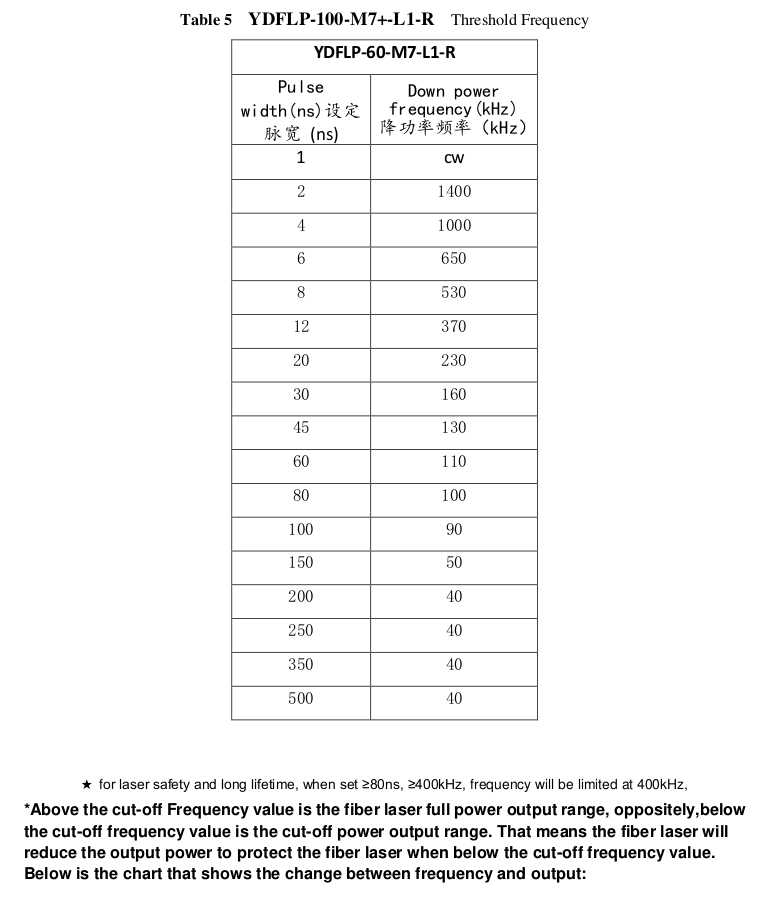

I believe these operate very similar to a fiber.
Fiber lasers take time to pump up the fiber. If your q-pulse is longer, the machine can’t pump the fiber up to the same level of energy. You get the most power out when the fiber is fully pumped and you allow it do discharge completely. The longer the q-pulse the more drain of the fibers energy.
I don’t know about your source, but mine has specific limits (threshold frequency) where for certain q-pulse widths related to frequency where you get full power. Longer q-pulse the lower the frequency threshold.
If you double your q-pulse width and the frequency is too high, it won’t produce the same amount of power.
Hope this makes sense.
