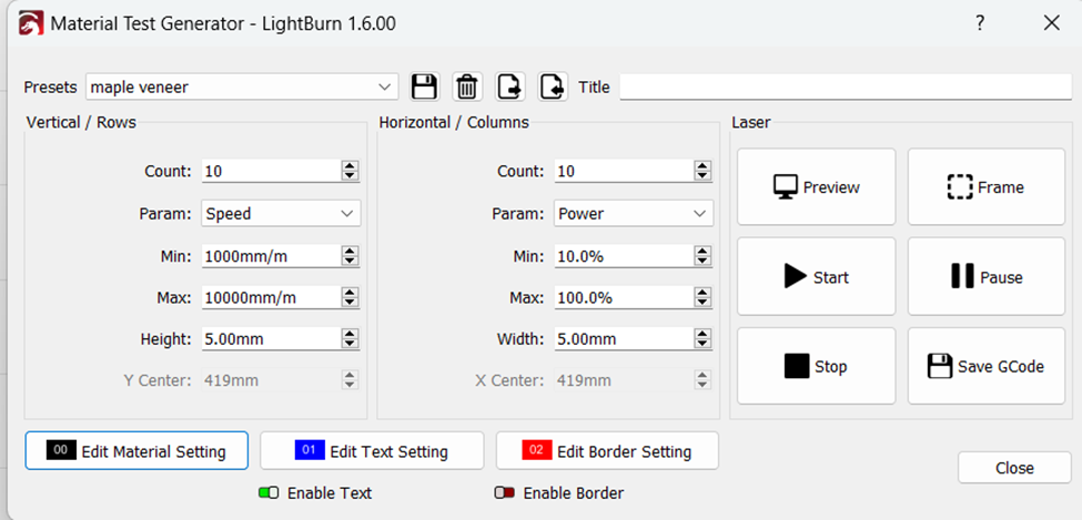

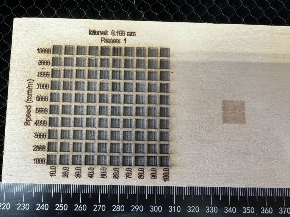

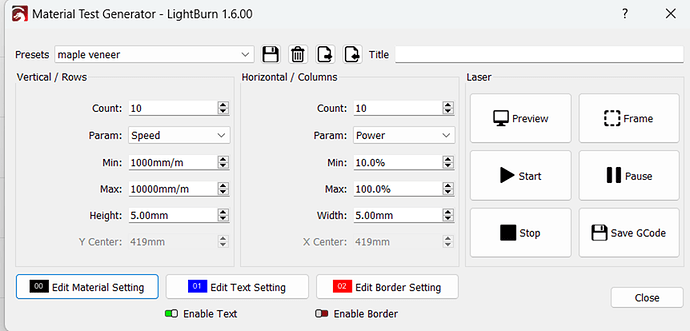

Material test is no longer working as expected. I am no longer getting a gradient when I run the test. The legend text looks weird as well. Lightburn version 1.6.00, built Tue 2024-04-30 @ 02:35.
The square at on the right was burned with the minimum 1000mm/sec and 10% power so it should match the lower left square in the material test.

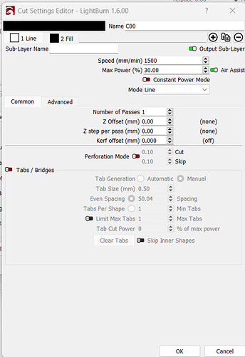

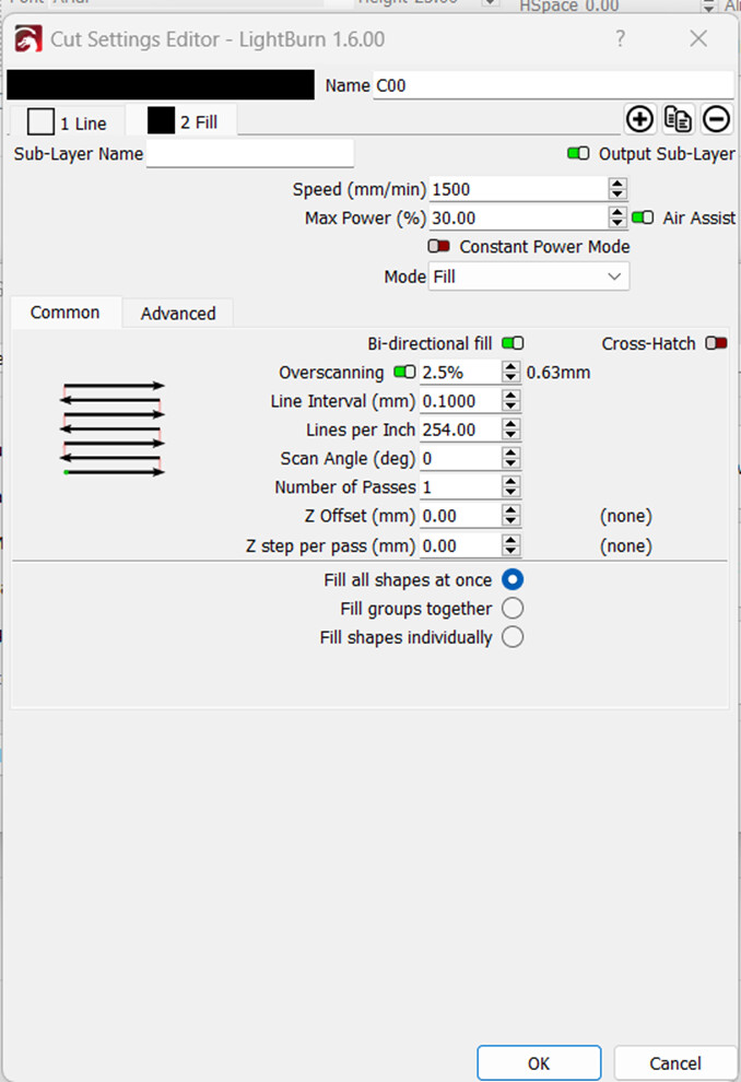

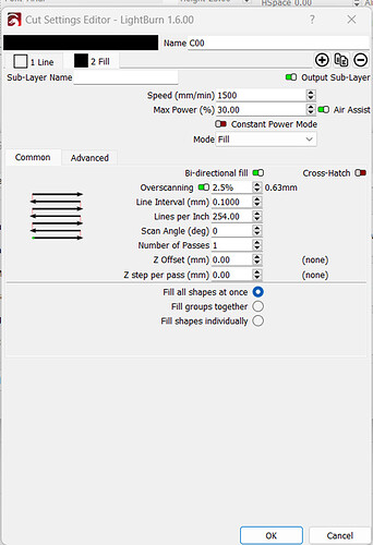

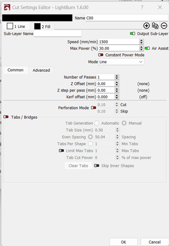

Here are the lightburn settings
You’ve indicated units of mm/s here but everything in your settings indicate you’re working with mm/min. If you use the same value of 1000 for both that would make the mm/min 60 times slower than mm/s if that’s what you’re expecting.
Change this in Edit->Settings.
Oh boy, I was wrong in my description. Everything is in mm/min
It’s in mm/min, but are you assuming mm/s? 1000 mm/min would be quite slow for an engraving on most CO2 lasers. Typically CO2 lasers are configured to work with mm/s units.
