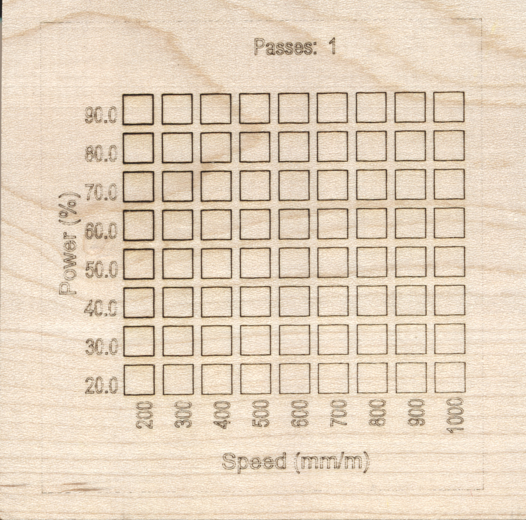

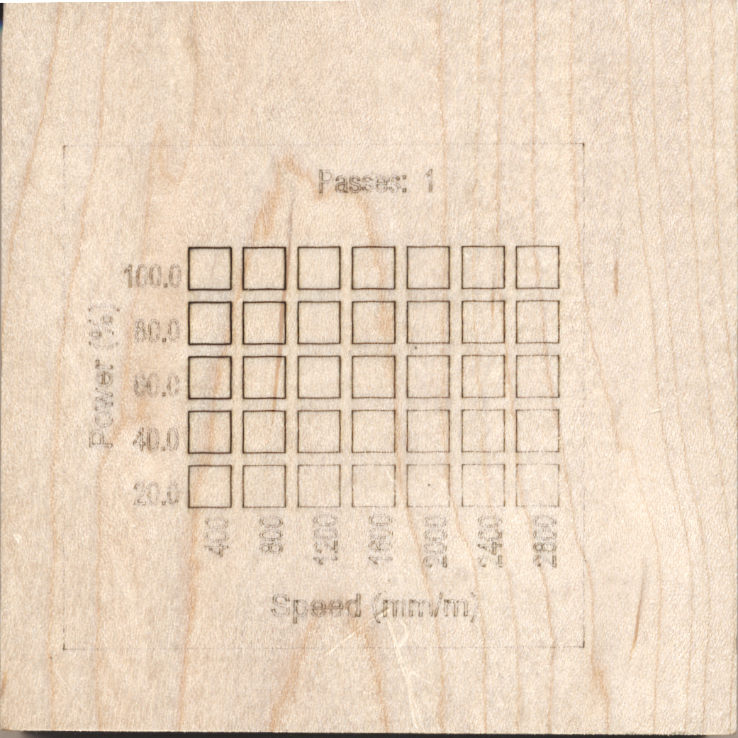

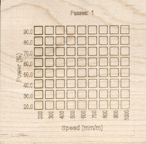

I set up a material test and the result shows very little changes between settings, it looks fairly uniform. I expected to see a range of dark squares to light squares. I’m trying to decide what range of settings I might try next. I have the Sainsmart 3018 PROVer with a 5.5W laser.
In the Test Dialog, click edit aterial Setting and change from line to fill. That will give you engraving of the squares, the way it;s set it is only running the outline of the squares. The test you ran would be for cutting and with a 5 watt laser you will need t oslow down consideraby and probably run multiple passes in order to cut.

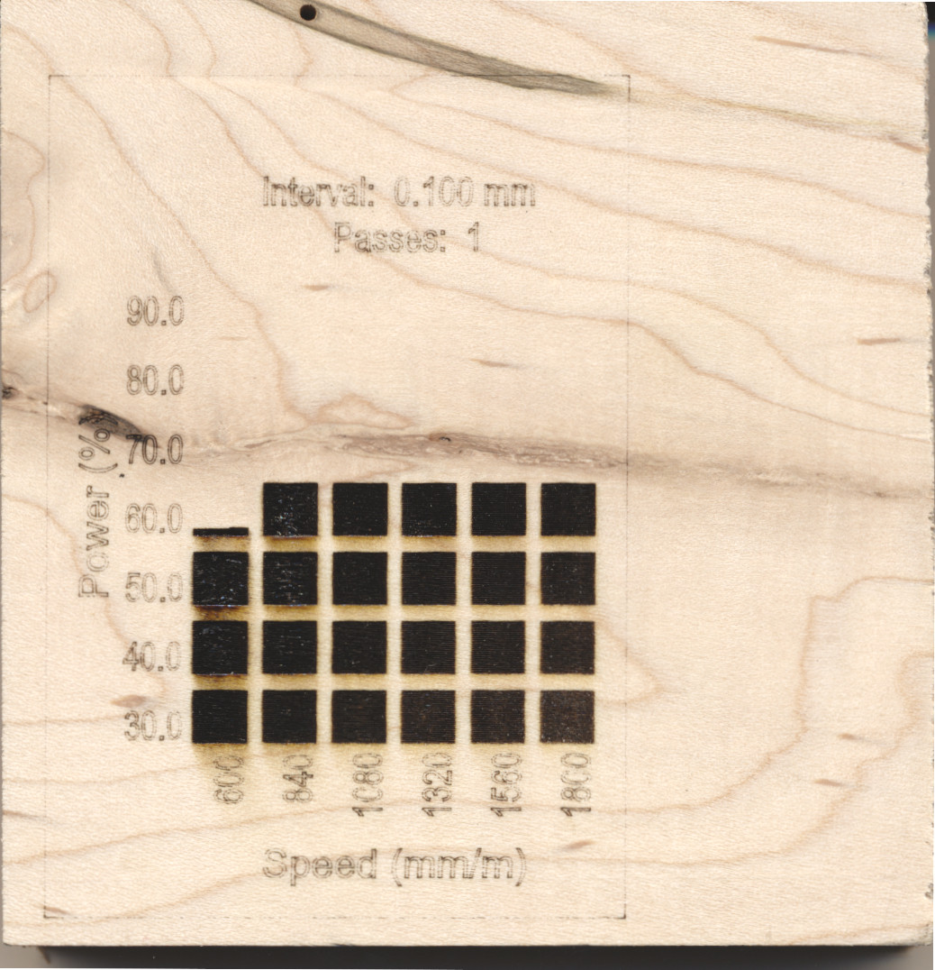

I changed my setting to fill and I discovered the lowest power setting and the highest speed was filling the square dark. I increased the top speed from 1000 mm/m to 1800 mm/m and decided to increase the steps between samples. I still got fairly uniform output. I wonder if there are other settings I should check.

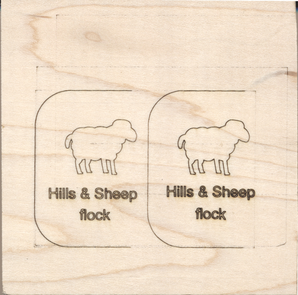

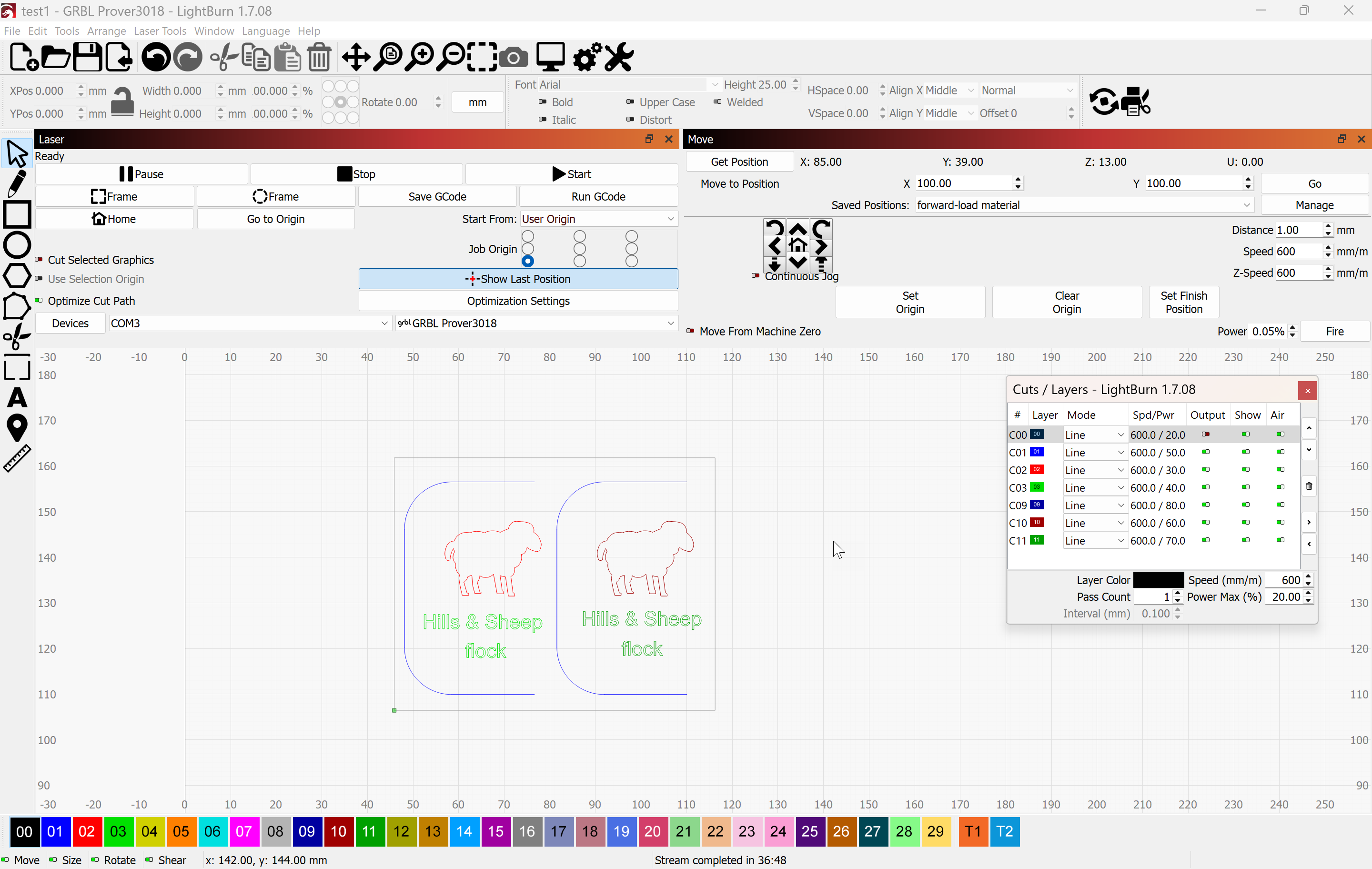

I decided to try an example of a graphic from my project. I set the speed at 600 mm/m and varied the power (20%-80%) for all of the outlines, icons, and text. I can see slight variations. I can also see the 1% power outline of the Frame function.

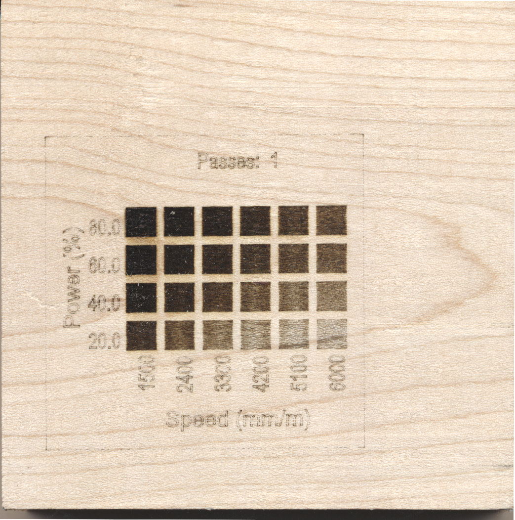

Try running at higher speeds for engrave. Run 1500 - 6000 and see what you get. If still no difference, do the following. In the console window type $$ then hit enter. Copy/Paste the entire output here and post a screenshot (not a cell phone pic) of your entire Lightburn screen with a project loaded and the Cuts/Layers Panel and Laser Panel visible. Also post a screenshot of the Settings Window (Gears icon) with the Units and Grids tab visible and post a screenshot of the Device Settings Window (Wrench and Screwdriver icon).
Thanks, I plan to try a higher speed setting range for my next test. I read my machine is capable of 2250 mm/m based on the $100 parameter which is 800 steps per mm. My next test will exceed that. I’ll be testing power/feedrate settings with my test graphic since that is what my project is.
I finally got some variation. I went with large steps, 20 - 80% power and 1500 - 6000 mm/m. I set the fire button to .05% and it is still visible (I’ll probably disable it during framing).

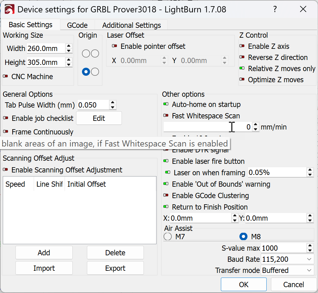

Device Settings:

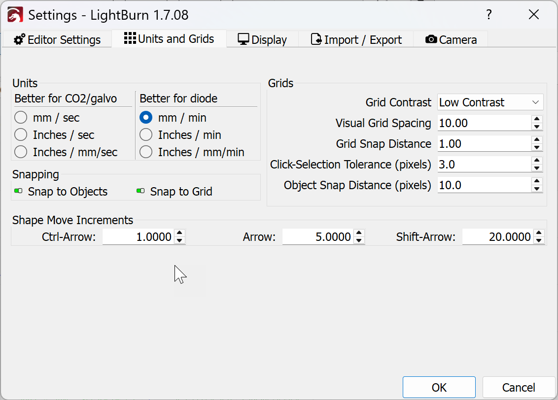

Settings-Units:
Lightburn screenshot of a test graphic I’m using:

I looked at your console output and several of your settings look wrong to me. Your steps per mm is 800, typically I see values of 80 or 100, your max speed is set to 2,000 mm/min, your acceleration is set to 10, mine is 1,000, and your bed size doesn’t match what you have set in Lightburn. If this is a CNC with a laser attachment, I believe some of the values will be different than my diode, but I think several of your settings are wrong.

My machine is the 3018 PROVer but I had installed an expansion kit that changed the work envelope to 300 x 400 mm, I have limit switches so I tested the exact work envelope dimensions using the display from one of the controllers I’ve used, the dimensions are 263 x 307 mm which I rounded down to 260 x 305. I think the console parameters came from a generic GRBL file; I think I got it during my Lightburn installation years ago and I don’t recall seeing a selection for my machine.

I ran another line test. I set 20-100% power and 400-2800 mm/m. I noticed the first 2 columns show different densities than the first test picture with similar settings. Movement distance is accurate.
