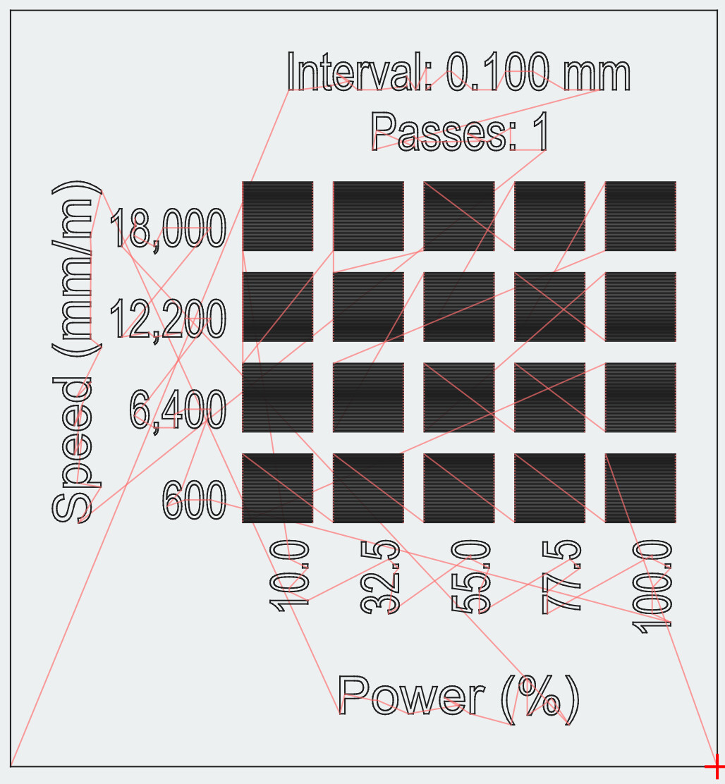

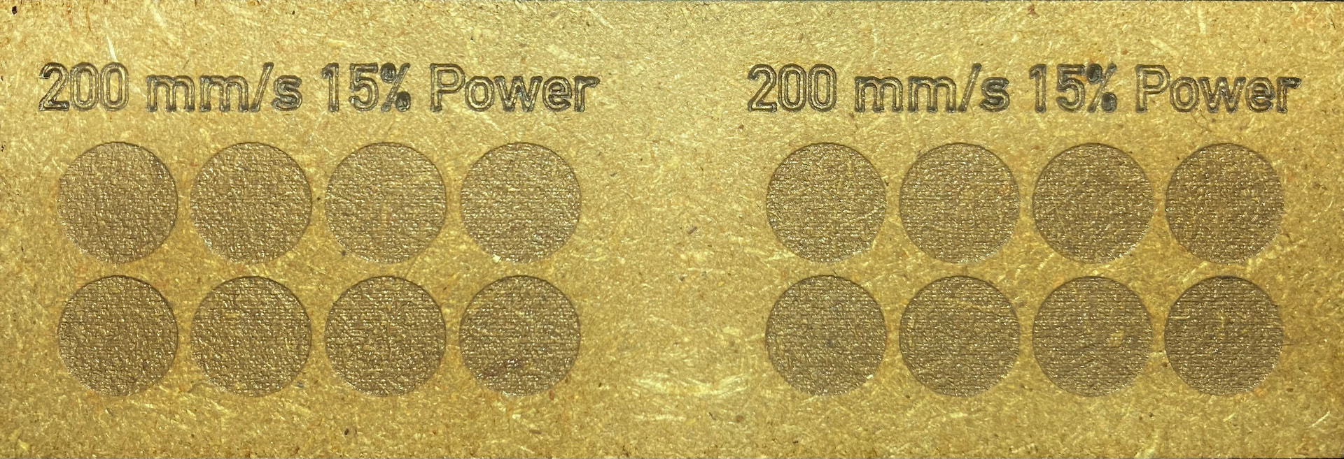

It is possible that this affects some machines more than others. But as I tried to explain/show before, there should be no optical difference between AaO or individual engraving.
Try looking at this picture and tell me if you can clearly see the difference between the 2 examples?
(ignore the writing, too much power has been used)

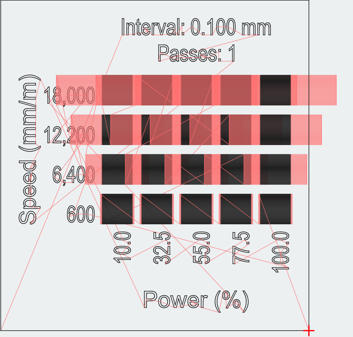

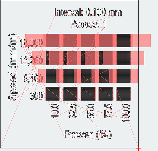

I absolutely agree that the laser cannot get to higher speeds on the material test when using line mode. In fill mode though there is the overscan setting, which you can change to allow the laser to reach speed before firing. Look at the traversal lines in the previews below. This is with no overscan. No traversal lines extending beyond the test square. Impossible ofr the laser to reach speed.

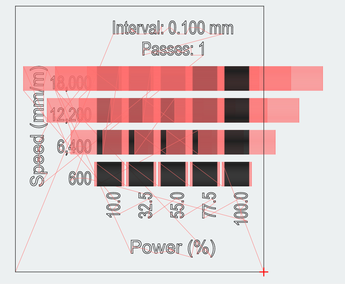

This is with 2.5% overscan. The laser probably will reach speed.
This is 5% overscan. The laser most certainly has enough room to reach speed here.
Notice how much farther the laser travels beyond the test square as overscan is increased. This allows the laser to reach speed and you have control over the amount.
