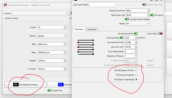

I am running the newest version of lightburn on grbl 1f I believe on my cnc controller.
I am trying to do a material test and it refuses to fill all shapes at once.
Under the optimization setting, in the laser window, I’ve insured “ order by group” is not listed but “ order by layer” is listed. I’ve even tried not listing anything.
I’ve made sure my $30 was the same as the s-value and I’ve insured my speed was in the horizontal column.
The only thing I haven’t done is to make sure all the squares are on the same layer but I would think that should be automatic considering it is a material test that is generated and I don’t see a way to make that all in the same layer. If it isn’t, it should be as it is auto generated.

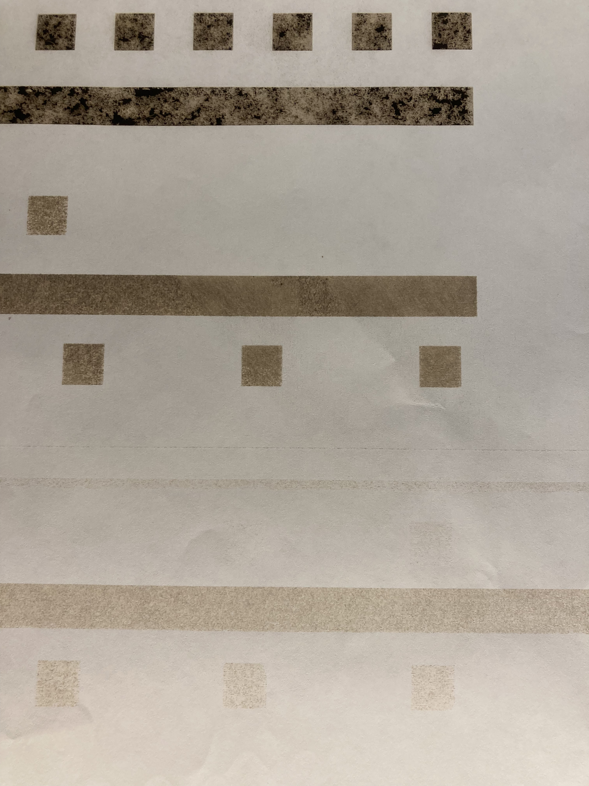

Try doing this test, set it to single engraving and the speed you want to compare with.
(test done on paper to make it more visible)
If you pay attention to my test, here there is only a minimal difference in the engraving effect between 10X10 mm and the long beam of 200mm. Acceleration and deceleration apparently do not have a big effect anyway - on my machine. All tests are of course done with the same speed/power.
Another variable in this test is the speed of your specific machine. In this test with 10x10mm squares, 175mm/s is the fastest, all values ​​above that are eaten by overscanning (on my machine). For the 10x10 square my machine uses 12 seconds if the speed setting is optimally set to 175 mm/s.
If you do not have such a clumsy machine as I have you will get faster results. But of course there shouldn’t be much difference in the result, no matter whether what you want to engrave is 10mm or 200mm.

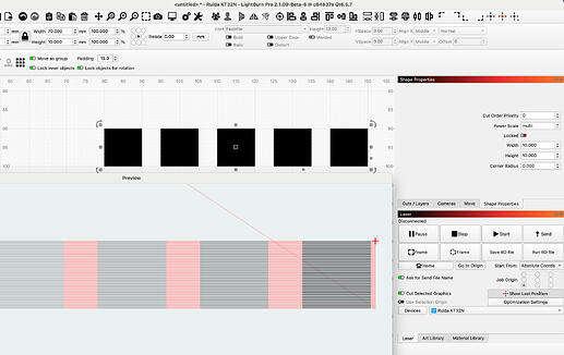

Large squares have nothing to do with it. Maybe you didn’t get the picture I was drawing? Let me draw it out for you.
As a result of the lightburn programmers refusing to treat each row as a group each square is on its own layer which forces light burn to burn each square individually (which also makes the three radio buttons that are shown useless. That was a waste of time to put them there because they don’t work during a material test) which in turn does NOT allow the laser head to get to full speed.
Since the laser head doesn’t get to full speed you are not getting an accurate representation of that speed.
So knowing that, why not fix it or why even have a material test in the first place because we have to make our own because of that.

The answer is in the question. You cannot have one shape with one set of variables and another shape with different variables on the same layer. Layers take precedent over Groups
Layer = same variables for all objects on that layer. There are multiple suggestions on how to enjoy your ice cream - the rest is up to you.

If it’s that important to you and you think it’s the right way to do it, you can get “fill all shapes at once” for any group of shapes - as long as they are on the same layer. To do a power test, you should then use the “Power Scale” function.
Do a simple test and see if it gives you what you want to achieve, and especially if it gives you a representative result for a power test.

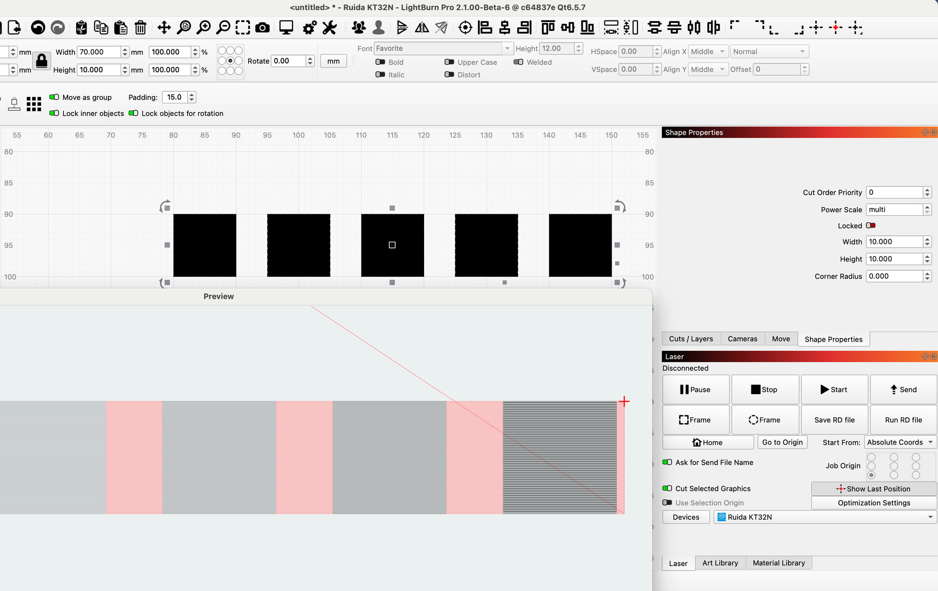

None of those work during a material test. I can select any of them, even fill all at once, and each the result is the same. It just fills each square individually during the preview.
Try it and screen shot it in slow mo filling all squares at once and post it here for me please.
When I am talking about dummy switches I am referring to switches that are there and are not grayed out.
As in the radio buttons for the material test. None of them work.
Especially fill all at once. Try it using the preview. Result will be the same each and every time. It only fills one square at a time.
