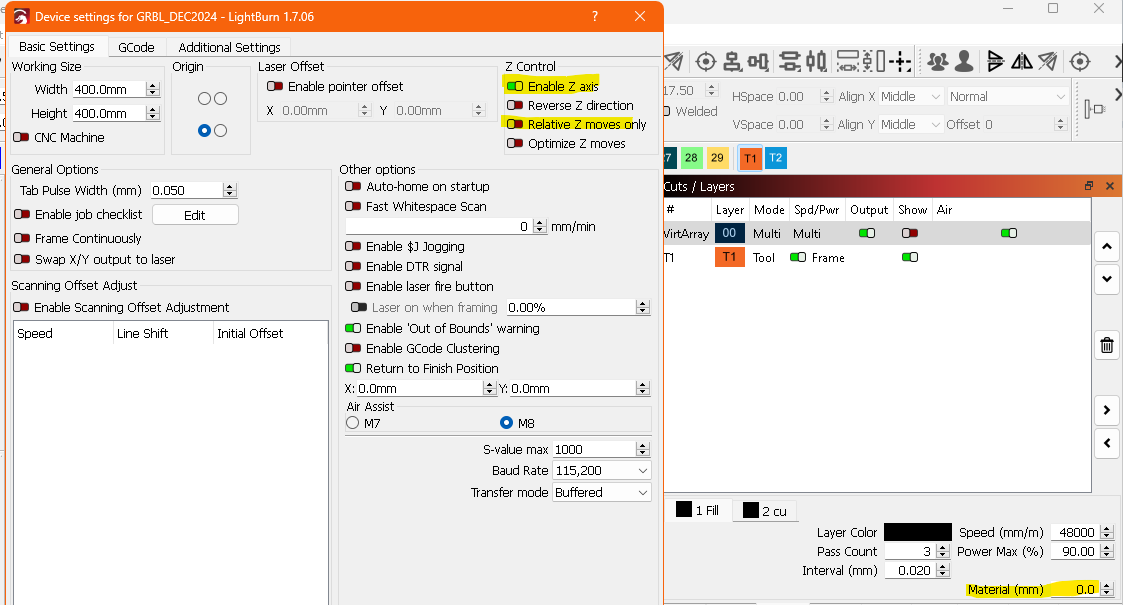

The image below shows the parameter I’m looking for in the material test. This is just a layer that I added to a blank document. I’ve seen others comment in the past that this layer material thickness is used for material tests, but in order to even make it active, you have to create a layer in a blank project. So I’m not sure if this is what people are suggesting. I just don’t want to damage my laser.

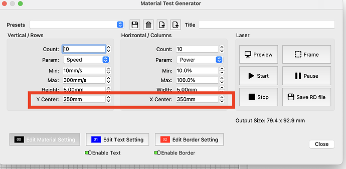

The material test centers the test in the workspace by default when using Absolute Coordinates. You can change the location of it with the X Center and Y Center dialogs. You can also choose User Origin or Current Position from the Laser Window before going to the Laser tools Dialog and it will use those start modes.

I was in absolute coordinates when I took this screenshot. If you look at the coordinates, that is the center of my 500 x 700 bed and the test pattern centers on that location. It does not go to a 0,0 origin point. It would be nice if you could set a 0,0, but the manual adjustment is for “center” of the test pattern, not a corner. You can adjust these settings to get it closer to a corner, but without knowing the dimensions of the test you can’t get it exact. I usually hit the frame button and place my workpiece appropriately. I also have my system set to frame continuously when adjusting things manually.
If I choose one of the other Start From modes, those settings are grayed out and it uses the 9 dot job origin along with the set origin point, or current position if you choose that mode.
The test runs the text layer first, then the engrave or cut, then the border if enabled.
In Device Settings if you enable Z axis, disable Relative Z moves only, you have access to material thickness in Cuts/Layers.
If you look just below the "STOP"button it shows you the size the Test output will be.
Well, what do ya know? Thanks for that.
Not sure when that was added, I only noticed it about 2 updates back, I don’t think it was originally there, but might have been and I just hadn’t noticed it either.
