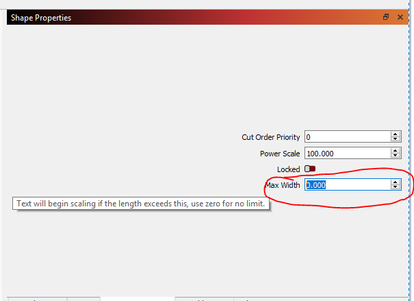

I think the best solution to your query would be to use Variable text. You could put all of the data you are engraving into a .csv file, then put variables into your spaces in your jig that will load all that data from the csv file into the appropriate places. You can set a Max Width for the text in the Shape Properties area as well that will scale the text once it gets to a certain width.

My max heights are 70 mm width, 20 mm height. I made the %0 20mm height and set max width to 70mm, but all variable texts turned out stretched. Is it possible to keep the font ratio?
