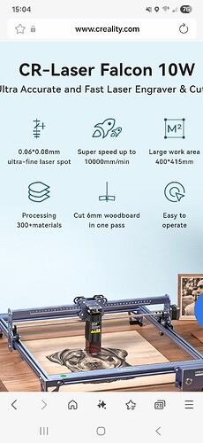

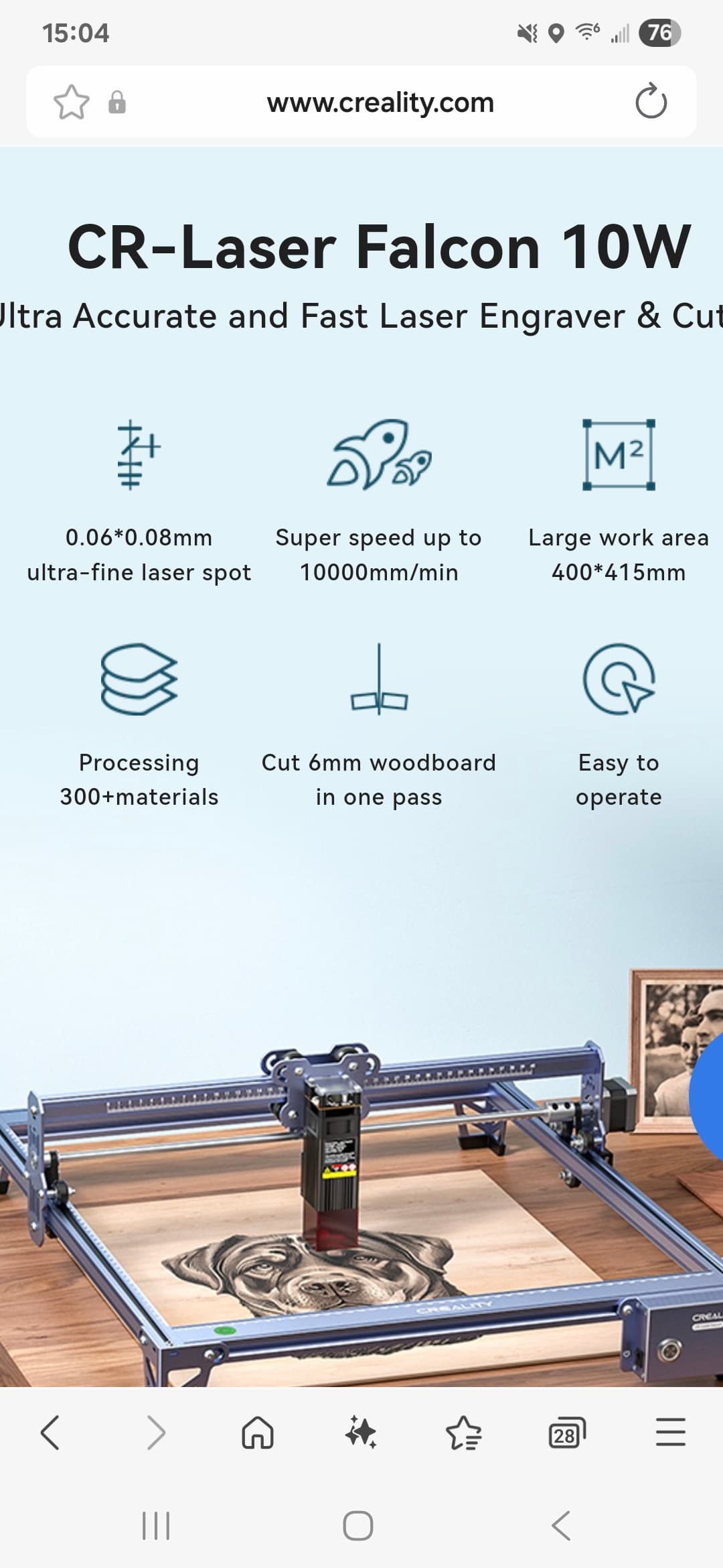

Correction i am using mm/m. So not super fast. I think i found my answer on the creality site. It said as fast as 10000 mm/m. So ill use this as my “fastest” available setting. Thanks all!!

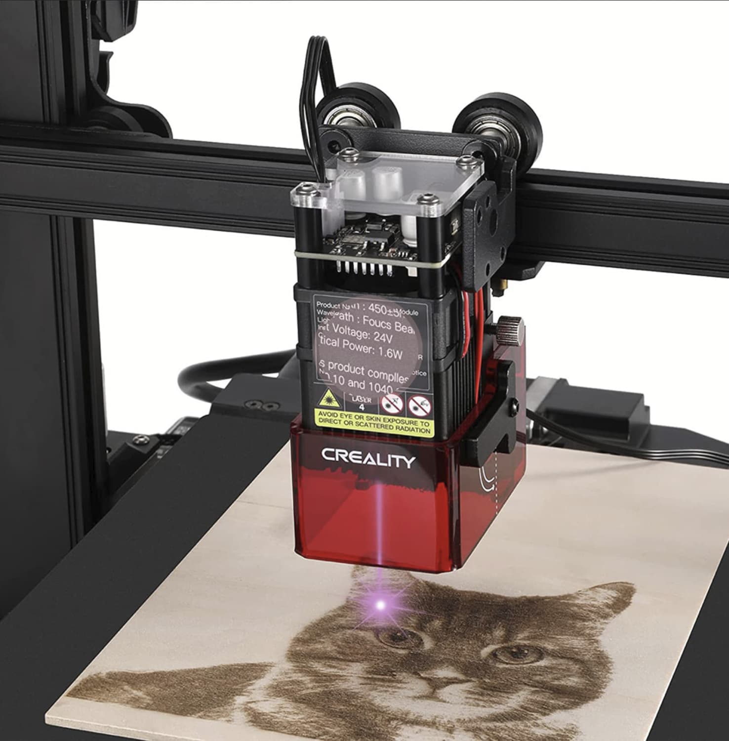

Is this the 3D printer or the Laser module? Belt drive or screw drive? Google was not much help.
No. The maximum speed is not related to the laser head. The speed is related to the mechanics of the system and the weight of the laser head.
The Ender 3 s1 Plus is rated at 150mm/s (9000mm/min) maximum speed for printing. Printing uses a lightweight head. The laser head will be much heavier. Also, the workpiece will add additional weight to the bed.
I’d expect about 5000 mm/min as maximum for your machine. More won’t make sense, I guess.
Ender 3 S1 is the 3D printer. It’s a belt driven “bed slinger”. (Y axis moves the bed). The X is on POM wheels.
The printhead is detachable and they sell laser modules to attach:
@spike80 you posted a picture of the Falcon.. Which machine is this about?
