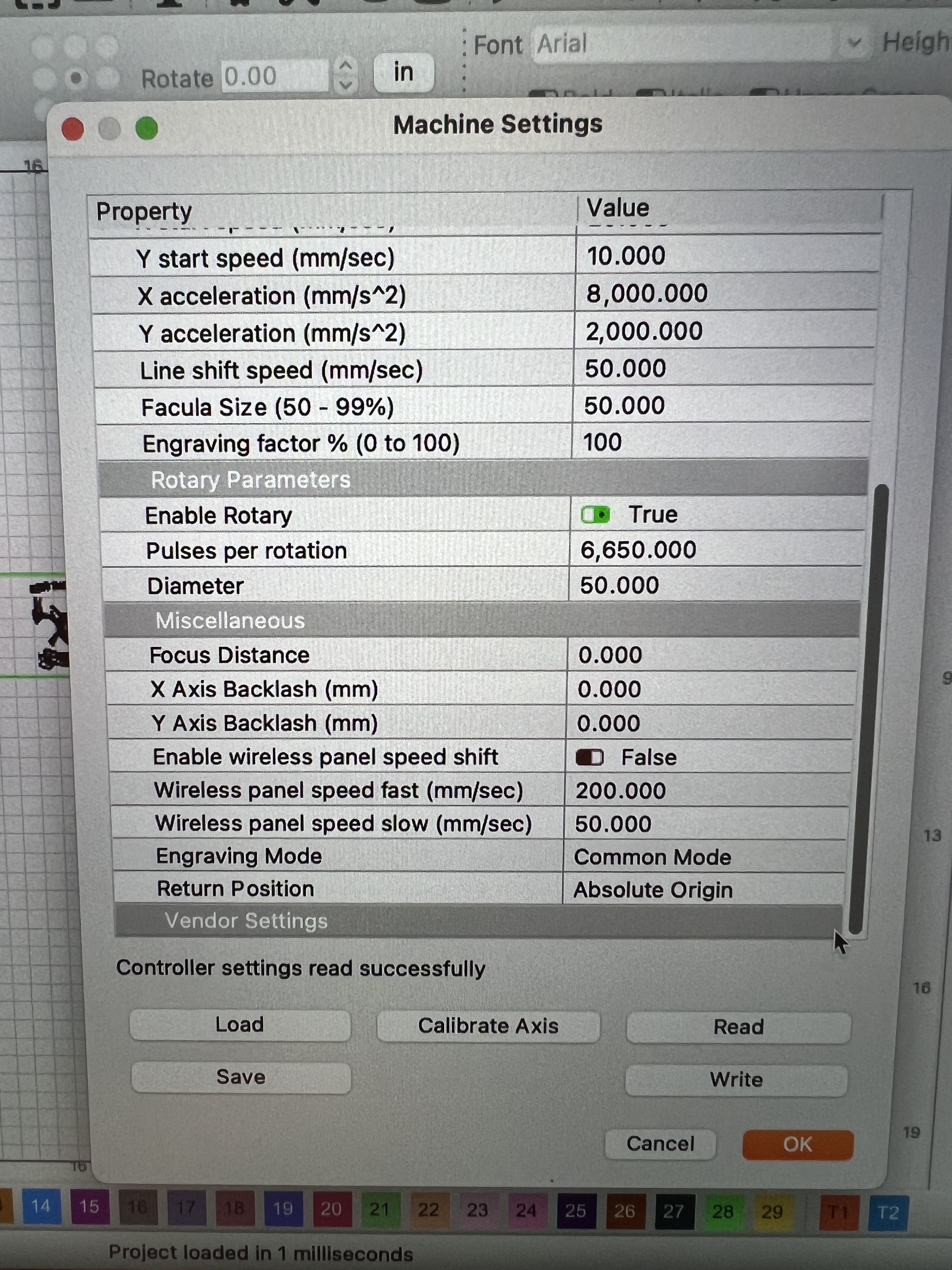

Measurement issue
Noticed my measurements weren’t correct after cutting.
Tried using the calibrate axis form multiple times but nothing would change.

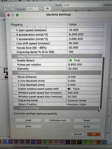

Looked in machine settings and noticed the rotary was green “true” so I turned it off. Which did nothing other than make my laser head super slow and make the y axis even smaller when I framed it.
Not sure what the heck is going on. Any help would be greatly appreciated!
I attached a picture of my machine setting screen before I turned it off.

I’m not trying to use my rotary right now. I’m trying to do flat work. For some reason the rotary keeps getting turned on somehow. Both in the machine settings menu and under tools where the rotary set up is. The rotary I have is from HM laser accessories.
Turn the rotary off… that’s probably your problem…
Use Laser Tools → Rotary Setup and turn it off there…
I tried that. It is supposed to be a 3x2 rectangle and with the rotary on it cuts out as 3 x 2.51. When rotary is turned off it is 3 x .18 and the laser head goes extremely slow.

You calibrated the axes… what did it change? If nothing changed, something is wrong…
Nothing changed at all🤦🏼‍♀️
