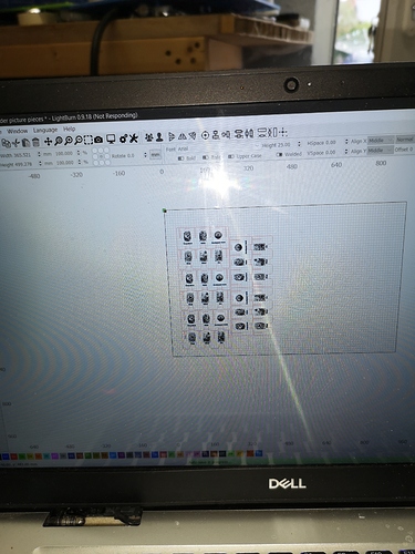

Is there a limit to the amount of information you can process at a time. I had two boards on the machine with lots of small images. The engraving went all over the place. After I removed a lot of the graphics it started working okay.

Incidentally, Just recently I keep finding lightburn stops responding almost after every action I make, It can sometimes take 3 minutes or so before it starts working again.

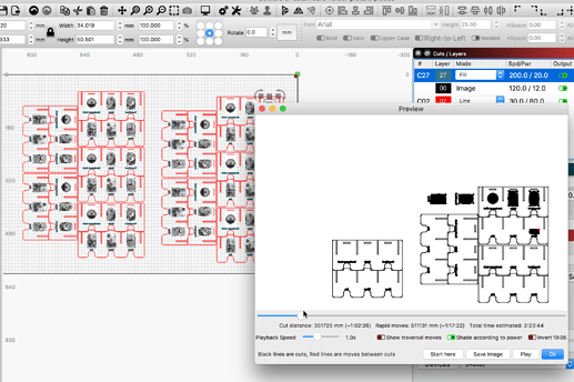

What settings do you have for this job? How did you optimize this job? Share the LBRN file and we can take a look. If the ‘Fill’ is jumping around, my guess is you have Flood Fill set or have the optimization set in an unexpected way. But only a guess as you have not provided much detail here.

This is a huge file, so I would think you may have problems sending this large of a file to your controller. I notice the images embedded in this file are very dense for their intended production size.
The ordering you have chosen is also making this job bounce all over. I see cuts happening before fills. Was that intended?
No, the cuts where supposed to happen at the end, also I noticed that some of the pieces are broken into sections, whereas some of the others are one continuous cut. I will amend them. I thought it would be the images causing the problem.
Might be as well. These look like the copies of the images have different DPI’s set. Some are 254 and others set to 300 DPI. Was that intended? These overall images might be larger than needed for the desired production size.

Do you use ‘Start’ or ‘Send’? Sometimes with ‘Start’ it’s possible for the controller to get overloaded, running images while still receiving the file data. If you use ‘Send’ and then start the job from the controller itself, it’s only doing one thing at a time, so this isn’t a problem. The RD data generated for this file is only 11mb, so the output is not massive by any stretch, but I would try that to see if it helps.
For the freezing, it’s quite possible that Auto-save is causing it, because the LBRN file is really large, and the images will take some time to compress. This will depend some on how powerful your computer is, and where you’re saving the file - if the project is saved to a USB drive or network location it will take significantly longer to save than if it’s going to a local SSD drive, for example.

That will improve things, certainly. You should change the image mode from ‘Atkinson’ to threshold though for those, at the very least, and you might want pass-through enabled. This looks like they went through Photograv. :slight_smile:
