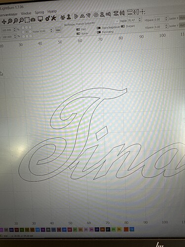

Merge text in Lightburn
How do I merge text for cutting, the T and i does’t connect.
Convert text into path, add a small rectangle between the 2 and weld them
Convert the text to paths, ungroup, nudge the “T” closer to the “i”, and weld them together. You could also lower the dot over the “i” so you can weld it also.
LightBurn will automatically merge/weld the text as long as you have the Weld toggle enabled in the Text Options Toolbar (you have it enabled now), when the letters are overlapping.
To bring the T closer to the i, and automatically merge/weld them, reduce HSpace until they overlap.
Thanks, it worked👍
