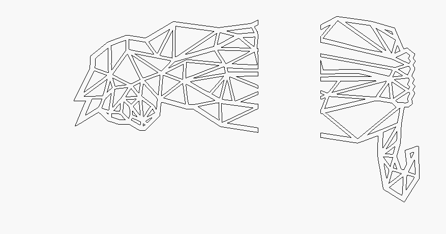

i need methode to make 2 or more parts connectable like puzzle, but puzzle is not what i realy want/ interlocking

connecting like example

The image just below (looks like a cat, maybe) has no “connecting” or joints shown. To me, this looks like a lattice like pattern has been applied to a single piece of material, yet in two distinct halves. I must be missing something in this example.
rthats right :slight_smile: thats a cat, and i need to connect this cat like at the example pic slots and tabs to connect this to cat parts to one part because in need this cat much bigger as its possible on my laser
While achievable, this would require a bit of hand editing to accomplish. We have another way that might work for this requirement, produce something that is larger than the laser bed. Take a look at these to see if you could use the ‘Cut Shapes’ and ‘Print and Cut’ feature to get what you are after.
Using the ‘Cut Shapes’ and ‘Print and Cut’ features of LightBurn to cut a project larger than your laser bed (and using it to correct an error).
