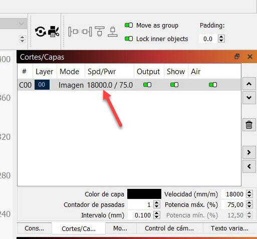

Please select and copy the text from the Console window in LightBurn and paste it into a reply here.

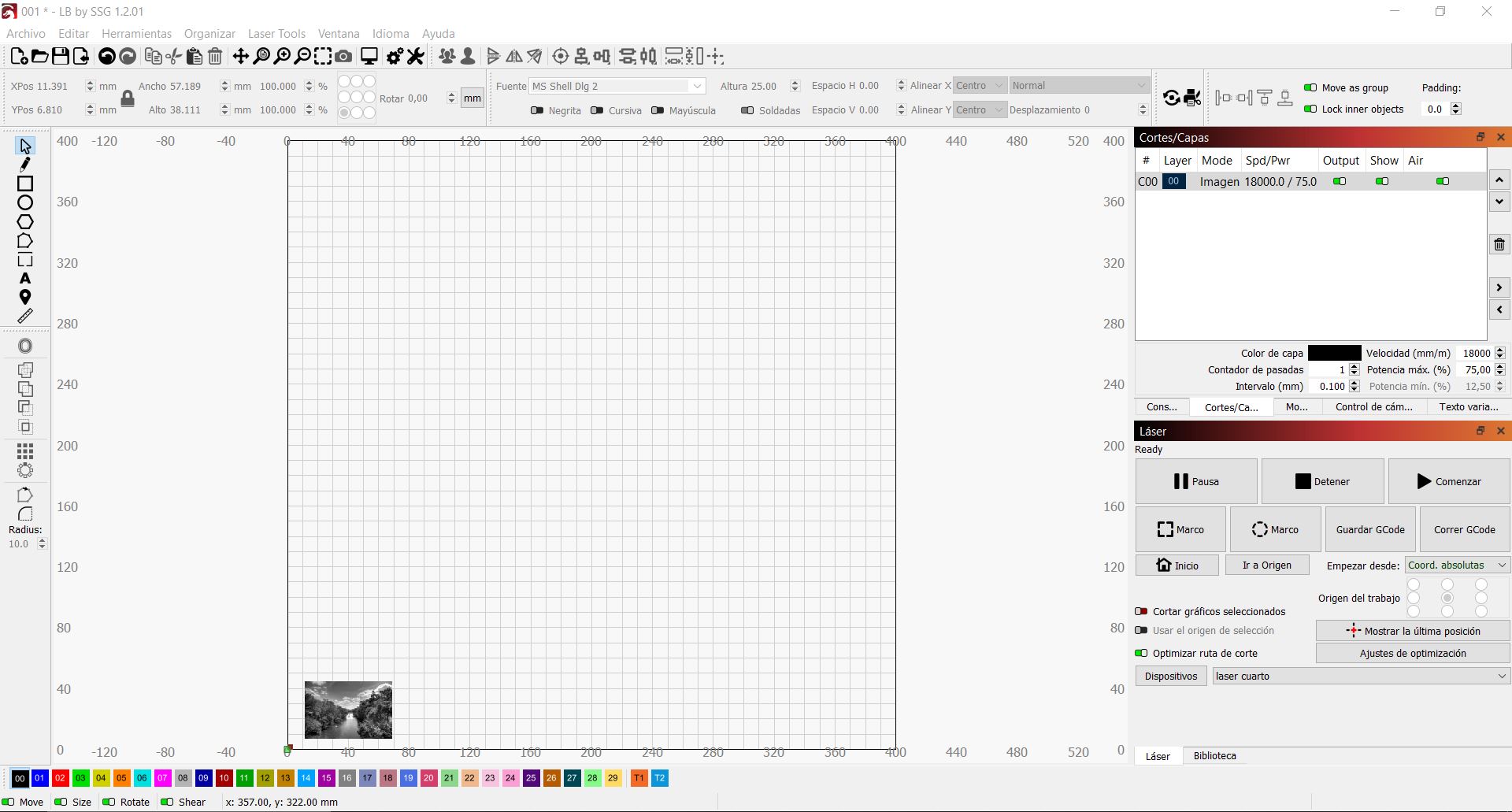

Then, use a screen capture tool to capture the LightBurn work area and your Cuts / Layers settings.

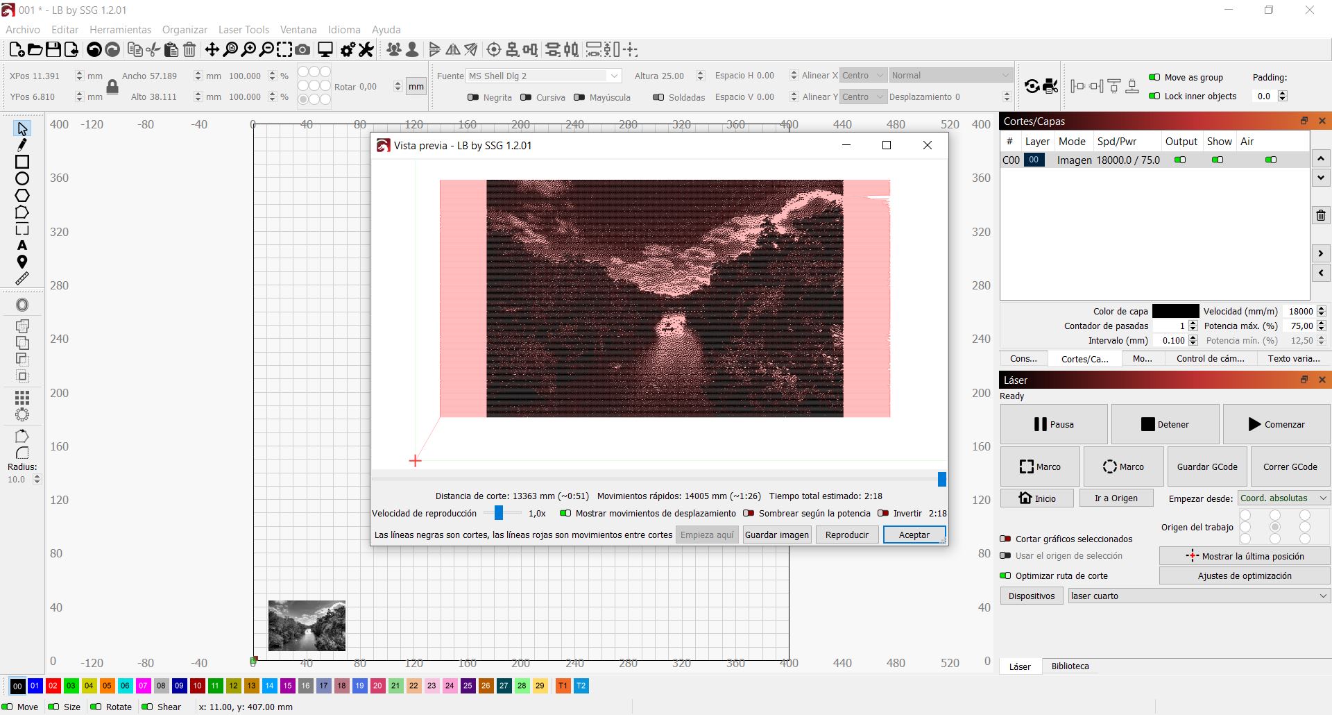

Then, click the Preview icon in the top row. The Preview icon looks like a flat monitor on a monitor stand. Select the ‘Show traversal moves’ switch on the bottom, Zoom out to see the entire image, then capture that preview with the screen capture tool as well.

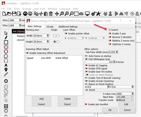

If a Z-Axis move is commanded, and there is no Z-Axis motor or hardware it may cause error 24.
Please confirm the status of the Z-Axis in device settings. It should be turned off.
Your engrave speed seems somewhat fast for image engraving.
Forum 101912 lightburn speed
Have you completed a Material Test for your project?
Forum 101912 lightburn header

I loaded the 001.txt file as 001.txt.nc into Lightburn and got a flashing picture of a tree lined river. When I opened the preview window, the “Optimizing cut plan…” hangs at 80% with a big delay when closing the window. This also halts the flashing. What kind of GCode program can do this?
I also see “; LB by SSG 1.2.01” on the first line of the file, which is kind of odd.
UPDATE: When I de-selected the image, the flashing stopped. Flashing started back up when the image was selected.Still same question…
