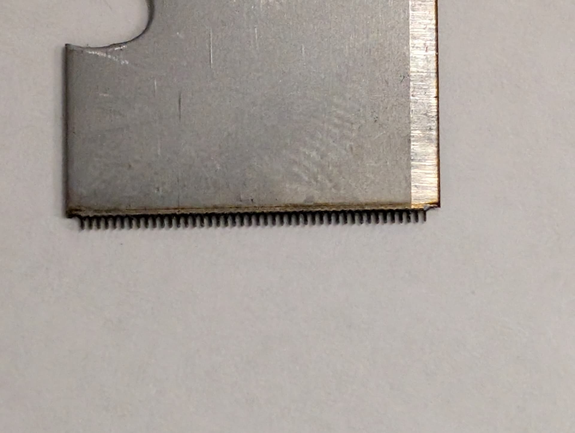

My company makes some really fine-pitch ceramic ICs- 0.4mm pitch. That’s a 0.2mm lead and 0.2mm gap.
Being so thin, they get bent up pretty easily, and then the tooling capable of going between them to fix it is very limited. A utility razor blade is too thick, at 0.5mm. We’ve used the acupuncture needles that they use to clean 3D printer nozzle clogs, but they’re rather springy.
I needed something much thinner, but also, steel is very bend-able in once it gets super thin. I wanted steel with a temper. I don’t have a carbide endmill this small. Runout would probably be too high. And it’s not likely to work on hardened steel.
OK, but a MOPA wouldn’t work either… would it?
Check out what I did with the 0.5mm utility blade. A comb with 0.15mm teeth, 0.4mm pitch!
I ran it SUPER slow, and it didn’t ever get hot enough to lose its blade temper. Those teeth won’t bend out of shape- I did some extreme stuff with one and broke a tooth, but they can’t bend. It’s still got that temper for sure.

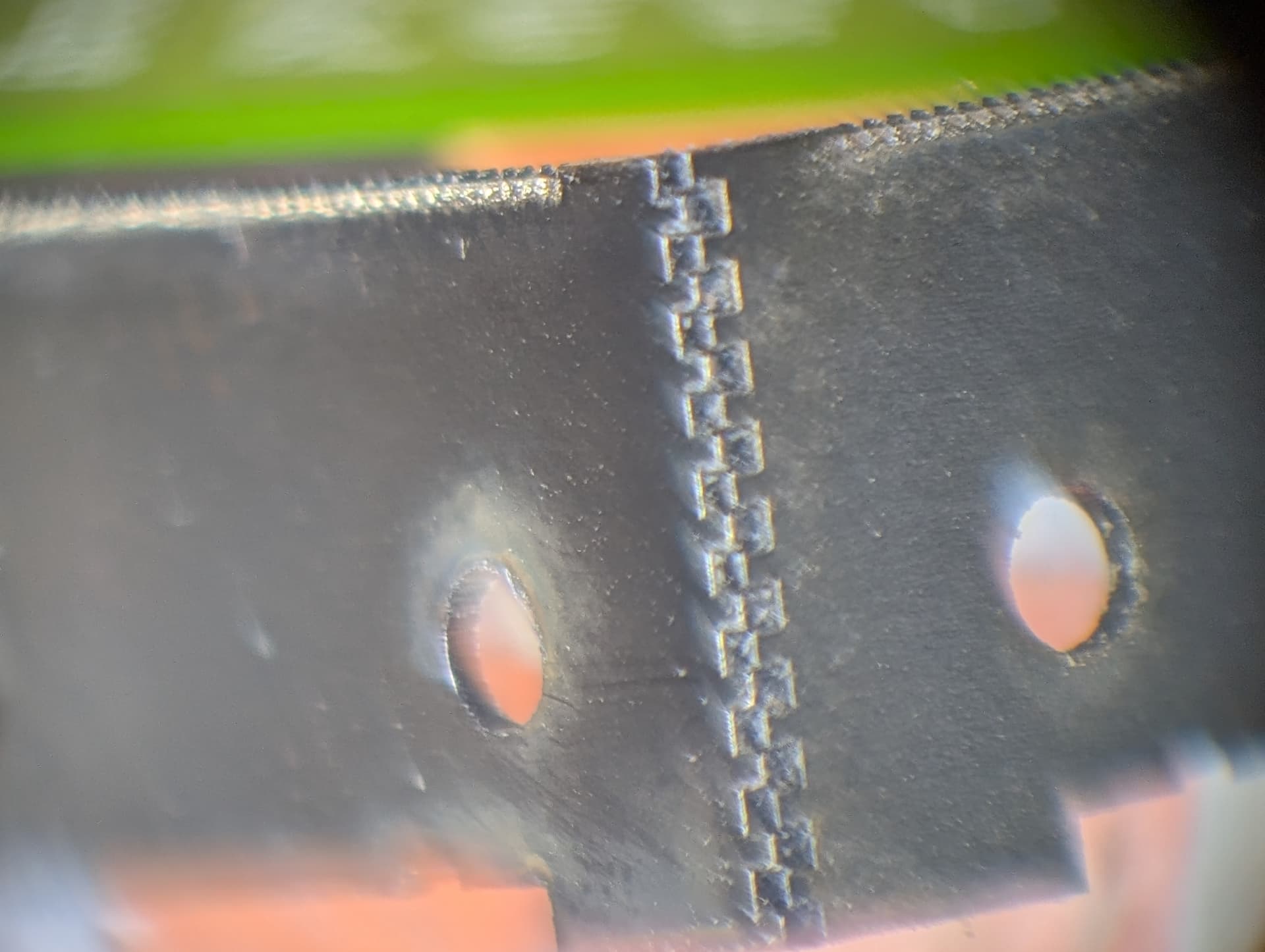

This got me thinking- this kind of reminds me of a finger joint. Hey, you can’t make a finger joint on this scale, can you?
Challenge accepted

Sometimes I lowered the Z, but it would work without it too.
Depth of focus is a “waist” because the cone of energy coming down doesn’t actually come to a point, there’s a small region of constant nonzero diameter. The depth of focus seems to be about 0.5mm tall for the 110x110 lens, the beam is basically the same dia as long as you’re in that small range.
When focusing, I found the “big spark” point, then wobbled the z handle to find the Z range where it basically gives the same spark, then moved to the lowest point before the spark weakened. That would put the blade top at the top of the DoF.
The first phase rastered it out. I was actively trying to avoid having the raster align with the right angles of the design, so I started at 3 deg and incremented at like 48.371deg 50 passes so it never really aligned with the design.
Initially, the cut profile of the teeth was somewhat trapezoidal from the side, narrow face was the one facing the lens. The gap between teeth was narrower on the bottom.
I wasn’t actually sure which direction the trapezoid would face. If the beam diverges slightly but still cut, they could face the other way.
The blade was being held horizontally between two rectangular blocks so it had air space underneath it. Ceramic tile below as spoil, it was about 3/4" below the blade so the beam was too out of focus to cut the ceramic. The air gap gave room for the sparks to fly out freely.
I used an adjustable CPAP blower on a rigid arm to cool it and direct the dust away. It had to be turned down a lot, those things can produce a LOT of high speed airflow, and some static pressure increase too. It wasn’t throwing “sparks” like a grinder, it was a little fine brush of orange past the green flash.
In later revisions, like the box joint, after rastering I just had it follow the line. No wobble. Gave it only a tiny kerf. I just let it run fast on Continuous until I stopped seeing the brush of sparks coming out from underneath. This removed the trapezoid efficiently and made teeth with much closer to 90 deg. Took a couple of minutes.
I also left 2 really narrow tabs on the base. In a third step, I rastered through them until the part just fell out on its own. That part took under 1 min so I just watched it and shut it off manually when it fell. It had enough room to fall that it took itself out of the effective DoF anyways, the beam hitting it after falling couldn’t mark it anyhow.
Kind of amazing, I didn’t clamp that blade. Just held by one rectangular piece of aluminum on top of the other. During the first attempt, it appears the CPAP flow rotated it a bit.

Given that the finger joint worked, I could see making a tiny box too. The MOPA can be adjusted to weld a finger joint in place too. The finger joint produces higher accuracy as it’s welded. It’s certainly “the hard way”, though.
