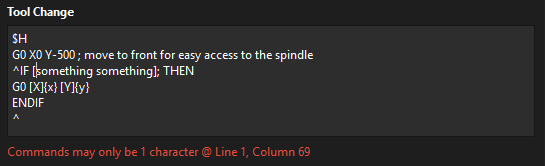

Ooh. I was looking for this. I didn’t see how to do that in the documentation. Any detail on how that works?
Yeah, I had a conversation with someone about that. That is not how I learned it with the big machines. :joy:
If you look in the custom gcode tab, you’ll see you can select the escape character.
By default it’s the ^ You can change it, and whatever is in placed between those characters will be passed in verbatim.
So if you had a header that was something like
$H
G0 X0 Y-500 ; move to front for easy access to the spindle
^IF [something something]; THEN
G0 [X]{x} [Y]{y}
ENDIF
Essentially the gcode that will be sent will be exactly as you see it, minus the ^ before IF and after ENDIF.
Looks like it’s still trying to validate whatever is between the square brackets. I can save it, but it doesn’t end up in the gcode.
OK I’ll double check with your macro, I thought I tested this fully but apparently there’s an edge case I missed.
Ok yeah, it looks like something went sideways when several features were touching something in that part of the code.
Typical case of “too many cooks in the kitchen”. It should be fixed in the next RC.
