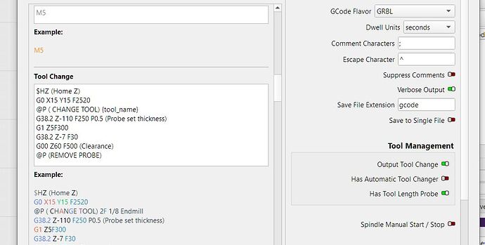

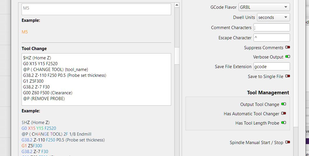

with a probe u may not have to worry about a start script
this is what i have in custom codes and it does what i need
I dont use the probe wizard , it seems to double up on probing , with what i have in tool change
it was trial and error to get it working for me

under “cnc tools” “device settings” “custom gcode” there is a tab for “manual spindle start”
