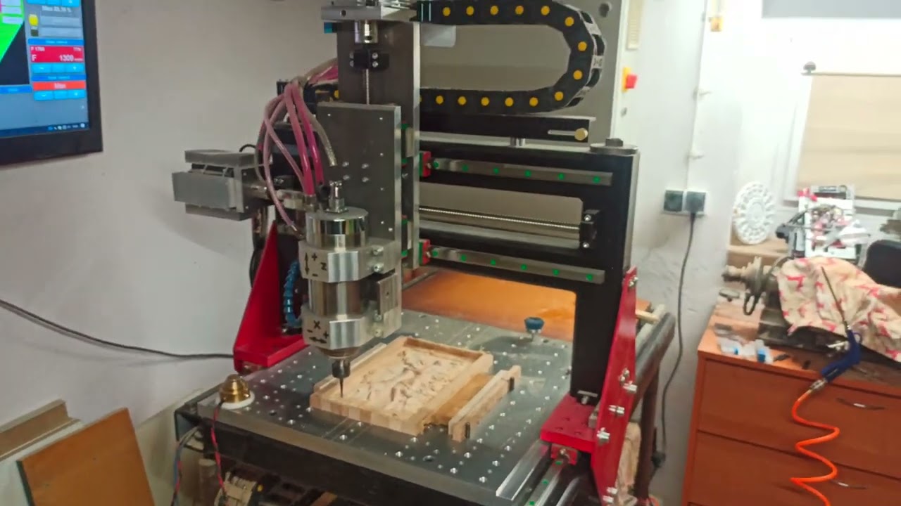

“my” pikocnc is full polish product, it has lot of usefull function, im using it on my home made machine until 2020… so i can see diferences beetween piko and mill mage
here is my machine
What controller board?
dedicated from pikocnc.. the man build own board, own firmware, own cad, cam.. simulator until 2020 do not make any mistakes… price is low for functionality of that product.. but as i writed.. only one man… project can die fast when author pass away… so im searching for next software

Nice machine, and beautiful work, @BartekN

As for my machine, thanks for the kind words… two years of building, the frame is welded, annealed, and milled so that the linear guides are straight on the surface… designed for wood, and in stainless steel it also copes with gentle treatment.
The is a stout looking little machine, nice.
I appreciate, but it is still not as stiff as it should be, such a drawback of devices with a moving gate and not a table
FYI, The motor (or laser) is mounted on the Trolley, and the trolley moves across the Gantry. Like an overhead crane.
I completely understand the mechanics, which is why, for example, the Z-axis rails are relatively wide, and the same goes for the X-axis. Despite the use of Hiwin carriages with preload, there’s some play between the parts wherever something moves.
The gantry, when touched with a dial gauge and pressed firmly, moves by 0.1mm. This means the device isn’t rigid.
The next machine will have a fixed (bolted) gantry.
And the table will move, this time on 32mm rather than 20mm guides, and with three carriages per rail, not two.
everything is a compromise, it is not possible to have a small machine with a large working area without sacrificing stiffness
