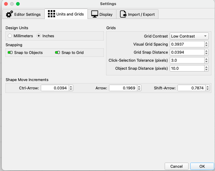

I am trying to design in inches.. think I did everything necessary to set this up, but when I go into my project (units and grids tab) in settings it always goes back to millimeters. Then, even after I change my settings to Inches, the MOVE tab remains in mm. While many may like mm, I’d rather use inches as I have to ask Alexa (sorry to those that like mm) everytime to convert and although I’m just starting off, its a drag to ask all the time. Thank you for your

There are 2 places to make the changes. One is Design units, in Settings> Units & Grids. It can also be changed by clicking the In/mm button on the toolbar.

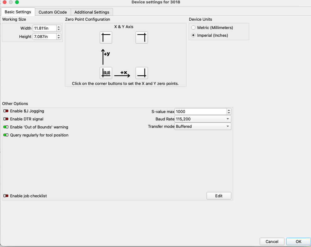

I changed the device settings to imperial and millmage crashed. i was thinking device settings needed to be the same as the actual device (which is mm).. is this correct?

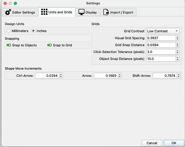

Also, in the other settings I change to inches yet my Move tab never changes to imperial. I do believe Lightburn is in inches, so feel like there is somewhere else that must need to be changed that I am missing. Any help appreciated.

The only way the move tab will display inches is if the device settings are set to inches. Changing by clicking on the in/mm button only changes the design area.
