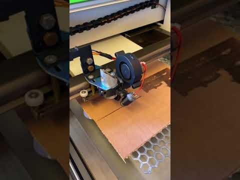

hi, i just upgraded my standard k40 controller to a mini gerbil 2.0 and im having loads of trouble with it, the x axis stutters like crazy when trying to engrave no matter what speed i set it at, ive had a few suggestions off facebook groups but nothing works, even with the motor in my hand you can feel the jerkiness so its not the gantry at fault, the old controller worked smoothly , i have came to the end of things to try ,has anyone else had this issue ? i have tried everything over the last 20 days or so, im running on my 30 day trial of lightburn and have 10 days left to get it working before it expires :frowning: i will buy lightburn straight away if it will work with my controller

video of it with the drag chain on

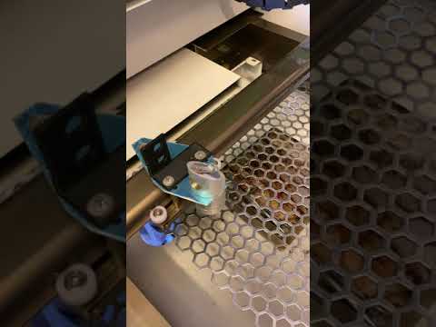

video without the drag chain
video of it with the motor in my hand so its nothing to do with the gantry it has to be either the motor or the controller or the software i think

they say they are public, 2 of them are still processing
What were the settings used for the file being run in the video?
Sorry I never seen this post, the settings I have tried range from 40mm/s to 150mm/s and from low to high dpi and it’s always the same , it will raster engrave a simple image like text no problem but not an image
