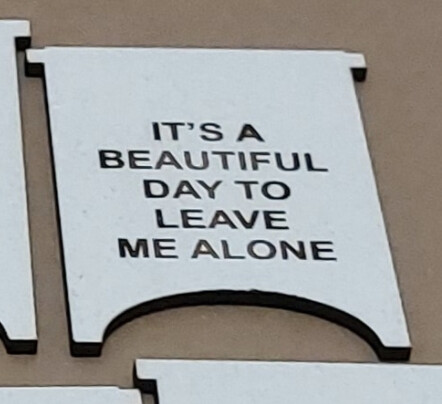

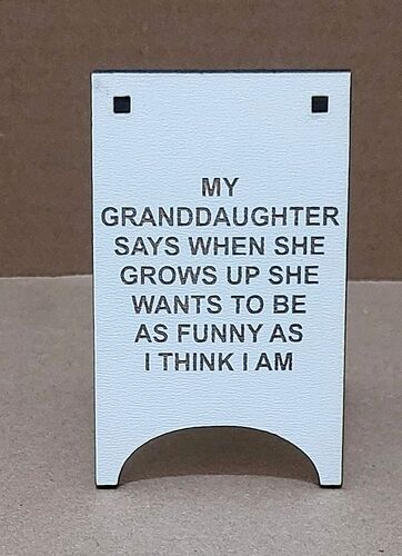

I’ve been making mini sandwich boards (essentially folding signs) from 3mm MDF sheets. I engrave on both sides, assemble them and I’ve been selling a lot of them just by word of mouth. They fit great on a desk or counter and are easy to make.

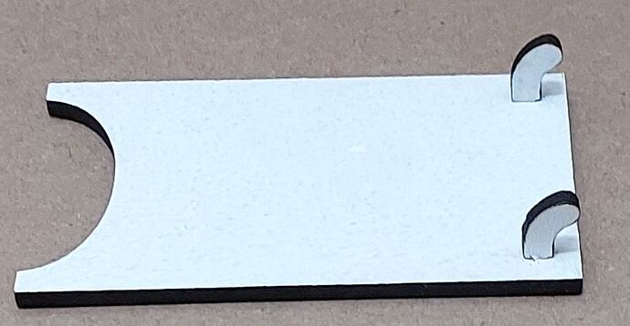

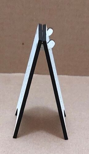

I don’t bother gluing the hinges on the inner board as I set the kerf so it is a tight fit.
For anyone who wants to make some, I’ve included the LB file and a picture. The LB file includes basic directions in the form of a diagram. I recommend pushing the inner hinges onto their board first. Then put the outer hinges on and a small bit of glue holds them in place. They spread in and out easily (assuming you’re better at not getting glue everywhere than I am) an are easy to make, especially if you paint the MDF before you start engraving.
If you go to craft shows, you could even have the sides engraved and assemble them quickly with whatever saying/picture the customer wants.

So I decided to update the file to make it easier to assemble because I was asked to make 2500 before Christmas.
It took 10 sheets of MDF, which I bought with one side already painted so I only had to paint the opposite side.
If you set the kerf correctly, there is no gluing necessary which allows for much faster assembly and less super gluing of fingers to various other body parts.
LB Sandwich Board.lbrn2 (12.3 KB)
Each sign has a saying or picture on each side.
I’ve attached the new file so, if someone wants to make some it should be much easier.
