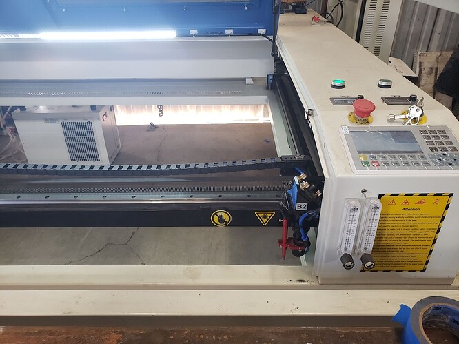

Mirror 2 to Mirror 3 isn’t consistent along the entire Y axis. When Y is at 0 and at the maximum the lasers aren’t directly aligned.
How do I fix this?

From the position of the laser head in the photo, this looks like a classic Fourth Corner problem.
If it’s already aligned so that:
Then put the laser head in the front right corner and adjust Mirror 1 very very very very slightly to move the spot to the center of Mirror 3.
If it’s not already perfectly aligned, then make it so before trying the Fourth Corner tweak.

That isn’t at all necessary.
You need to hit the 1st mirror at the height where the beam should enter the laser head. That’s not necessarily the center.
This is very important.
This is not true either. It needs to be hit at the point where it would then reflects at a 90 degree downwards, centered on the lens. This isn’t per definition the center of the opening.
Trying to center it, rather than trying to get overlapping dots, won’t get you a good alignment.
Your “classic fourth corner problem” also isn’t solved by first getting a perfect alignment from 1 to 2, and then somehow messing with 1 afterwards again.
It’s much more likely that the rails aren’t perfectly coplanar and the head is thus dropping out of alignment. No amount of 1st mirror fiddling will fix it, other than average out the error over the length.
This technique of putting tape on, burn and check is unnecessary and highly confusing. I agree that going back and changing mirror 1 just adds to the confusion.
I switched over to the reverse alignment process and would never go back. I can align my machine in less then 5 min including finding wrenches and adjusting screws.
Also what’s the objective of a CO2 alignment? For the beam to pass thru the center of the nozzle over the entire bed. That’s all that matters.
Please confirm, are you showing us spots at M3 taken at Y-max,X-max and then Y-min, X-max? Is the upper spot from Y-max, X-max?
Could be an uneven support frame. Try shimming/raising just the front right (Y-max, X-max) corner up by 2-3mm and then start the mirror alignment again.
Yes, (X-max|Y-min) and (X-max|Y-Max)
I tried shimming the right Y axis and it seemed to have no effect on the dot at all

I’m just trying to understand here. All the 3 below are good
The beam from the tube is hitting Mirror 1 dead center and
Mirror 2 has a single spot at either end of the Y axis travel and
The spot is dead center on Mirror 3 with the laser head in the front left corner
With this being said, the 4th corner burn is down and to the right. Which lead screw should I adjust on mirror 1 to try and edge it into the middle of Mirror 3 at the 4th corner?
It’s usually intuitive for me but adjusting mirror 1 for mirror 3 adds a little bit of confusion into the mix and which way the beam will travel after hitting mirror 2.
Standing behind the machine and looking forward, adjust Mirror 1 to move its top back (toward you) and its right side forward (away from you). Do that in separate steps, checking after each adjustment, because I have been known to be wrong in public. ![]()
The total adjustment will be on the order of 1/16 turn of the screws, so this is not the place for dramatic motions. Tighten the locknut after each tiny adjustment, because taking the slack out of the screw threads will change the results.
When you think you’re done, verify the alignment all over again and show us pictures of the scorches at each mirror so we can check your work.

The support frame under your machine looks unusual, was it modified? how is it connected to the machine? Try shimming the front right corner up even more, by the way I meant at the base of the machine not directly under the Y-rail. Does the back right of the machine lift? Keep testing while gradually shimming up the front right corner, but stop if the front left or back right starts to lift.
Or, if you have a laser level, like a self levelling oscillating one a builder would use to throw a 360deg line out on a wall, mount it in the middle of the machine’s working area, and then level the machine so that the laser marks the front and back of each Y-rail in the same place, it should also mark the nozzle at the same place in all corners. The purpose of this is not to make the machine level (though a useful bonus) but (given the issue you are facing) it’s just a means to ensure each end of each Y-rail are in the same plane.
