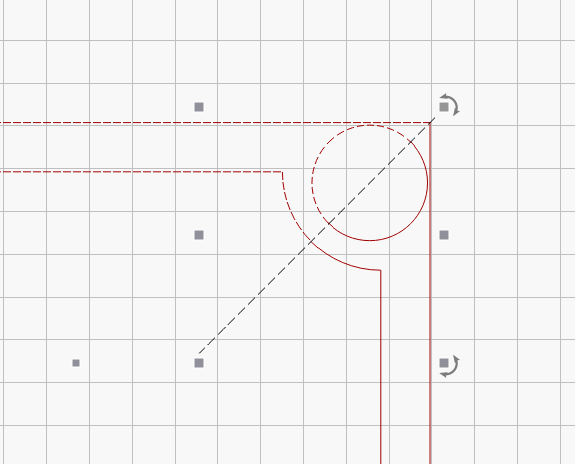

a) If I make a horizontal line, then rotate it 30degrees, then mirror, I get the duplication.
b) If I make a horizontal line, then rotate it 45 degrees, then mirror, I get the duplication.
c) If I draw a 45 degree line with the “Draw Lines” tool, mirroring sometimes works and sometimes doesn’t.

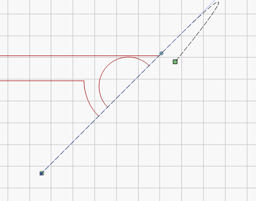

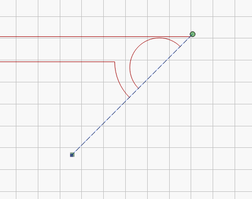

Your line is NOT a straight line. Select it then click node editor. You will see an end node (green) part way in from the one end.

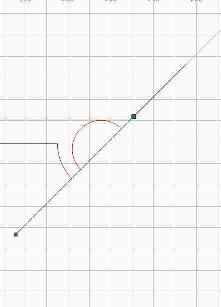

Hover over that green node and hit the D key on your keyboard. That will delete the errant node and mirror across line will work.
You can see here where I pulled the errant node away from the line.
