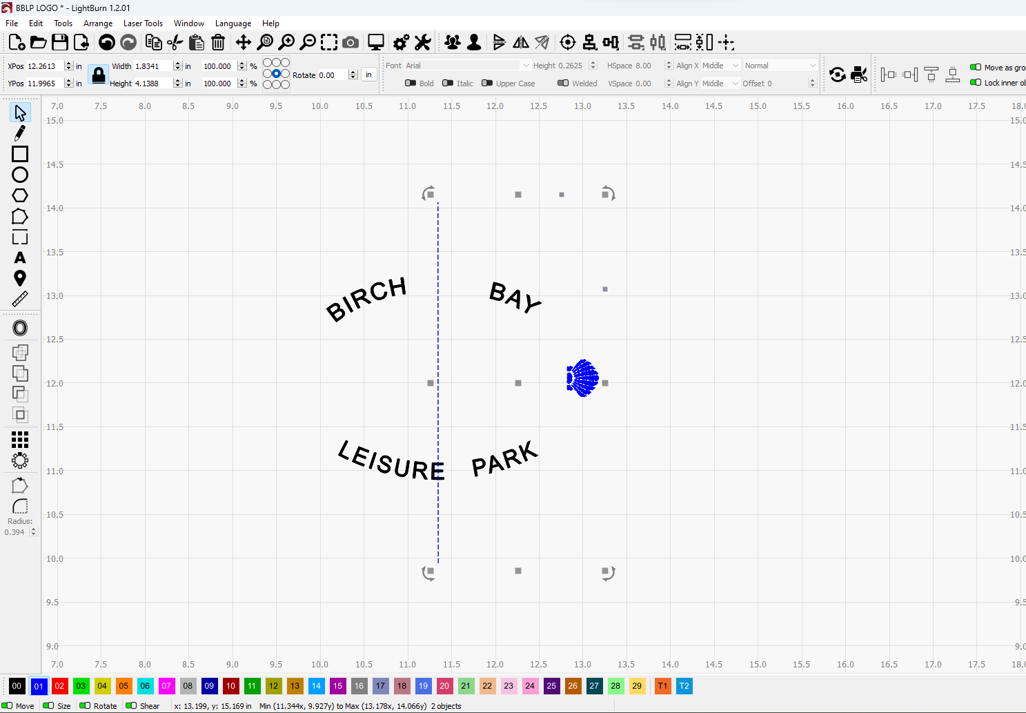

I don’t know what I’m missing here. Select the item to be mirrored, select line, and mirror across line is grayed out and not available.
I don’t see any reason why this shouldn’t work. Can you confirm that the line is in fact a straight single segment line? And not multi-segments or possibly a very thin rectangle?
If it’s not a single straight segment then make it so and try again.
Else, can you upload the file to review?
I’ll redraw it and see what happens I did use the line draw tool not the rectangle tool. Will get back to you.
Indeed there was a problem with the line. Made it again and fixed. Thanks!
