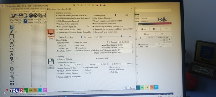

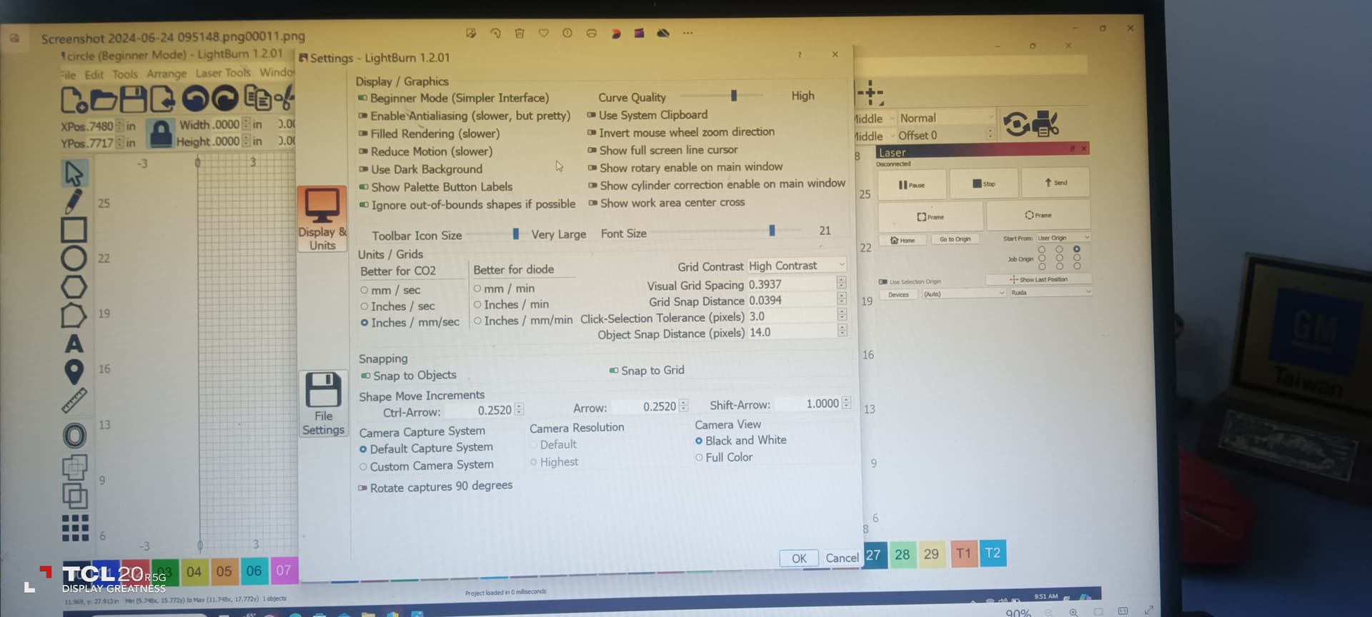

Machine start is r/h upper Hello Jack is this what you need or do i need to add more for you TEST RUN
“C:\Users\sammi\OneDrive\Pictures\Screenshots\Screenshot 2024-06-24 093817.png321.png”
C:\Users\sammi\OneDrive\Pictures\Screenshots\Screenshot 2024-06-24 095148.png00011.png
You need to be patient and let the site upload your photos… Neither of them made it.
will try again
Change the “Start From” mode in Laser window to “Absolute Coords” and try again. Do you still get the same issue?

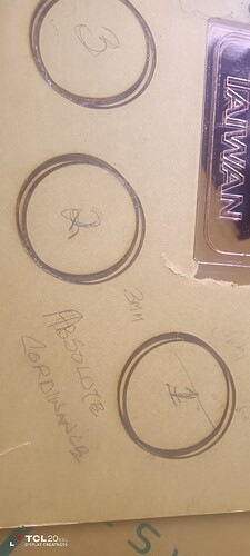

changed settings to absolute ordinance

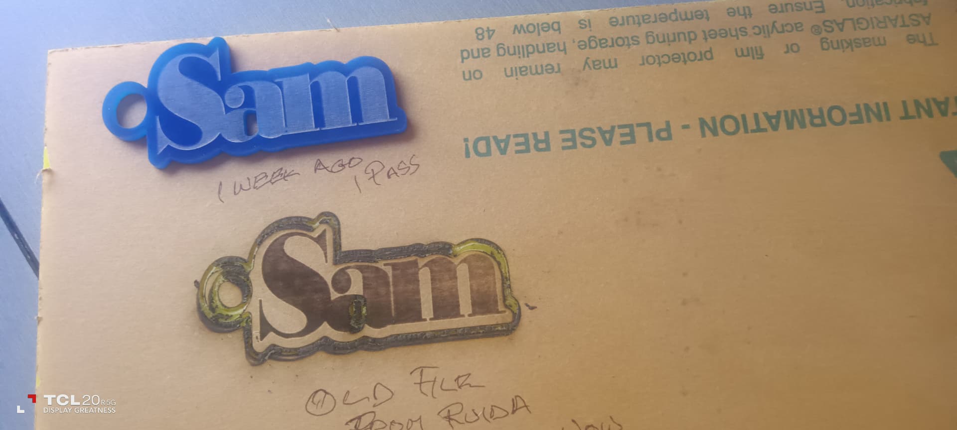

blue key chain was 1 week ago from old ruida file and cut 1 pass now run again with 2 passes and not cut through
notice the amount of soot now around cut
Change to Absolute Coords will not change the nature of the cut, only how it’s positioned. If the issue with “Out of bounds” is now not showing that indicates that you likely had an issue with where your origin was configured at the Ruida Panel. In that case, continue to use Absolute Coords or reset the Origin as appropriate at the panel if you want to use User Origin.
Hard to tell what’s going on with the burn based on the images. This looks possibly like a mechanical issue or a mirror alignment issue.
Can you confirm that you get the same quality of burn irrespective of the location of the material on your bed? Or do you get different results depending on location on bed?
If the latter that implies an issues with mirror alignment.

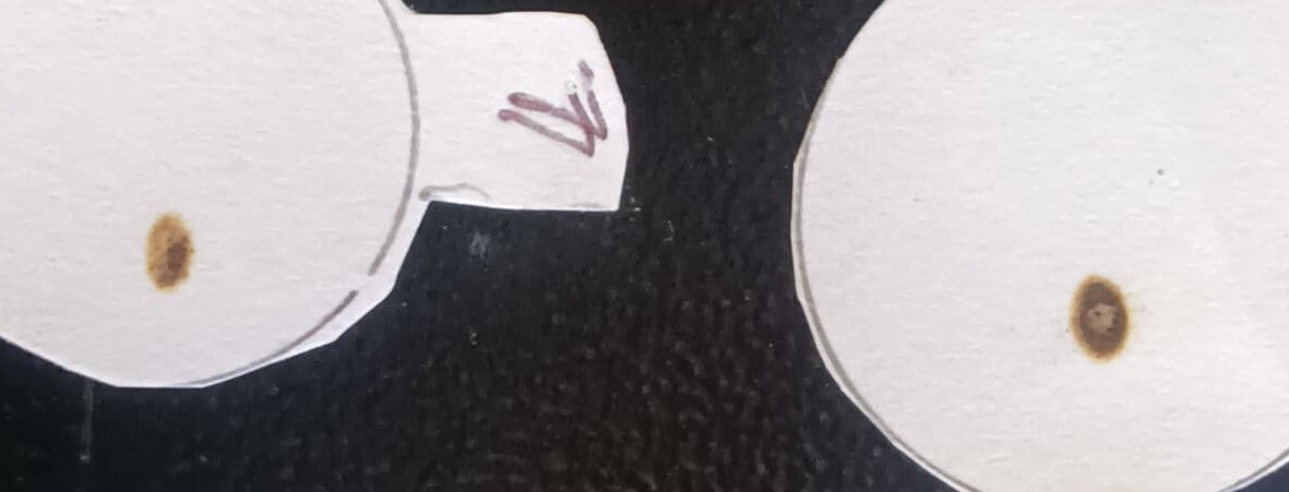

From all the photos I’ve seen posted, it still appears to me that the tube is not in TEM00 mode — if so it will never align or work properly … The burns he’s getting are what I’d expect from this condition…
It’s possible but I haven’t looked at that aspect of it.
At the least, however, I’d expect the quality of cut to match between last week and today which should be achievable. So there’s likely something going on that’s minimally accounting for that discrepancy.
When mine went out of TEM00 mode, it changed, daily, requiring a daily alignment.
The last day I aligned it three times in the morning to try and keep it usable… that afternoon UPS delivered me a new tube.
We’ve been down this road for over 114+ posts… it has to be a tube issue at this point.

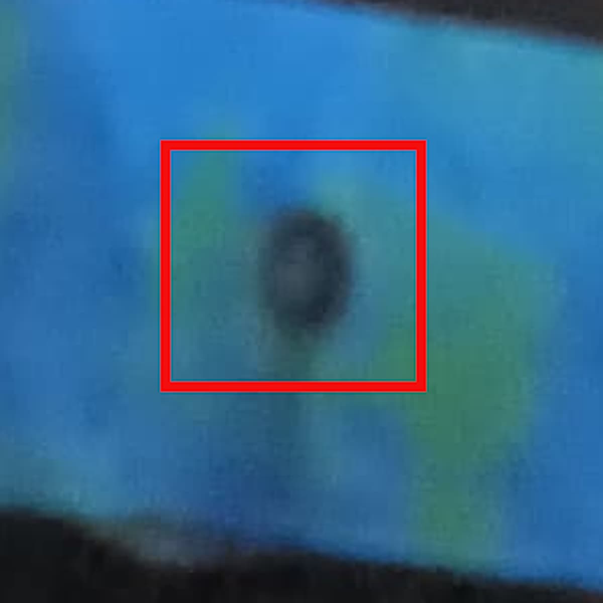

This is one of his first posts of, what looks like m1. There is clearly less power in the center of the mark.

These marks show it’s out of TEM00 mode, hands down… you can’t change this with an alignment.
