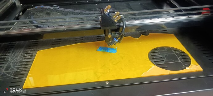

Started to try and align my mirrors. first off all lowered the power to 15% , turned water flow on, tested pulse on flat bed first on plastic, pulse fired ok. set mirror to 1st position and covered lens, pulse fires ok in centre of tape and looked good,
removed tape and taped second mirror, pulse fires but only on first mirror, checked everything again, but still only fires on first mirror, removed tape and tried firing over bed through down pointing laser, and it fires ok, nothing between two and three positions, any thoughts Sam

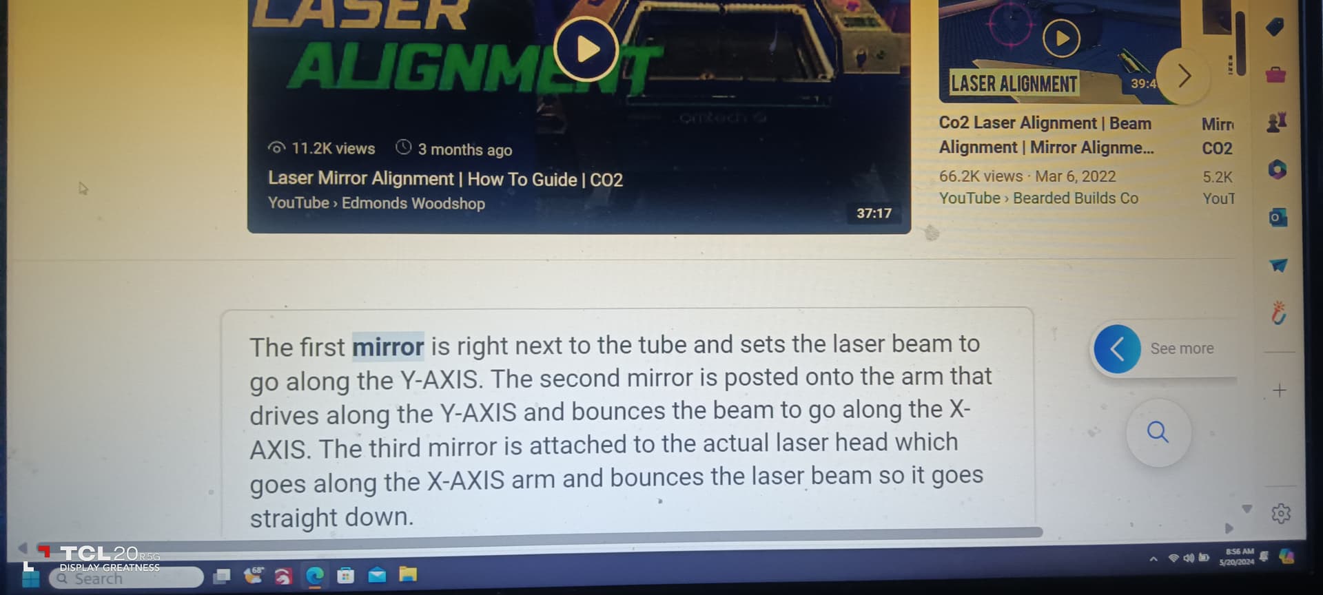

There are many views on you tube at least 100 on how to adjust your laser mirrors, first one being at the exit of the laser tube.
I went through all these procedures and got to this point where i am now… easy if you take a look on youtube, How to adjust my mirrors on my CO2 laser

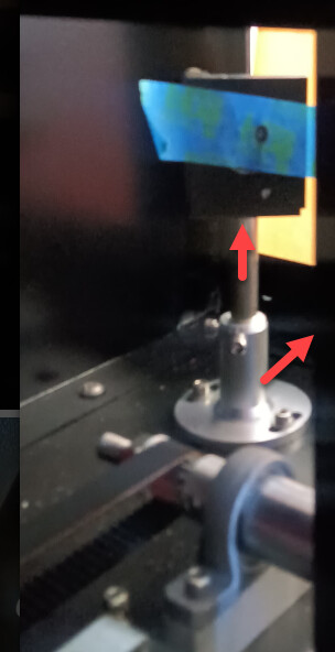

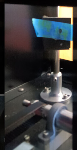

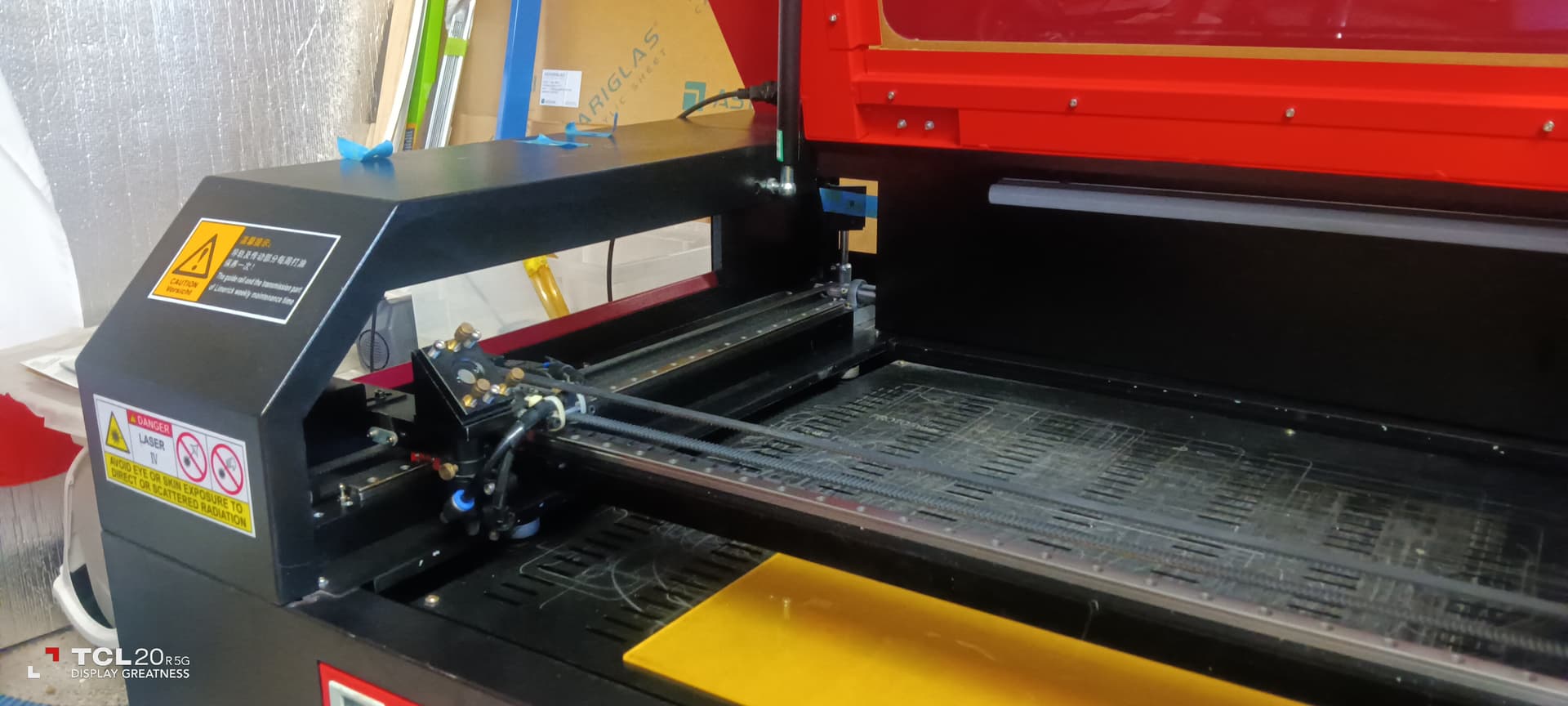

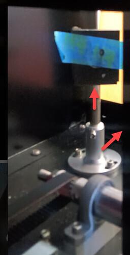

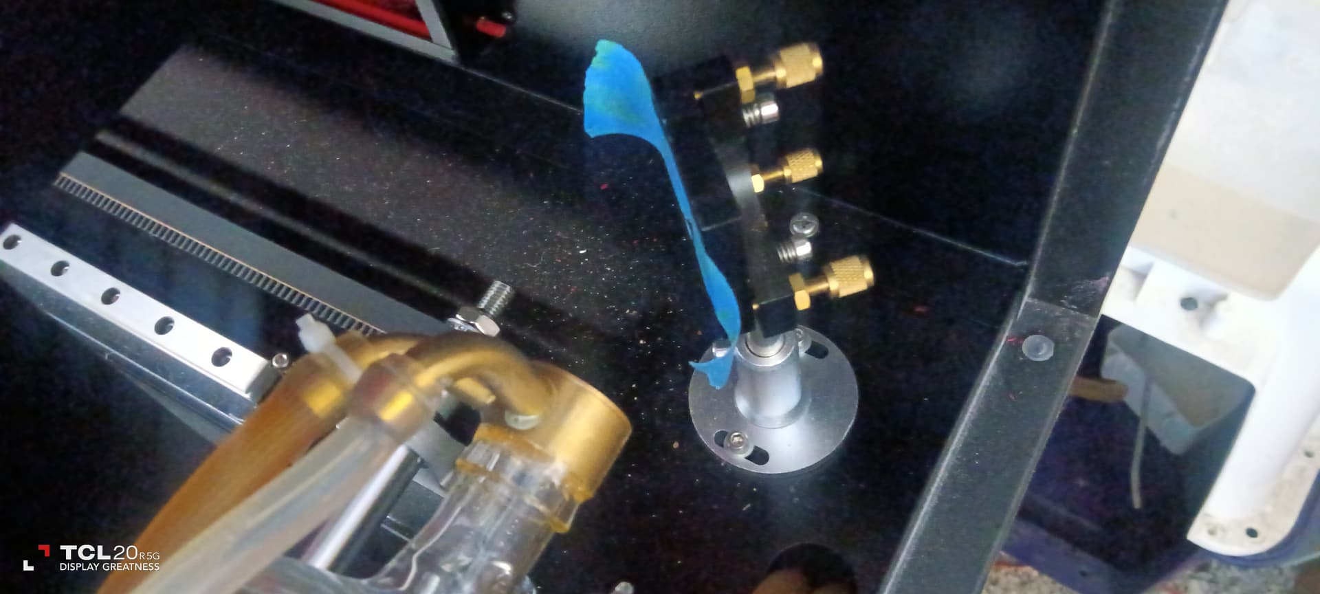

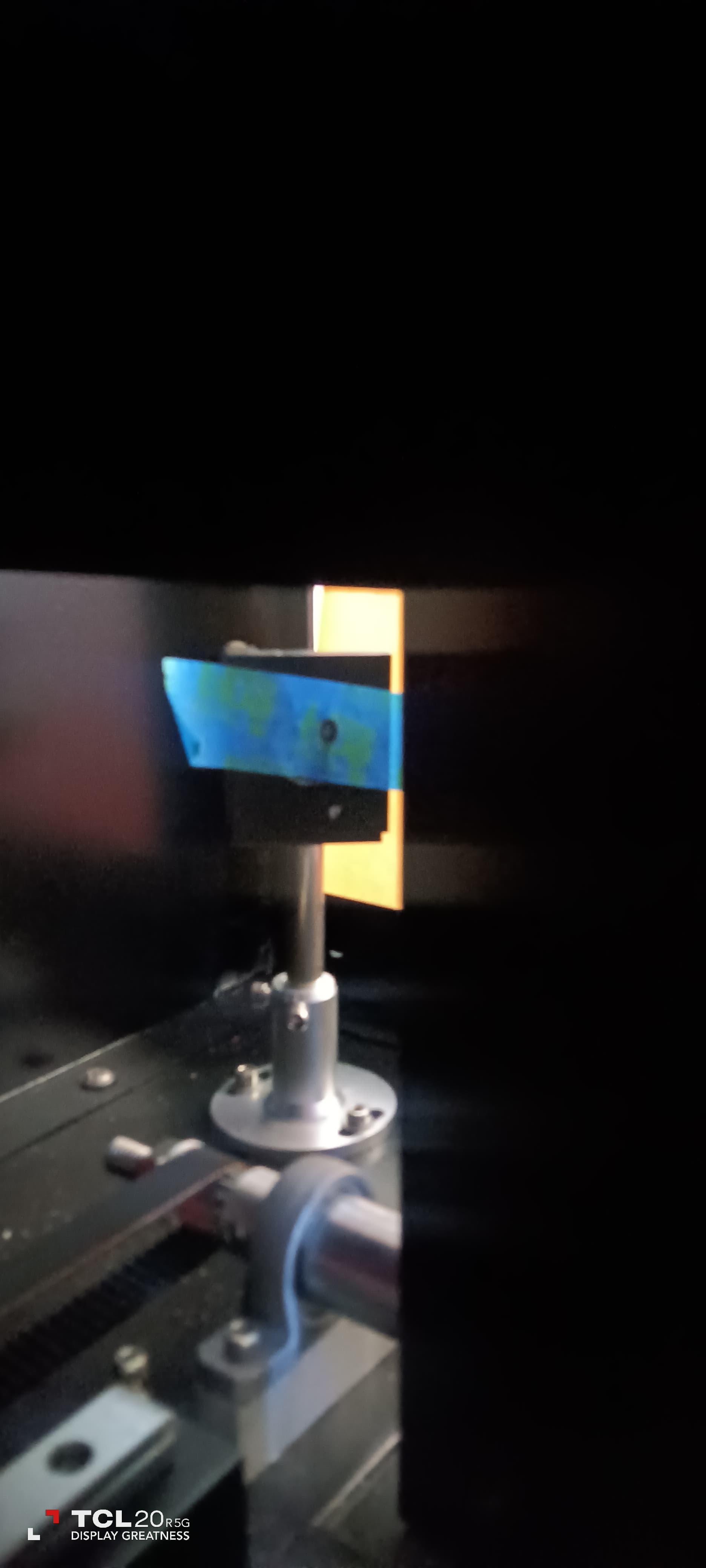

Hi Berainlb… Here are some diagrahms,
Position 1 at the end of the laser tube showing tape on mirror laser fired centre of tape, Good shot where i want it.
Position 2bottom lh corner of machine, laser fired no mark on tape,
position 3 on bed of machine laser fired through all 3 mirrors to laser head and tape marked with fire point.
Point… when laser is fired through laser head a fire through laser is seen on bed, Tape showing Pulse/ Fire hopefully this helps…
When laser is fired through position 1 mark is made on tape
when laser is fired through mirrors 2 and 3 no mark is made on tape, so impossible to adjust alingment from this…
position 2 and 3
What are you referring to when you indicate “position”? Is that referring to position of laser head in reference to the frame or are you referring to position of tape location?
I’m having a very difficult time following your descriptions. Are you able to label the photos?
Also, I want to make sure I generally understand what you’re seeing. Are you saying that you cannot get burn marks on tape located at M2 and M3 but you’re somehow able to get a focused laser out of the bottom of the nozzle? If so, I’m not following how that would be physically possible.
I hadn’t expected you to approach this as a full realignment of the laser. I thought you were going to identify and adjust based on potential misalignment caused by the crashes.
In any case, it’s unlikely that the laser is disappearing. It’s likely just not going where you expect. When testing at M2, place a much larger sheet of paper or something similar across the entire plane that the laser could pass through. Identify where the laser is going other than the mirror. If you still cannot find it then bring the paper closer and closer to M1 until it becomes apparent.

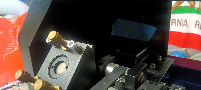

Took all the tapes of the mirrors . shut the laser down and it reset smoothly back to its homing position with no problems or noise, sensor light came on in home position, so i know its sitting in right spot.

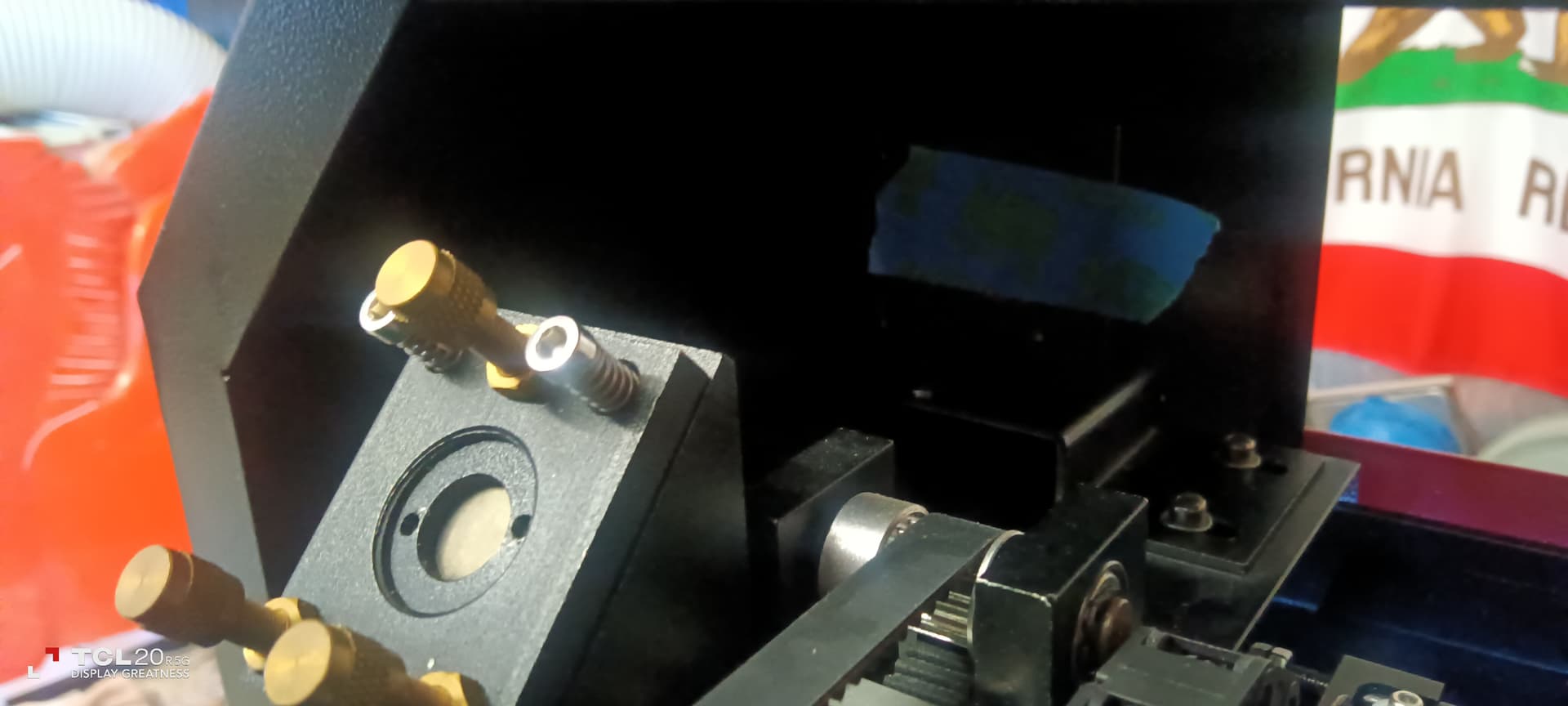

Hit the pulse button to see if it still fired, and it fired on the first mirror at the end of laser tube. I haven’t seen this before, a pulse, laser beam on the mirror itself, Very confused, moved laser head to Centre of bed and tried pulse again and it fired a pulse on the first mirror…
Does your first mirror still look like this?
If so, then if I was aligning this I would move the mirror slightly back and also up a smidgeon to get the burn in the middle;
Although…if you are already getting a burn out of the nozzle, it might be better not to start a full alignment - since once you start realigning the mirrors it’s is opening a whole new can of worms!
Desperate to fix it, almost there but not quite, have to replace two sensors on x and y axis, waiting on delivery, i will take your thoughts
Back off the power for alignments and setup. If you blow a hole through the target, it burns away most of the relevant information.
Are you sure you’re tube is running in TEM00 mode? The targets appear to look like a doughnut.

I this perpendicular to the tubes output or is this on a 45 deg angle?
hi Jack this was perpendicular to the tube
