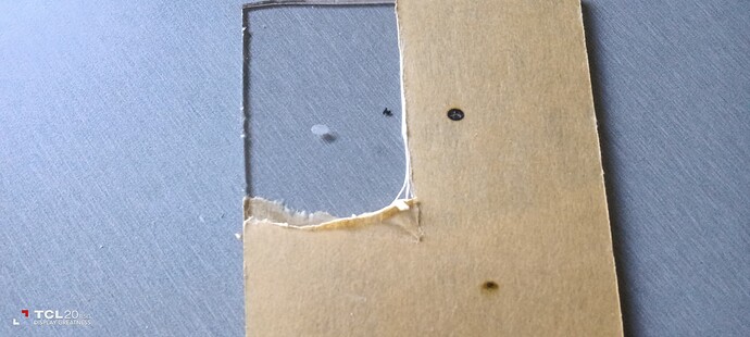

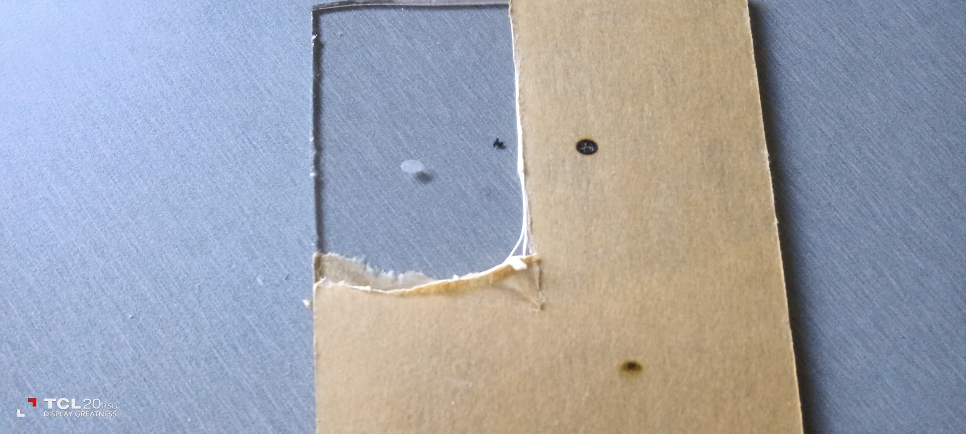

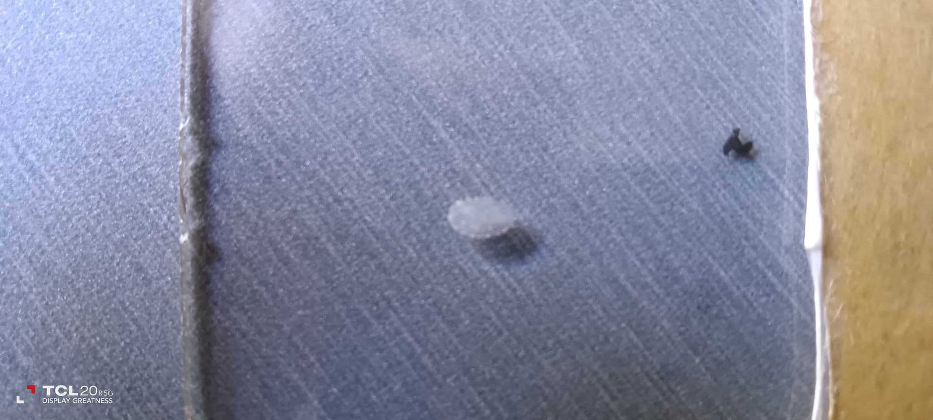

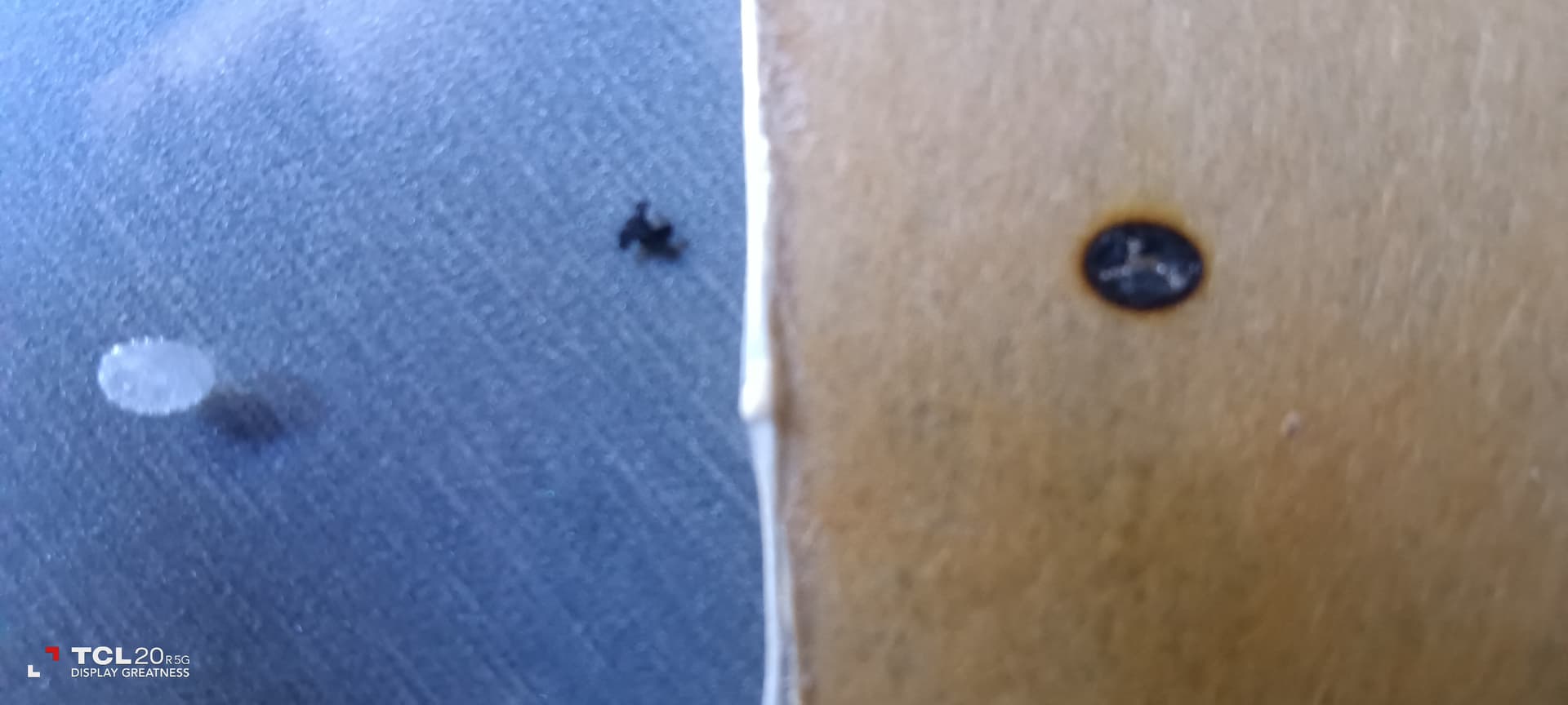

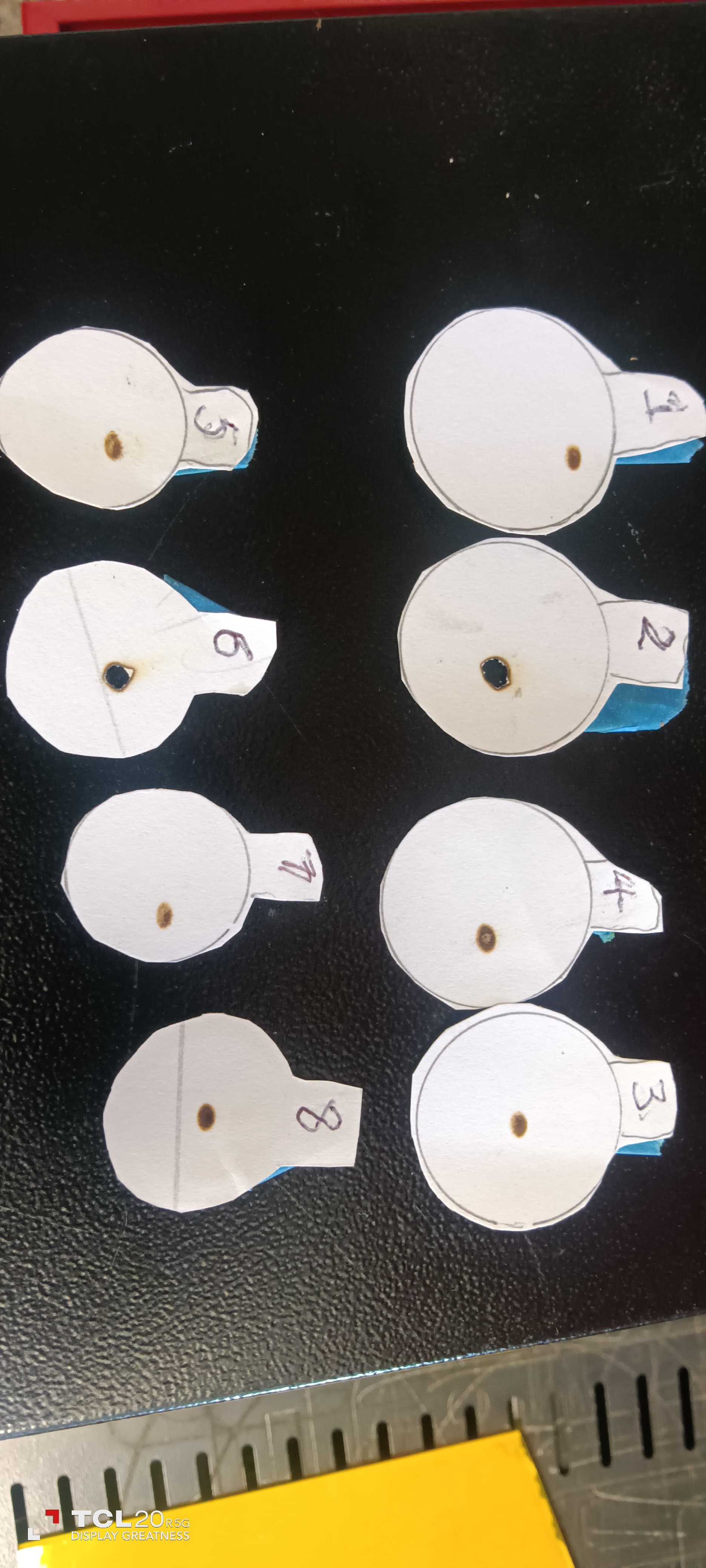

I’d expect it to be round, not oval…
Can you do this again, with less power. Keep the middle from being black…
You want to see the power distribution within the beam…

Hi Sam,
How is your mirror alignment going?
If these are from mirror 1 then they all look fine apart from number 1 & 7.
Have you started to burn targets placed at the 2nd mirror?
Move the Y axis/gantry to the back so the first two mirrors are close together for a start and use a bigger target at mirror 2 (to start with), then as you dial in the fine position of mirror 1 you can start to move the 2nd mirror further away, until you have the burn in exactly the same spot when the 2nd mirror is close and at max distance away.
I personally like to use a small square of clear acrylic as my target medium, it usually is 3mm thick and large enough to cover the mirror and beyond so I can blu-tack or double sided tape the mirror to the black mirror surround, that means the mirror won’t require cleaning afterwards and I can get quite a number of pulses in before I need to replace it.
If I don’t have any clear acrylic on hand I’ll use a nice wide masking tape but place a new piece over the last piece so it wont burn through as much, putting a new piece on when it gets a bit hard to read where the last pulse went. I keep doing that until I cannot easily see the circular indent of the mirror position showing through the tape.

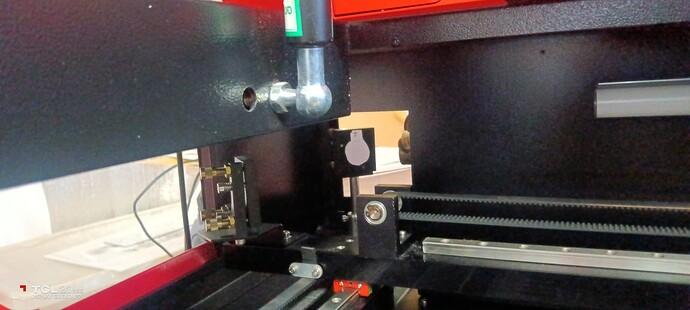

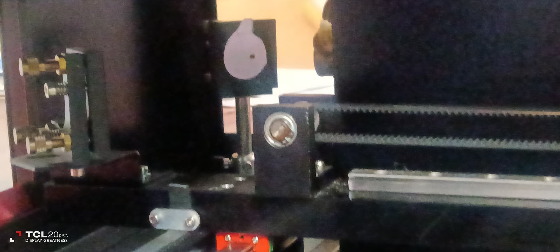

Hi Nicholas.
I have been communicating with Jack Wilborn, he wasn’t happy with the first results i sent him he felt the laser holes were more like donuts and asked me to do it again so this is from this morning’s effort, my feelings are they still look oval not round round, the power was set at 13%, I tried lower but the laser would not pulse at the lower power.
I haven’t started to burn targets at the 2nd mirror yet as I was waiting for Jack Wilborn’s comments on the oval shape the laser is burning. I am nervous at this stage as the whole repair of this Laser has been ongoing for 3months now and i don’t want to go backwards. I am waiting on 2 new sensors coming from the U.S. as they were damaged when the laser crashed into them and knocked them on an angle, that problem is now solved and we can now move on to the Mirror alignment
I do have some clear 3mm acrylic and I can do another test today I will place it on the first mirror and burn so you can see where i am and check the holes if they are round or oval.
I will do this shortly and post my results for your comments. thanks for your help. Sam
Don’t be nervous, the burn spot looks fine enough to me, sometimes they are a bit like a donut until you increase the power.
Is that with the acrylic square on directly in front of the tube? If so it does look a bit oval but could be worse, so since there is not much you can do about it you may as well continue with the alignment and see what the spot looks like by the time it gets to mirror 3, and then see what sort of power you get when cutting.
Hi Nicholas … I put two large pieces of tape at the second mirror and moved the laser to the lower lh corner and fired a pulse, nothing happened, then moved the laser to the top lh corner near the laser tube and fired a pulse, still nothing, removed the tape and put it over position 1 and fired a pulse and got a burn mark… what now
Make sure mirror 1 is clean, and put a large piece of cardboard in front of mirror 2 in top left hand corner. The laser has to go somewhere.

Hi Nichlos … A BIG THANKS TO YOU MAN. I CLEANED ALL THE LENS WITH ISOPROPYL ALCHOL AND… WOW IT FIRES ON ALL LENS IN THE MIDDLE… READY TO MOVE FORWARD BIG THANKS TO YOU… SAM
