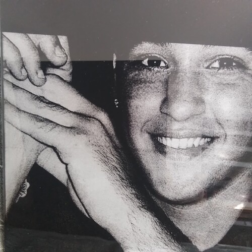

on my 10w I put speed 5600 and 100% power
watch Benmaker’s excellent tutorial on youtube.
small example, the photo does not render many reflections well, but in real life it is impeccable, I used black gpuache, applied with a foam roller, 3 layers, dried with a heat gun, speed 5600, power 100%, line interval 0.08, 312 dpi, point width correction 0.04, no overscanning
Offset fill is likely the problem, because the spot will follow each of the lines. Because the head must speed up and slow down for each change in direction, it’ll take much longer than a simple Fill scan across the entire image at full speed.
In general, Offset Fill is better for large, simple regions:
