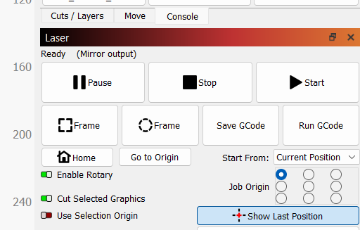

Hello all I have somehow managed to have put on the Mirror image and can’t turn it off please see screen shot. I have tride uninstaling Lightburn and looked at the settings but I can’t find out how to sort it out. Thanks Daryl
You need to turn off the rotary (below the home button in your screenshot).
