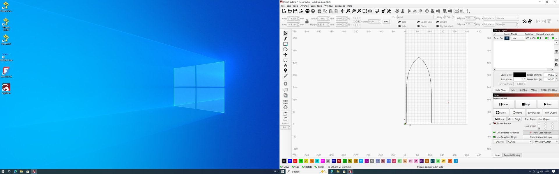

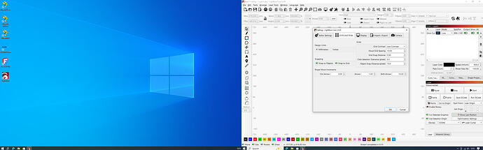

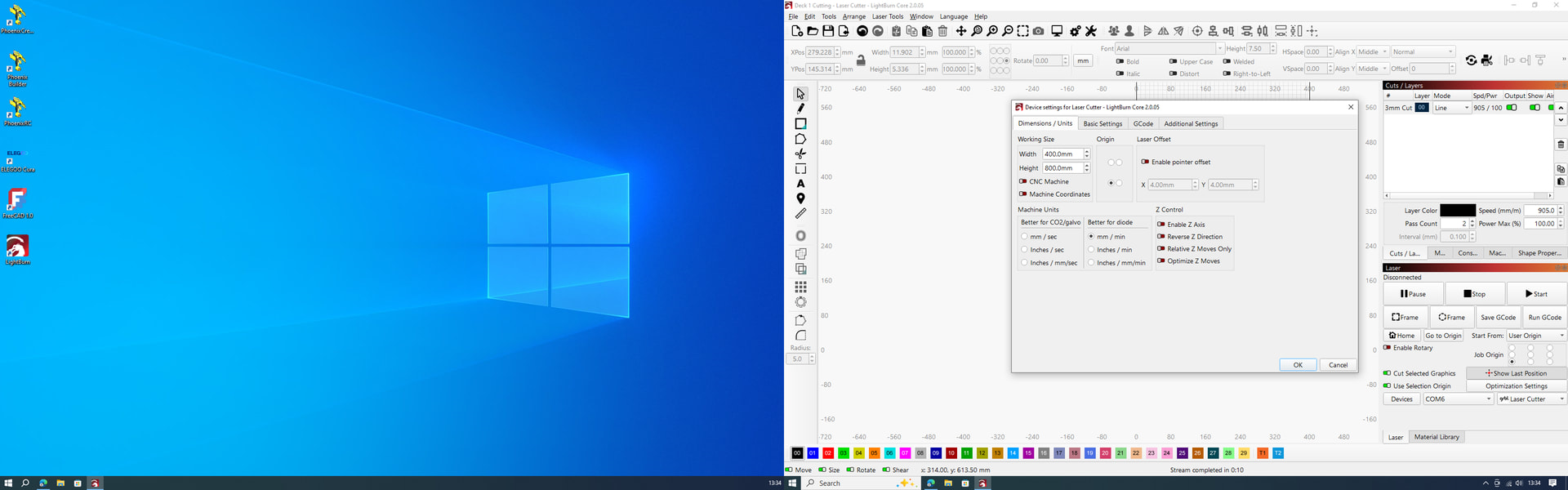

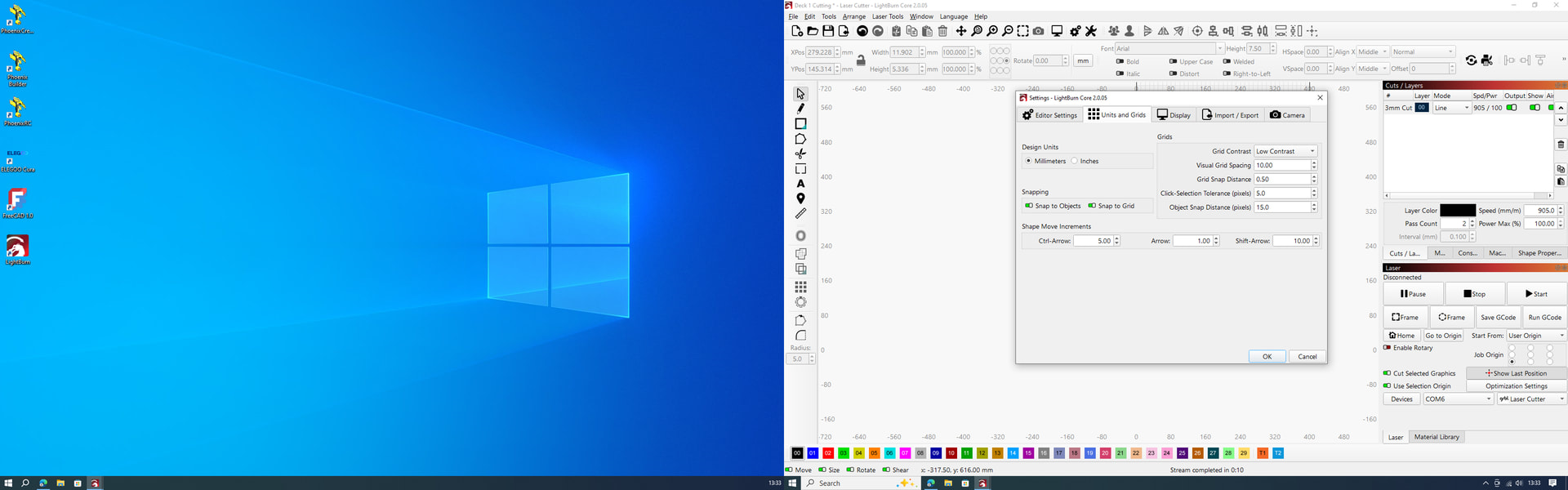

Let’s see if we can figure it out. Please post a screenshot (not a cell phone pic) of your entire Lightburn screen with your project loaded and the Cuts/Layers Panel and Laser Panel visible. Also post a screenshot of the Settings Window (Gears icon) with the Units and Grids tab visible and post a screenshot of the Device Settings Window (Wrench and Screwdriver icon).
Hope this helps
I don’t see any text in your project.

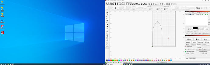

Post a picture of the laser after homing.
Did you add the extension or buy it that way? Does the laser orientation match the screen or is it rotated 90 degrees? Did you enable the swap x y axis button?
I added the extension about 18 months ago when laser was new.
But I have never used the full capacity.
I did used to print text ok.
But I had some issues a while back and may have pressed something I shouldn’t have.

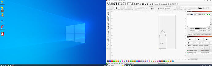

Now you mention it, on the work area the drawing is lower left, but the cut by laser is always lower right. I am unsure what you mean by swap X Y button, however I think you may be heading in the right direction. New picture as requested.
So the graphic as shown will print aligned to the right side?

Now we’re getting somewhere. In the Laser Tools Menu select Machine Settings, then Outputs Setup, answer yes to the warning. On the bottom click save to file. This will give us a backup of your current settings. Then toggle the X Direction Pin Invert and click write. Test the arrow direction. If correct, test your file.
