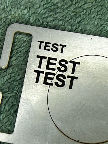

When I am engraving, I notice that there are missed lines in the text that have not been engraved, they follow the hatch direction. I also use crosshatch and it is still there. I engrave stainless steel and within all the text there are these silver lines. Any ideas. I used a 0.001 hatch.

Bigger hatches dont give the depth and colour need in a single pass for a time sensitive process. It looks like it is missing completely. I will try and get a photo later. This is a new laser 100w MOPA. I have used a 30w for 5 years and had it dialled in perfectly but now I have Q pulse and higher frequency range. I am trying to get black text that is engraved rather the annealed, run time is important. Just figuring out the relationship between speed, power pulse and frequency in the one.

Yeah it was a bog standard Raycus. I was using a 63mm lens on the old laser, much better clarity and intensity compared to bigger lenses. I have a 160mm on the new one. I have just hit the sweet spot. Lower speed, hight pulse and lower frequency than I was using. I will post some pics later

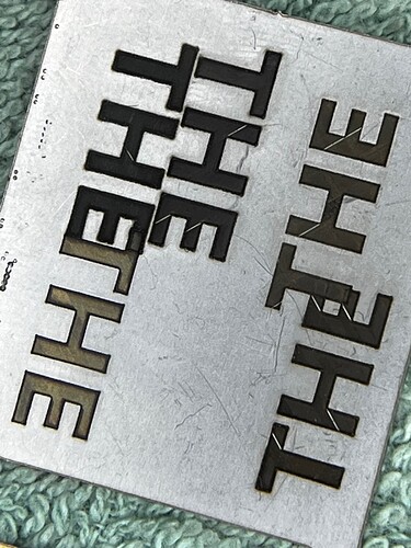

The smaller lenses are great but very little space to work. The pictures are not great as the text is small but you will see the issue. with the right settings the lines are still there but less visible. I just wish I knew the reason.

I don’t seem to see the lines in the test photos…
Are you running a 45 degree hatch?
On the picture with THE. Its the 45 degree lines in the text that look like scratches. You will see 2 lines on the E. It shows its not just a random location, its the same location on each burn of the text no matter what setting.
Have you walked this through the preview to see if it thinks these are there?
I agree, same place, looks programmatical…

Good news, I have found the culprit. Its the flood fill and the way in which shapes are filled. Obviously flood fill have a huge affect on quality. Not a single line now and the text is really good colour. Just need to tweak the power and speed to get the time down a bit, Turning off flood fill increased time by 25%.
