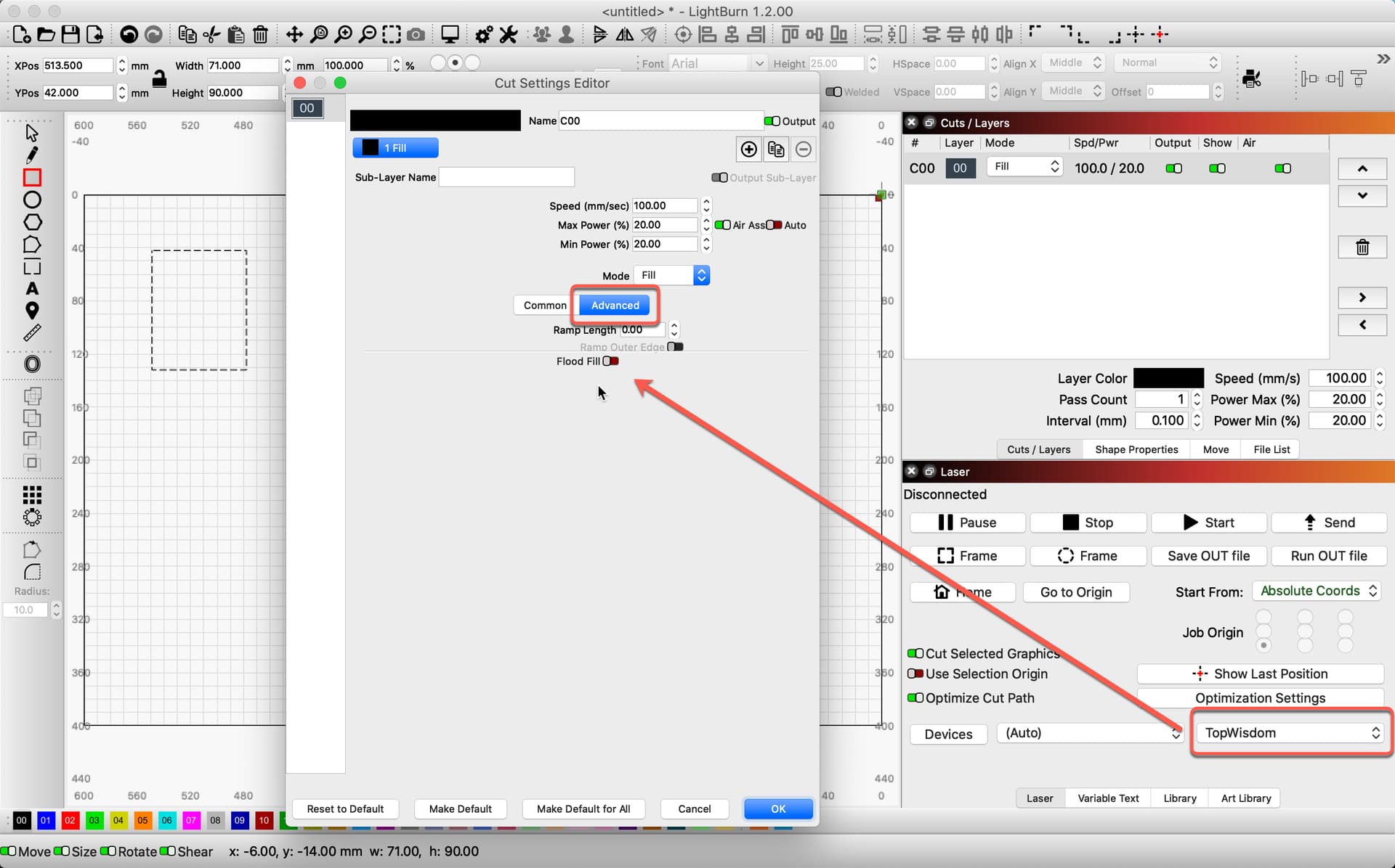

I’m trying to change a few settings on my machine and I seem to be missing a variety of buttons. I am not set to beginner mode and I’m using a top wisdom controller I don’t know if that matters. So far I can’t do the following:
. Read time settings from the machine for time preview
. Fast white space scan is missing
. Flood fill is missing
I would appreciate any help I could get this one starting to get me a little stuck. By the way this is on both Mac and PC.
I don’t believe either of these are available options for Top Wisdom controllers.

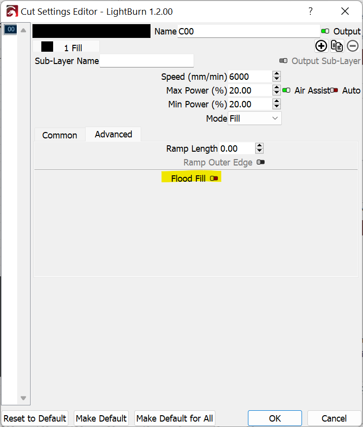

This option should be available. Check under Advanced tab for a Fill layer.
its missing.
Odd. Can you confirm that your base mode is set to “Fill”? It won’t show up for line and not available for offset fill.

OK, it worked. But it’s a no go on the other problems?
like @berainlb told…
