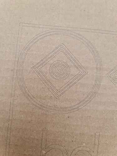

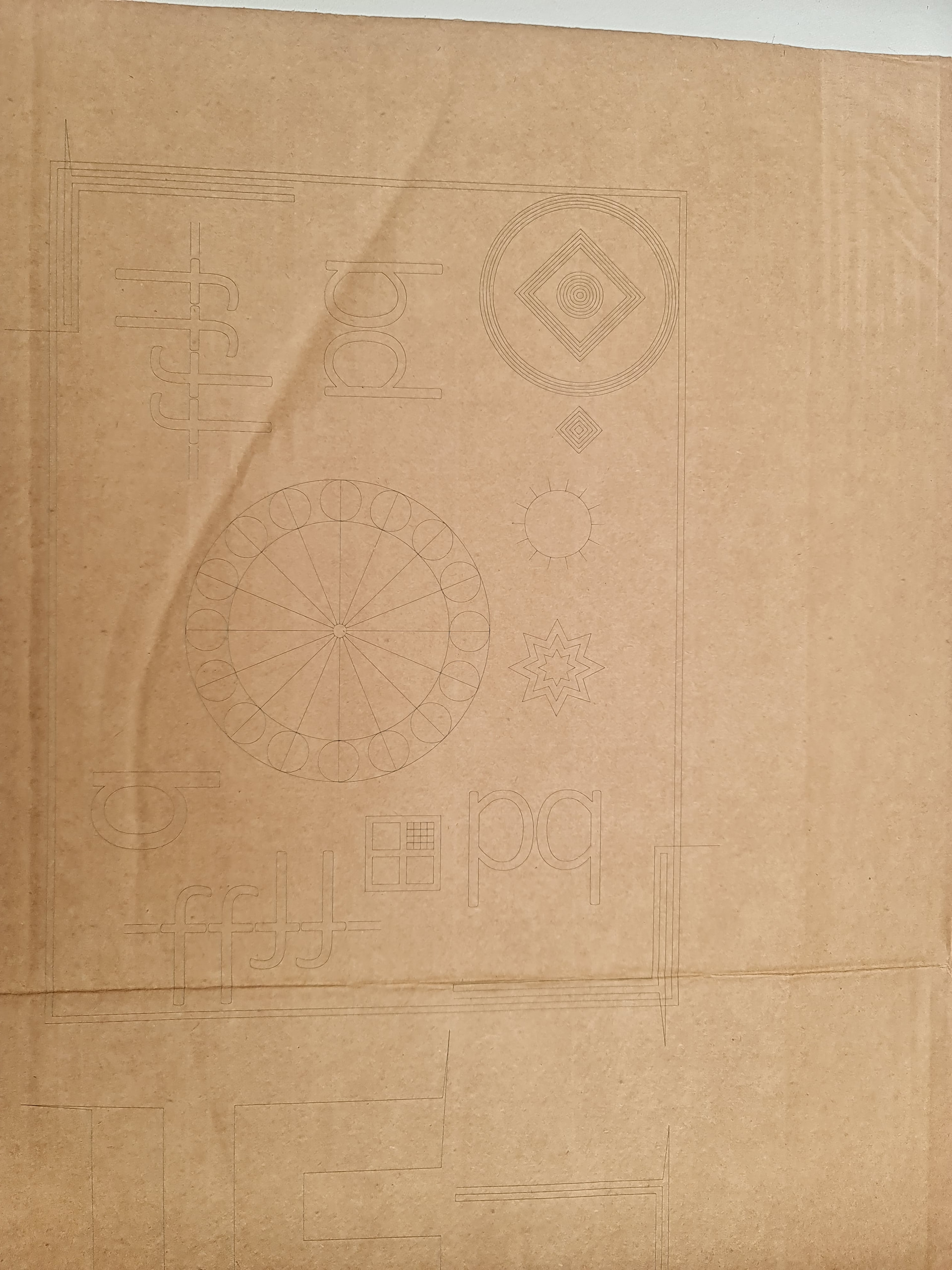

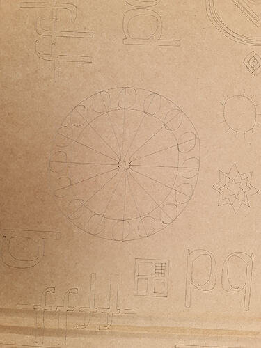

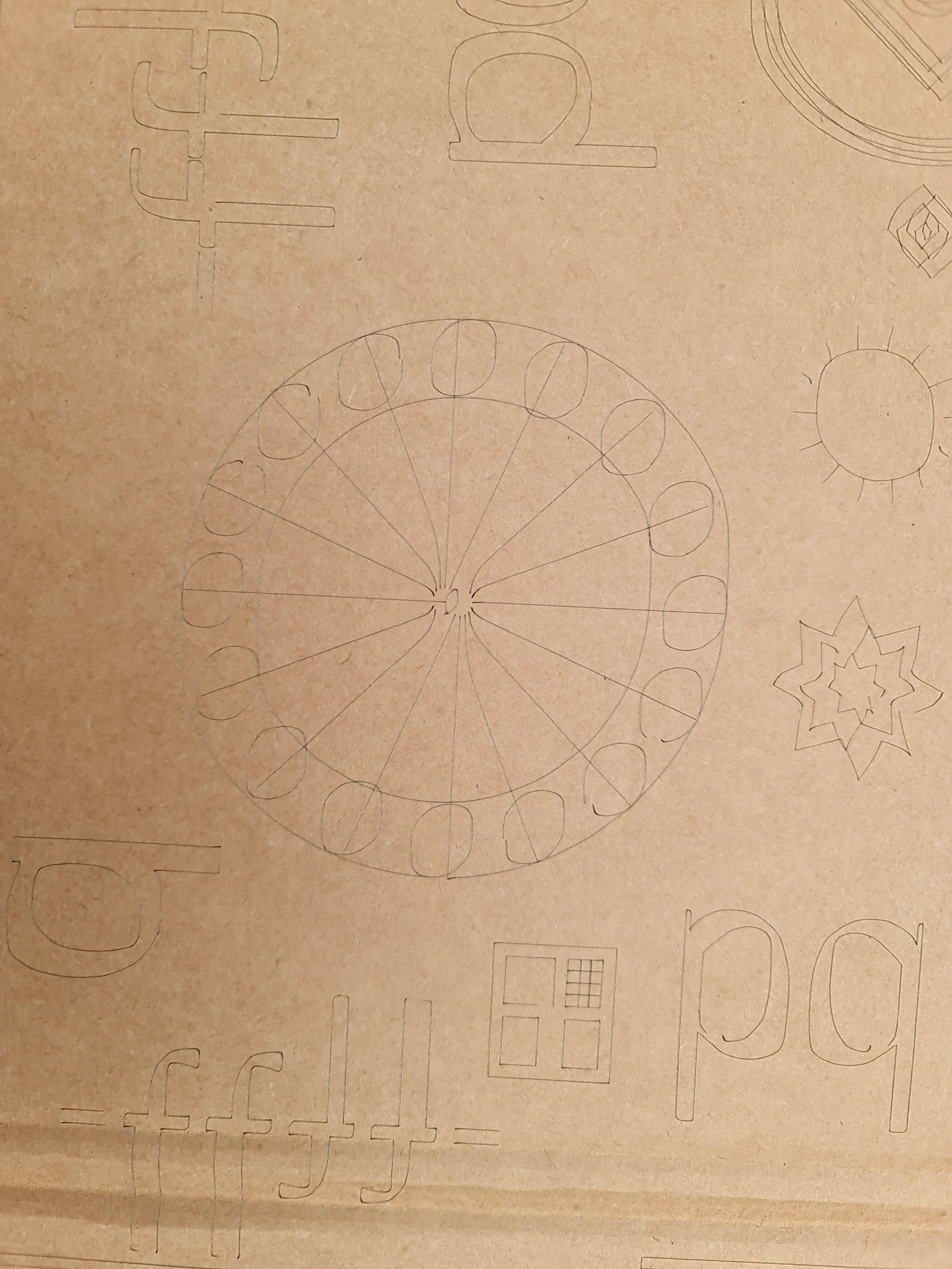

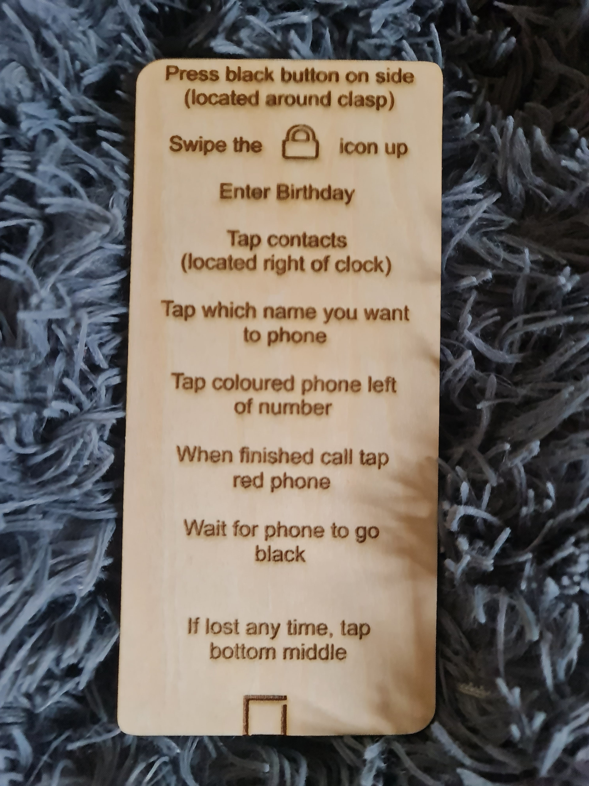

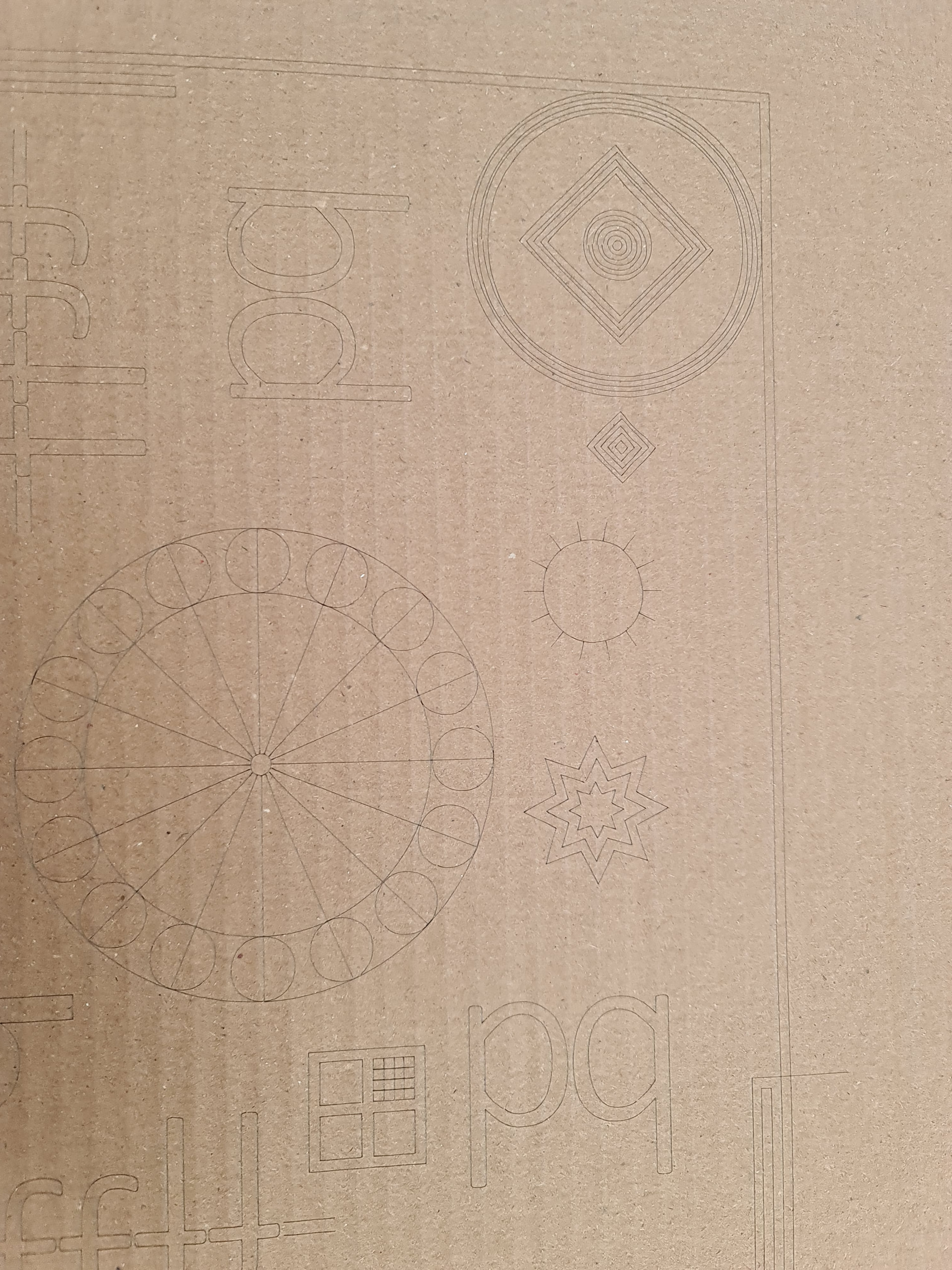

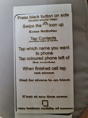

Hi all, probably a very simple issue, but new machine, new user. Excuse the subject matter, long story short thought i’d start with text, instructions for elderly person to use phone on something they cant lose. Anyway, I tried to include symbols along with the text, and suspect that is causing my issues. First try i did lines of text, each one a separate entity, and outlined icons, put them in. Came out with a lot of letters fine, but some with squidged lines.

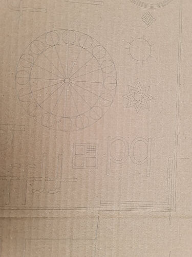

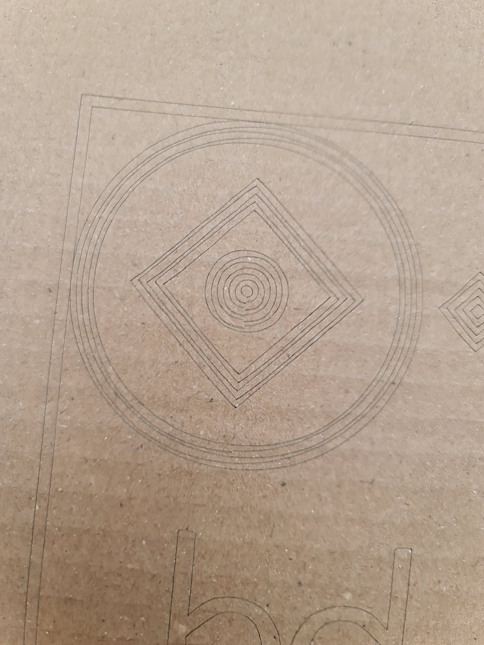

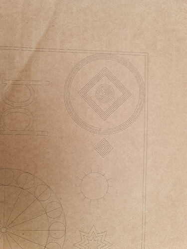

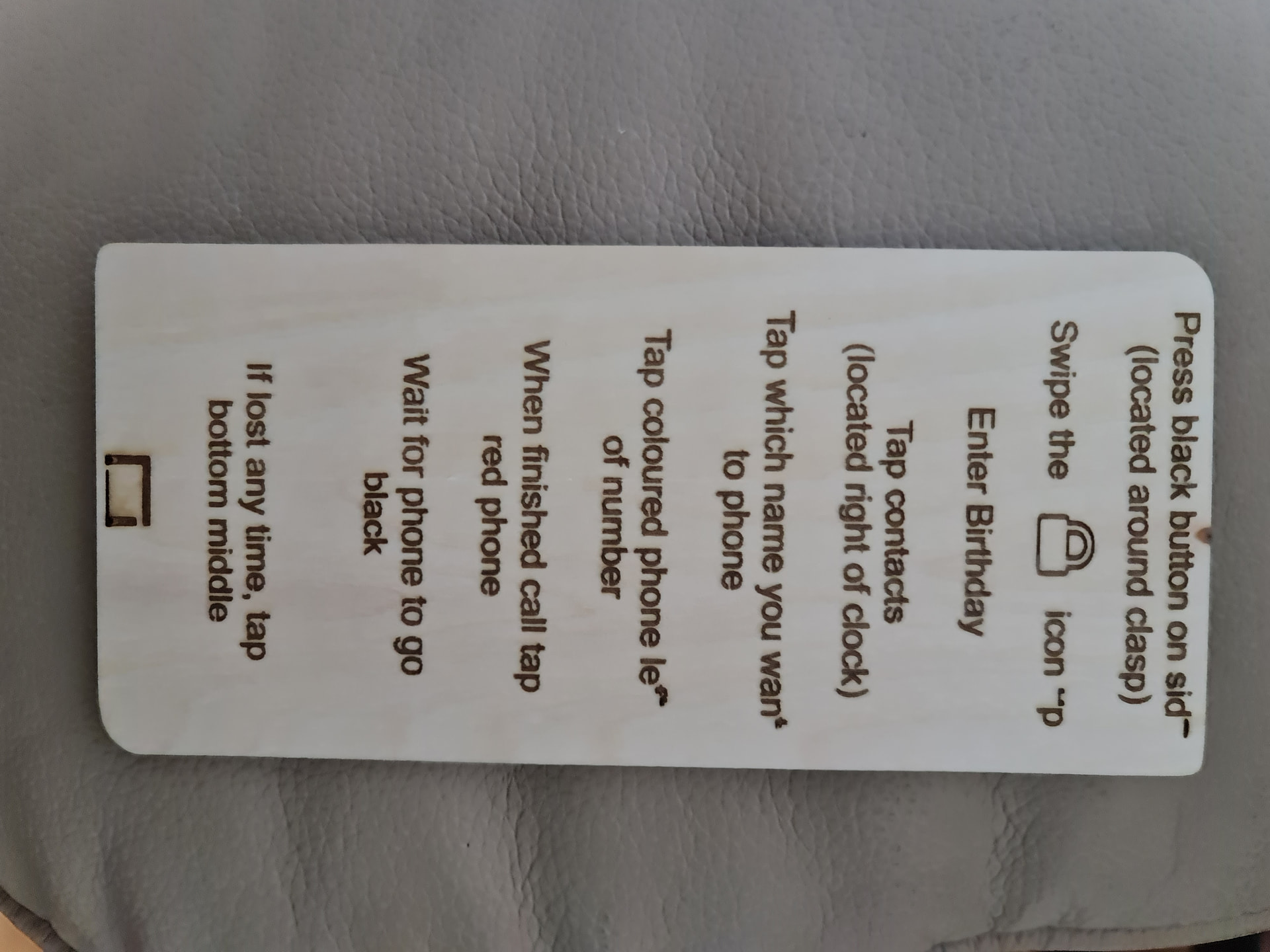

I suspected down to overlap issues, so formatted all the text in one, and tried to leave space for the symbols. I also googled and saw for text issues that i should right click and something path. Also that i should boolean unite, and/or weld. I cant remember if i welded, but couldnt boolean unite. Second attempt came out better, but parts of letters missing. It started engraving at the extreme right, before switching to the bottom.

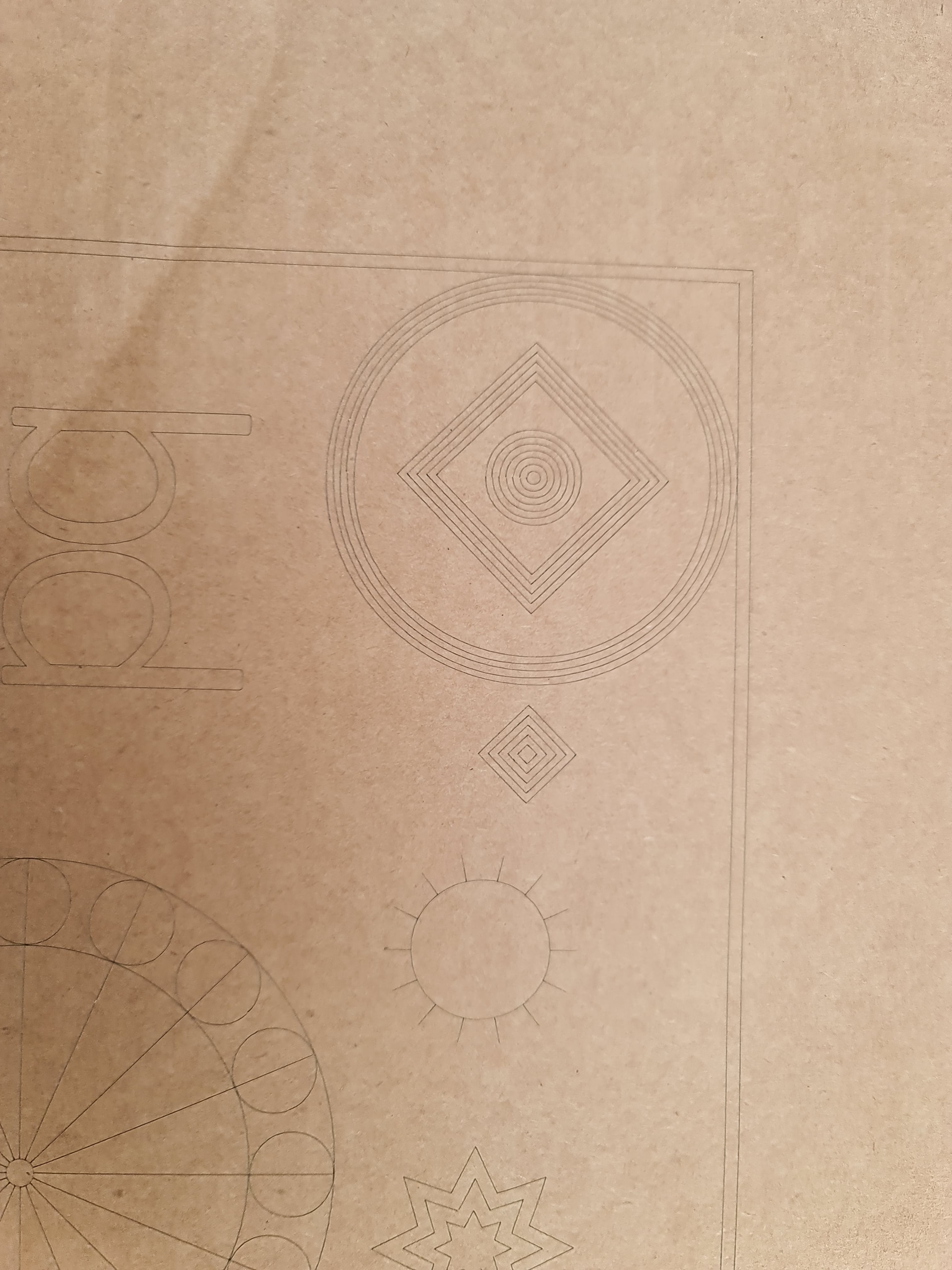

First try started engraving in the middle.
Its probably something very simple i’m doing or not doing, but any pointers would be greatly appreciated, missing letters dont seem to have many fixes on google. Thankyou in advance
At first glance it looks like a mechanical problem. Something loose. I would start by checking the tension of the belts and the tightness of the bolts on the stepper motor pulleys.

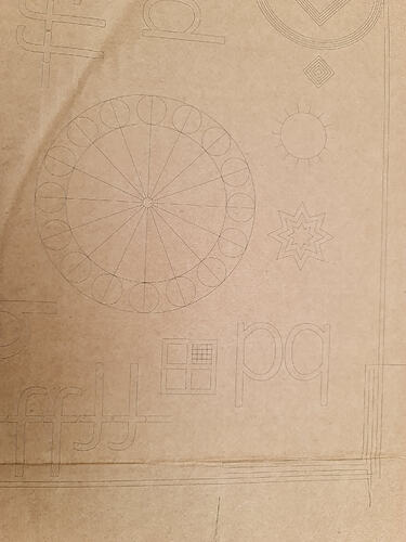

I checked the mechanicals and everything seemed tight, so I ran it again, this time it started from the bottom and all looked to be good, up until the same letters firstly missed, then picked up on the way back down, again distorted. So I moved the text inside the project and found the letters that had been distorted were left behind, I guess I missed them during the welding. I’ve fixed that, and running the project again. I still dont really understand how that would have been an issue as they werent distorted in the project, or the preview window. Will post soon if this try is successful. Thanks
The latest cut with finding that I hadnt grouped the subsequent letters, and welding those, has fixed the letter issue. The surrounding cut though seems to be offsetting. I will include the original file, and the newly welded file. Apologies in advance if its something simple I’ve done/not done. Thanks, Bryan phone structions.lbrn2 (264.8 KB) phone structions welded.lbrn2 (285.7 KB)

Your original photo looks more like a mechanical problem as the squashed lines seem to be immediately following rapid movement. Your second photo, with the missed letters is something different though. Were you possibly engraving the letters individually here?

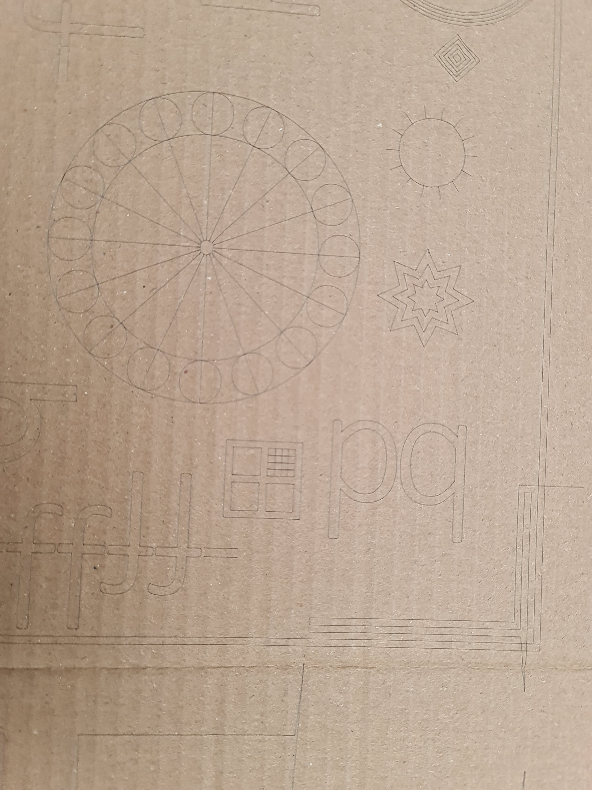

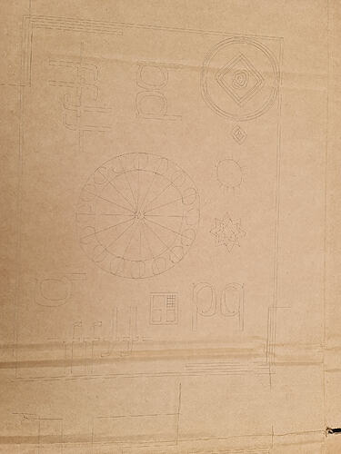

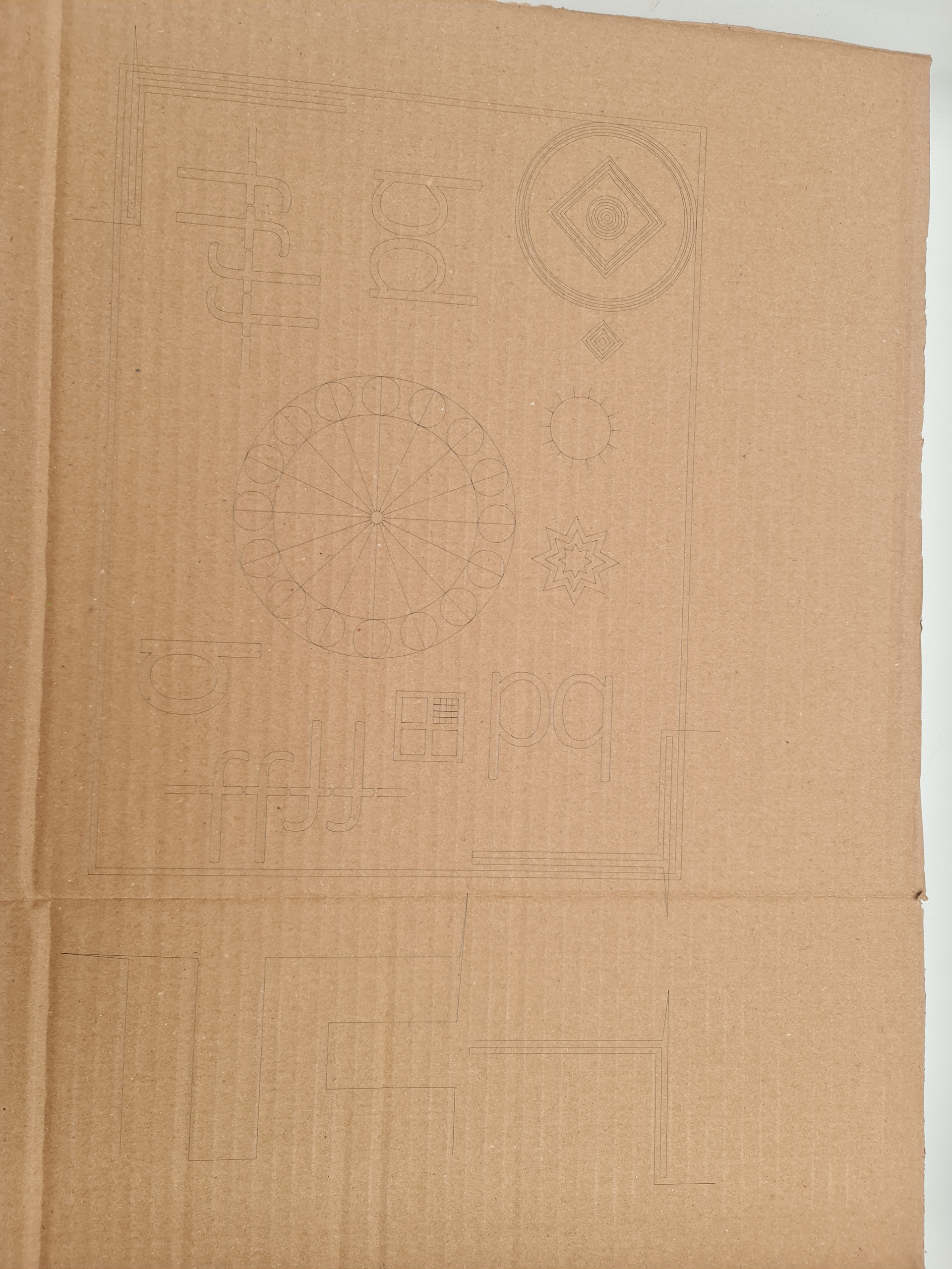

Just for kicks, let’s try to eliminate backlash issues. Load this file, scale it proportionately to fit your bed, turn off optimizations, and run it at very high speed with just enough power to get a good mark on cardboard. Any discrepancies from the file will indicate mechanical problems. Upload a photo of the results so we can look with you. BacklashTest.lbrn2 (68.8 KB)

First go (first picture) i had each line of text as separate entities, and the clipart symbols on. It came out with squashed lines, so I assumed something to do with overlaps. A google amount of time later, for missing letters or squashed lines it said convert text to path and weld all. This I did, which led to pic two.

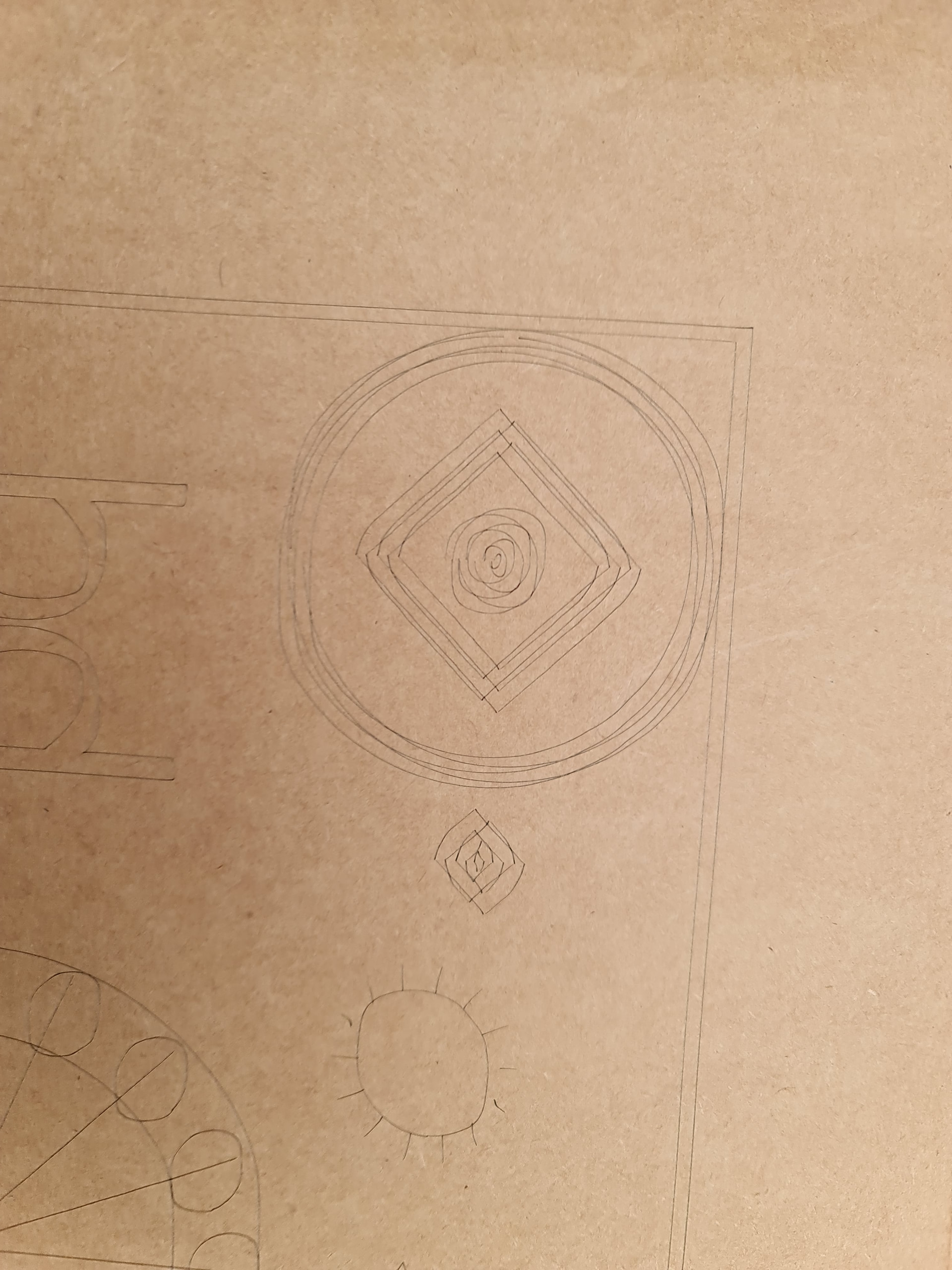

Try two came out with most fine, (first file I uploaded as I had modified the first file) except the end letters on certain lines. I wrote here, then checked everything was tight, ran the file again, same again. So checked the file, and discovered I had missed the end letters when I welded. So I corrected that (file 2 i uploaded) and ran again, fixed the issue with the text. However the outline cut seems to be moved relative to the text. I also noticed on each cut, two (diag opposing) corners have the correct radius, and two dont.

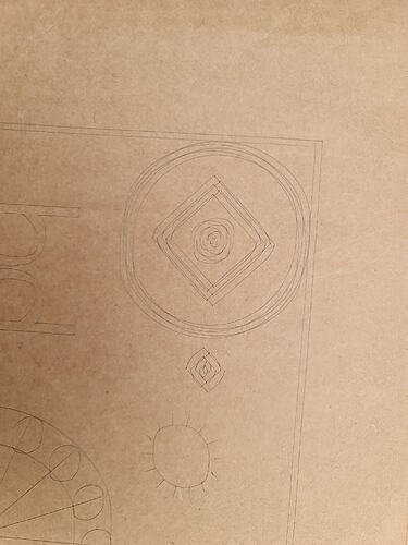

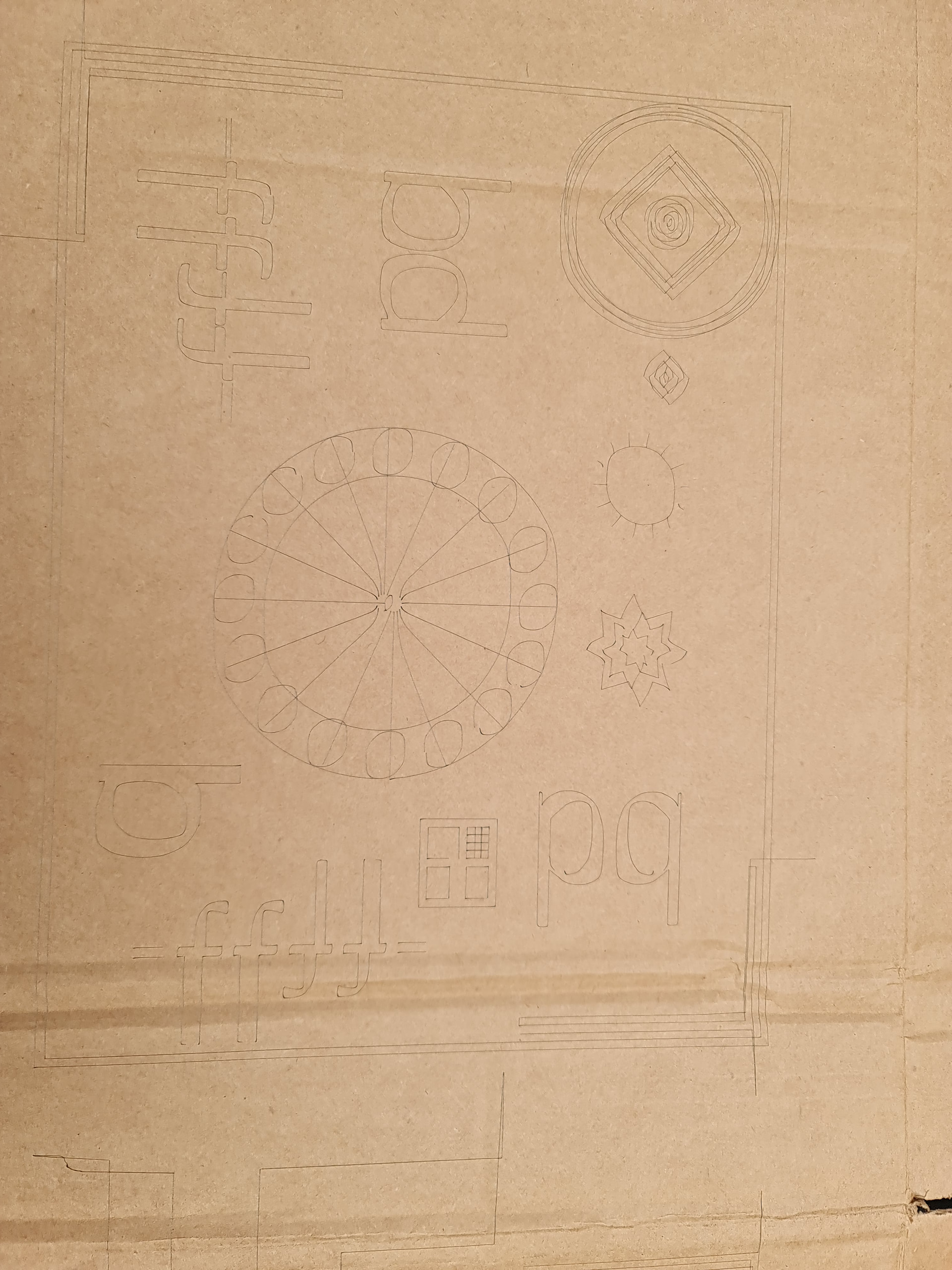

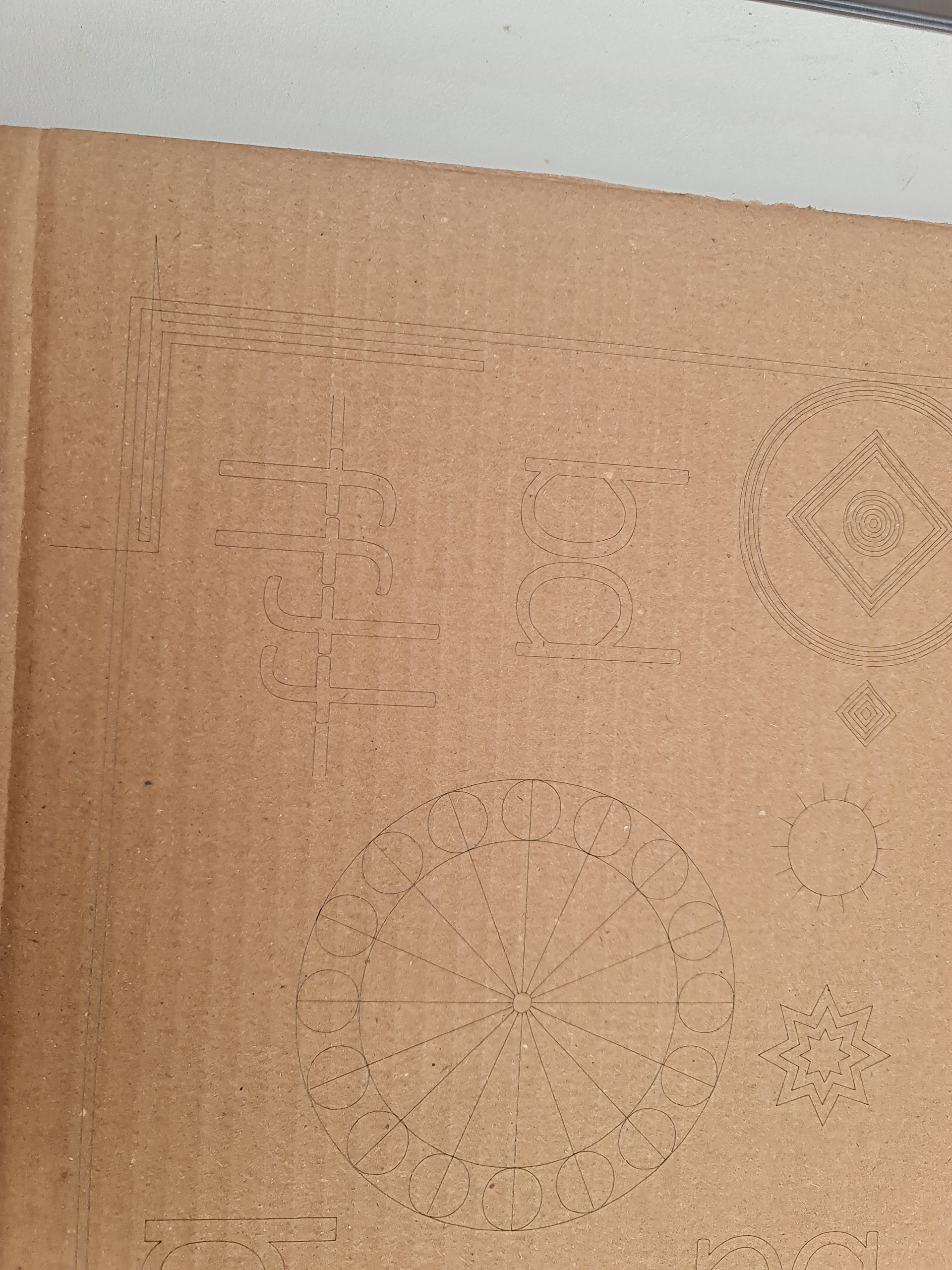

It took a bit of tinkering with speeds and powers to get a mark without burning the place down. It ended up 7500 at 75%. Not sure if the figures are relevant.

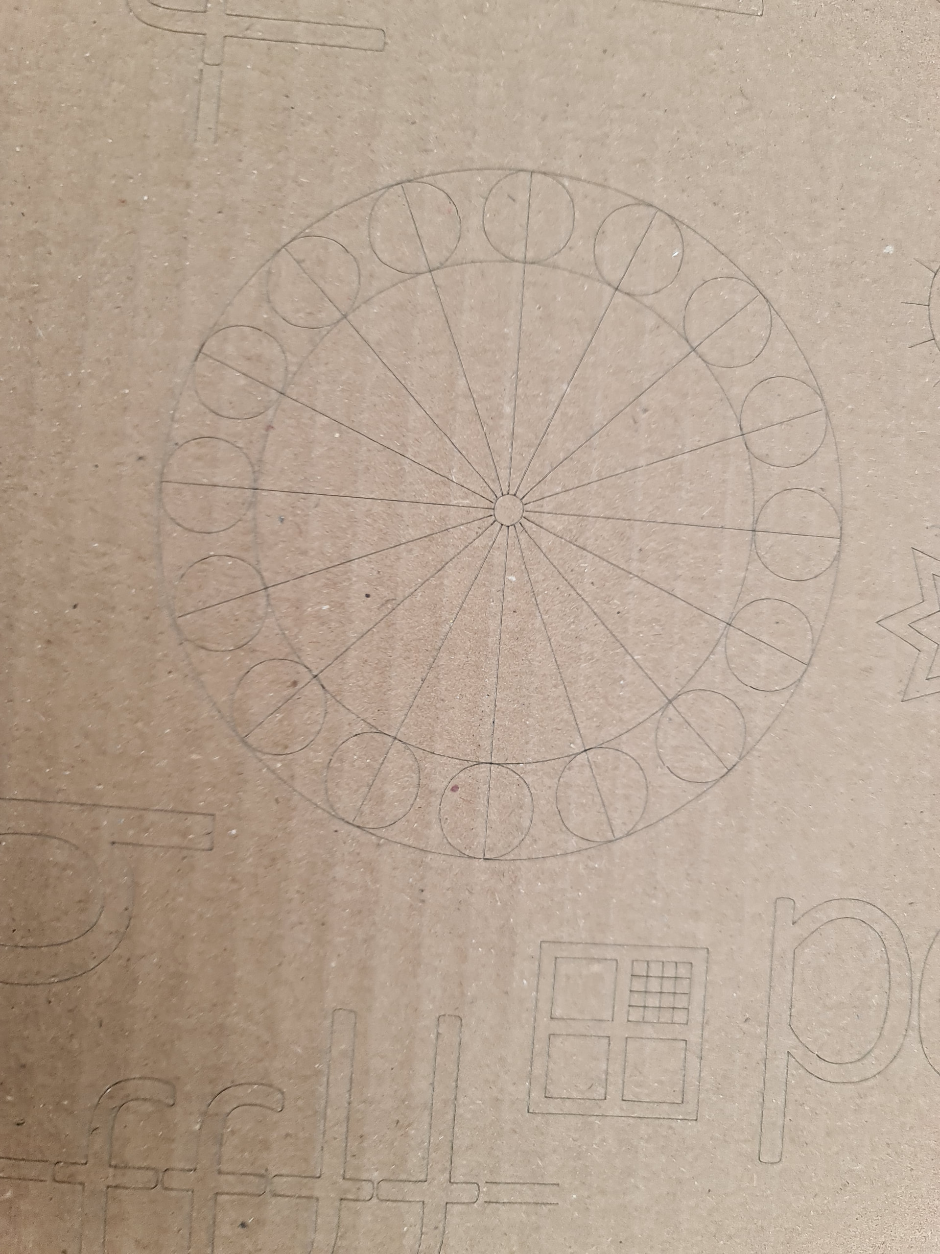

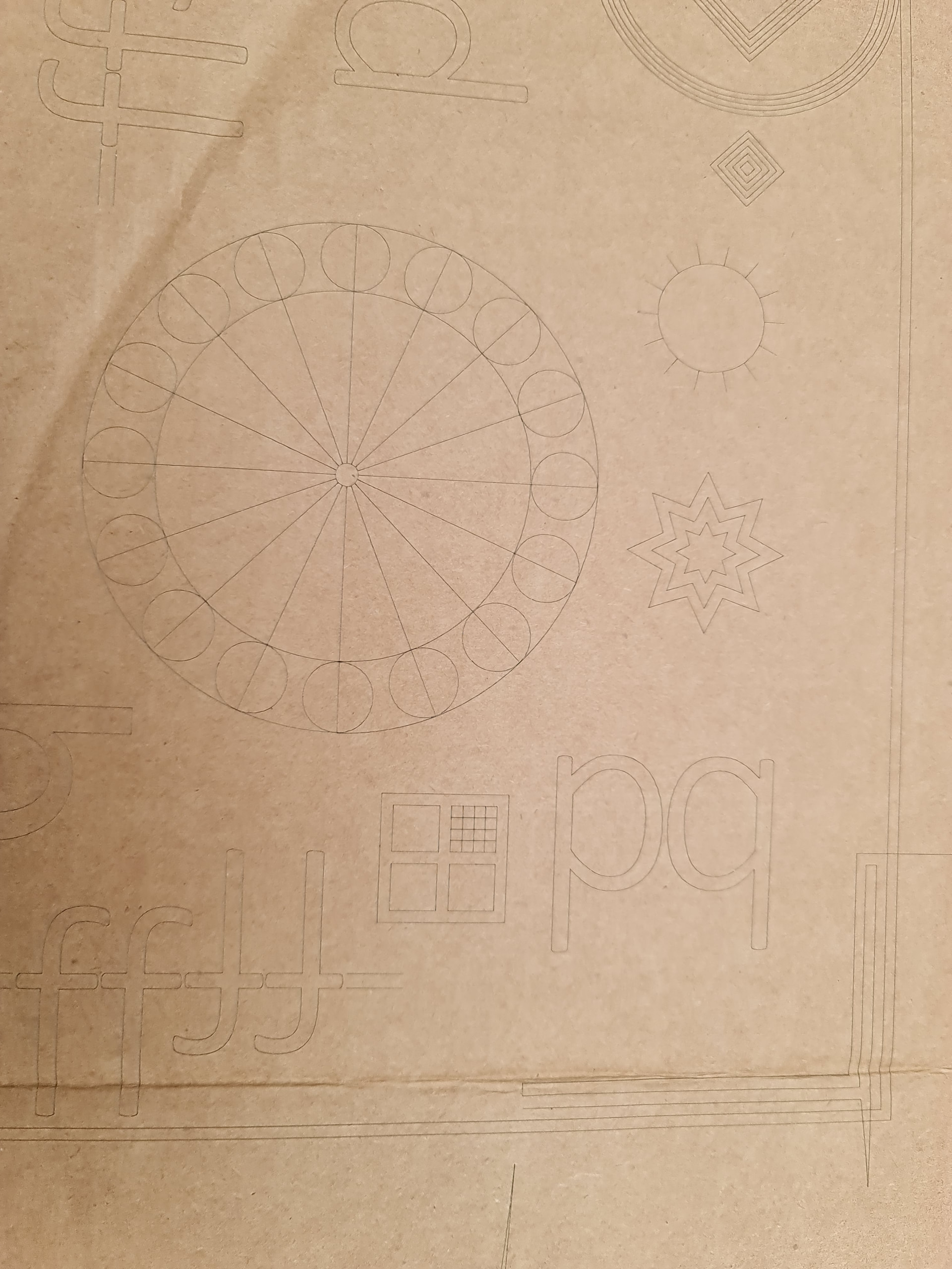

Turning the bar under the x axis, there was a delay only on one side before it moved, so I’ve tightened that belt up, now on manual movement there seems to be equal movement. Rerunning to see if it improves things
You are definitely improving it. Be sure to check the set screws where the pulleys attach to the shafts at the motors. That is a frequently missed point of play. This guide will walk you through all adjustments.

Many improvements stand out with the adjustments that have been made.
This allows us to understand the machine’s limitations.
Something I would still do is retighten the motor mounting bolts, as if they are not properly tightened, it can cause a slight movement when changing direction affecting the work.
Something that hasn’t been mentioned yet, and might help, is checking and adjusting the axis acceleration parameter. Too much abrupt acceleration is prone to this type of problem.
