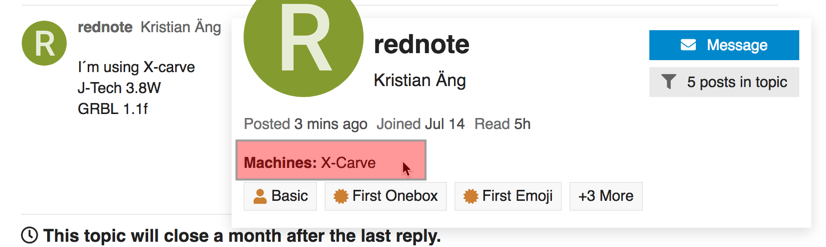

If you click on the OP’s name, you will see the profile showing that they are using an XCarve.
@rednote, you could edit your profile to provide a bit more details for your setup. Type of laser and wattage, current firmware and version used to drive this setup, and any other details that will help others know and so you don’t have to repeat yourself when posting.
I´m using X-carve
J-Tech 3.8W
GRBL 1.1f
Thank you but I was suggesting an edit to update your profile.
You can update by visiting this section of your user profile.
