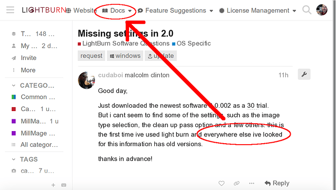

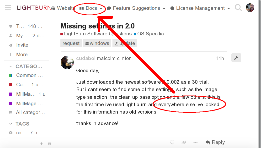

Good day,
Just downloaded the newest software 2.0.002 as a 30 trial.
But i cant seem to find some of the settings, such as the image type selection, the clean up pass option and a few others. this is the first time ive used light burn and everywhere else ive looked for this information has old versions.
thanks in advance!
Go straight to the source: :grin:
Turn off Beginner Mode to see all the (sometimes overwhelming) options.
With that in mind, however, the type of laser machine determines the options available. For example, Cleanup Pass is available only for galvo / fiber lasers and won’t appear for, say, a CO₂ gantry machine.
