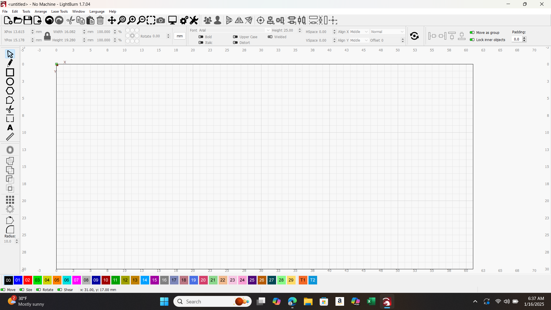

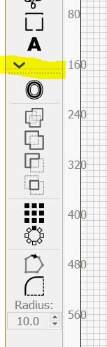

Hi everyone I’m new hear and laser is new to me but I am a cnc plasma cutting guy but not with laser just added one to my shop.My question is that I’m missing a tool button on the left side that looks like a teardrop I came across a video a little while ago thats when I noticed it was missing any ideas.Thanks Dean
Which is missing?
I think you might be referring to the Position laser tool?
Yes the one below the A text Thanks
Don´t know if this is what is happening, maybe pull down the highlighted zone.
yep tried that nothing

Please take a full screenshot of LightBurn and post here please.
That’s why. :smiley:
The screenshot shows LightBurn is running with a No Machine setup:
LightBurn - No Machine
There’s no way to move a nonexistent laser head, so LightBurn removes that icon.
