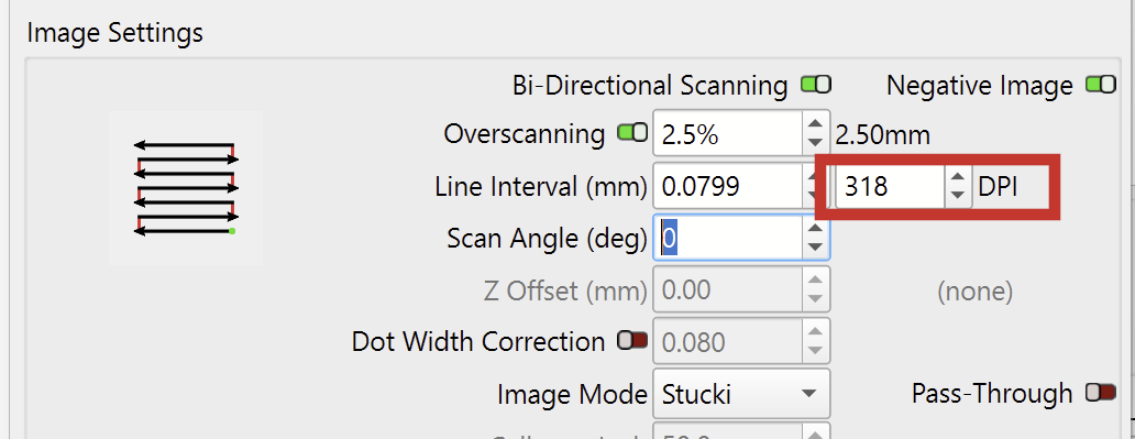

I’m using MKS DLC 32 V2.1 board with TMC2209 drivers on XY belt drive DIY laser diode machine. I’m working on engraving large 318 DPI image on 40x40cm tile. The generated G-code from Lightburn came out in size of 82MB.
The job was always stops at around 14 hours running time from estimated 18 hours finish job.

Are you referring to the source Image’s resolution, or the Line Interval / DPI shown in the LightBurn Cut Settings?

I set the image in GIMP to 318 DPI, dithering and set the same DPI in LB.
