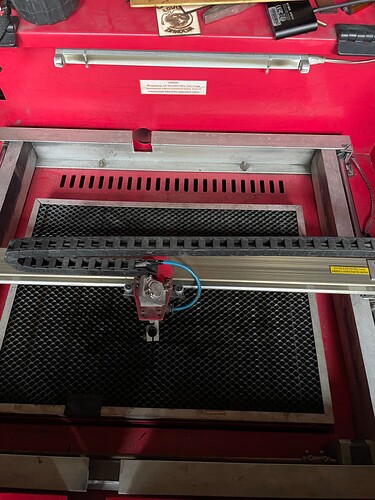

I have Co2 similar to K40, I bought MKS DLC32 V2.1, I connected everything correctly. I am moving the axes correctly on the touch panel. The problem is the home position. It doesn’t fit where it should. Ultimately, it should be the upper right corner, when adding the laser I marked it. I’ve tried different combinations and my hands are falling apart. Please help

I recorded a video, I think you can see the problem well on it

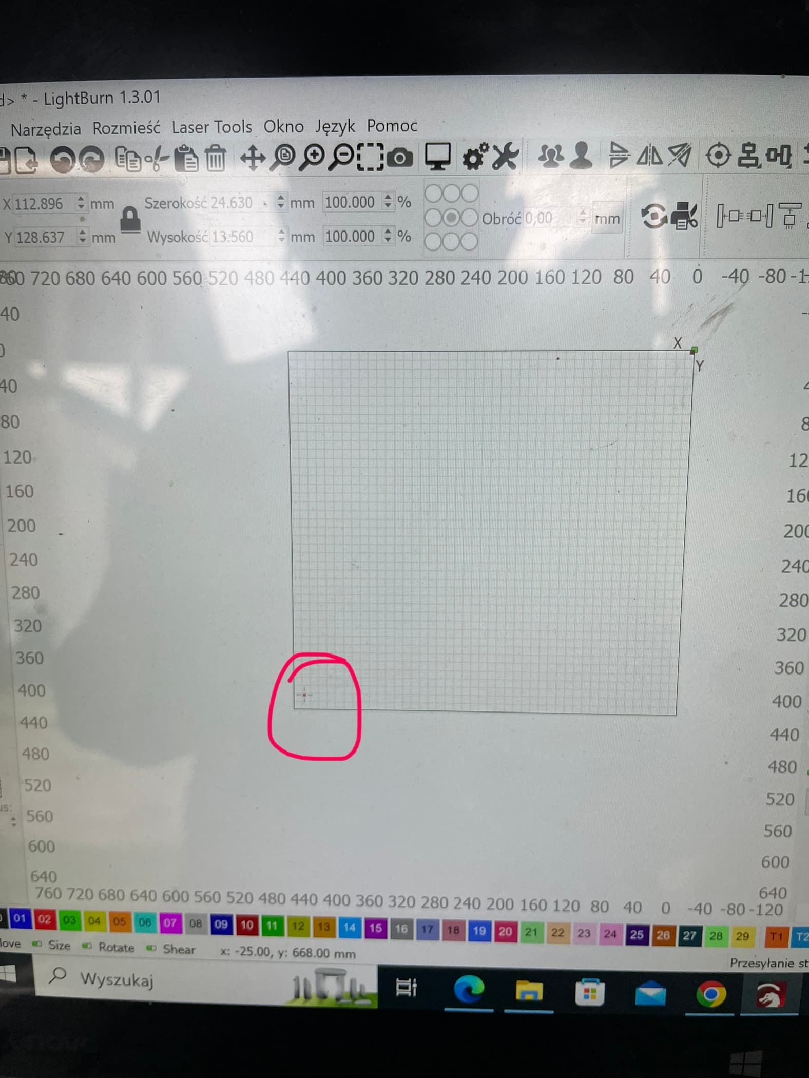

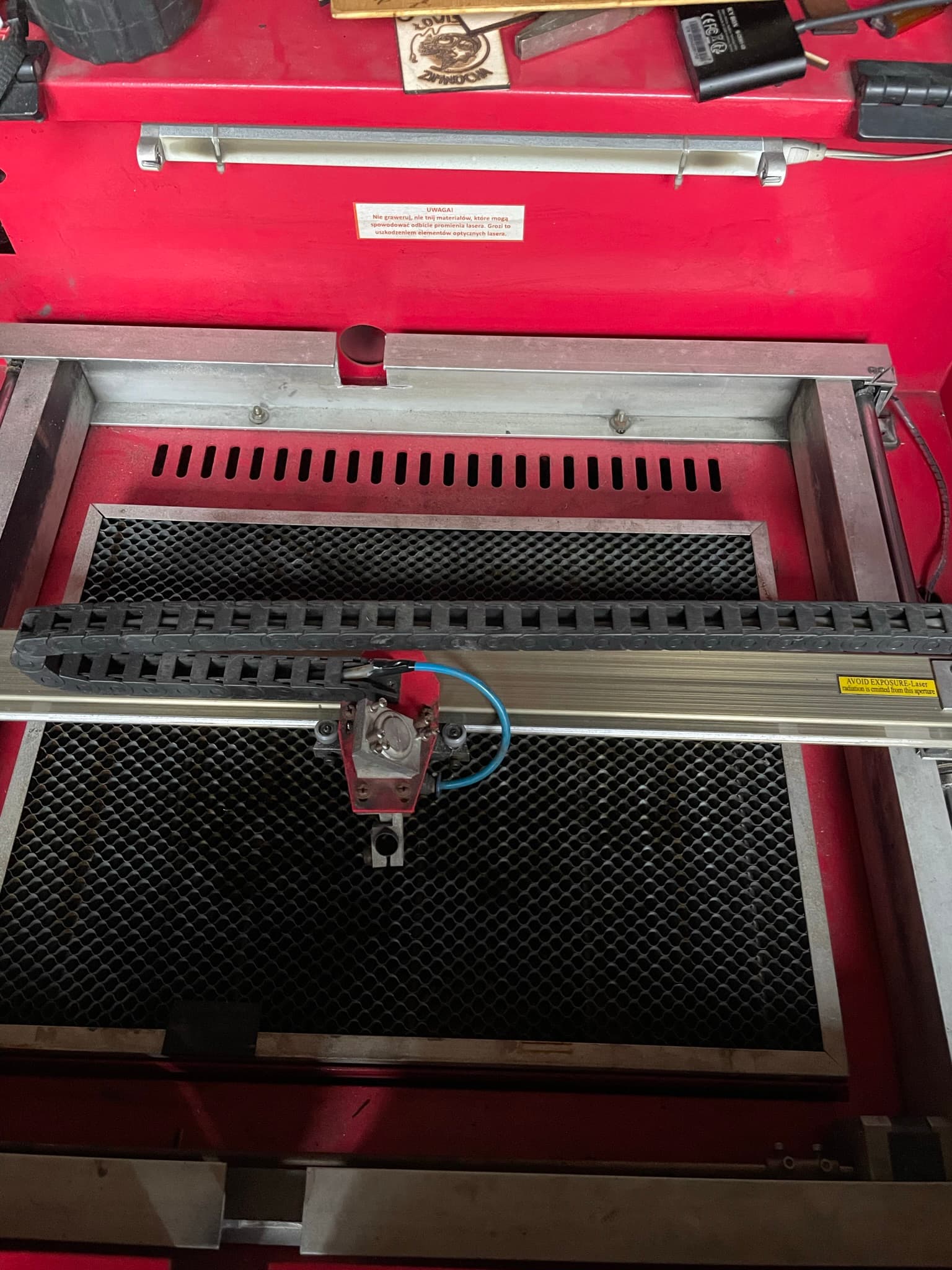

Another problem I have is the distances in the program do not deal with it on the table.
he was in the home position, I set the cursor to his position on the other side (photo 1) and he did not arrive (photo 2)
First, can you confirm the actual size of your bed? Is it 400mm wide by 300mm tall? Note that your workspace doesn’t seem to match these values. You can change this in Edit->Device Settings.
Second, you may need to calibrate the step size for your stepper motors. I noticed that your homing movement was unusually slow in the video. This may explain that.
You can use either Edit->Machine Settings->Calibrate Axis to recalibrate the step size or do this manually. The relevant GRBL settings are $100 and $101 for X and Y respectively.
Machine Settings - LightBurn Software Documentation
I calibrated the axis as you wrote. It’s fine :slight_smile: Thank you again
