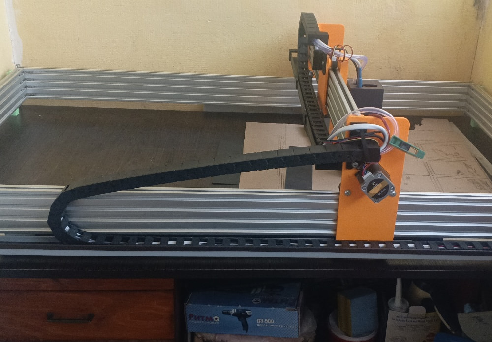

Sorry for the confusion in the title. I have a large laser machine with two stepper motors on the Y-axis.
My MKS DLC32 V2.1 board has X, Y, and Z driver slots. I want to use the Z-driver slot for the second Y-motor (Dual Y).

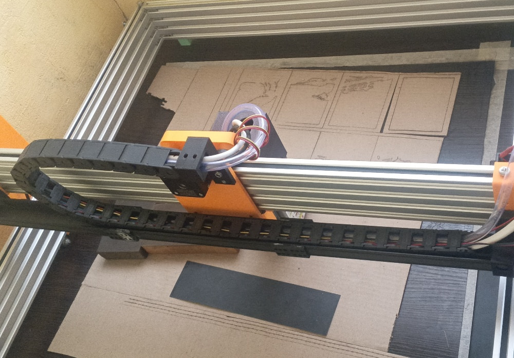

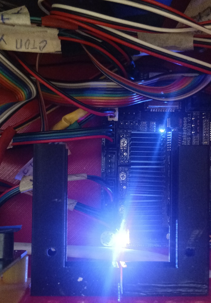

Hi Kuth, thank you for the feedback. Here are the photos of my machine.
As you can see, it is a custom build with a large and heavy gantry. I am using an MKS DLC32 V2.1 board, and I have all 4 driver slots populated (X, Y1, Y2, and Z as the second Y axis).
Using a single driver for both motors on such a wide gantry often leads to racking (mechanical tilt) if one side skips a step. That is why I need “Auto-Squaring” via FluidNC to ensure the gantry stays perfectly perpendicular.
I would be very grateful if you or anyone else familiar with FluidNC could help me with a config template for this board to run Dual Y on the Z-driver pins.
“The main reason I want separate drivers for the Y-axis is to achieve Auto-Squaring. On a gantry this wide, manual alignment is difficult, and FluidNC’s ability to square the axes during homing is exactly what I need for precision.”

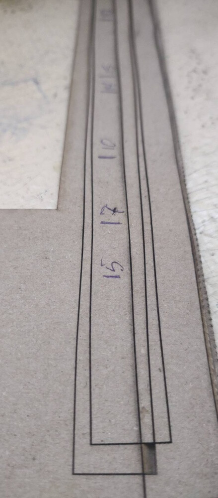

One more thing I noticed during test cuts: when cutting along the X-axis, the lines are wavy (jittery), but along the Y-axis, they are perfectly straight.
This confirms that the Y-axis gantry (which is heavy) is not moving smoothly or is racking due to the single driver setup. This is exactly why I want to separate the motors to two independent drivers to stabilize the movement.

The mechanical part is ready: I have separate drivers for both Y motors. Now I just need to figure out the config.yaml file. Since I’m using the MKS DLC32 V2.1, I need to map the Y2 motor to the Z-axis pins.
Does anyone have a working config.yaml for this board that I could use as a starting point? I can adjust the speeds and accelerations later, I just need the basic pin mapping to get it moving.

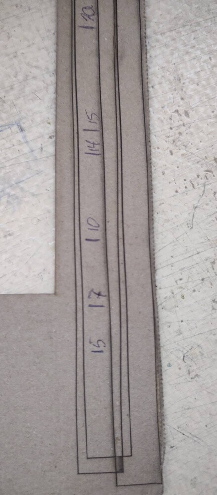

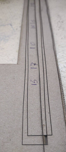

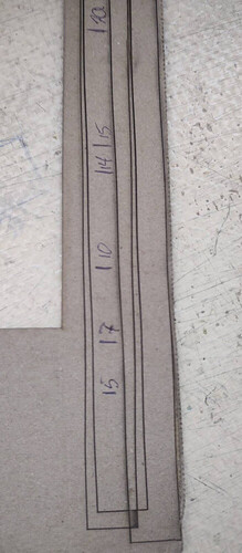

Here is the visual proof of the issue.
The vertical lines (Y-axis movement) are smooth and straight.
But look at the horizontal lines (X-axis movement) — they are wavy and look like “steps”.
This happens because the heavy gantry is not held firmly by a single motor/driver setup. When the X-carriage moves, the gantry vibrates or racks. I am convinced that moving to a Dual-Y setup with independent drivers via FluidNC will solve this mechanical resonance.
Still looking for a working MKS DLC32 V2.1 config.yaml to map the Y2 motor to the Z-driver slot. Any help is appreciated!
Judging from the hardware in the pictures and the long “wavelength” of those wobbles, it seems much more likely those (3D printed?) slabs are flexing or the rollers tilting in the extrusions.
You can test for that by positioning the head in the middle of the platform, turning the laser on at a low-but-visible level, then pushing the top / bottom of the laser head with a fingertip. If the focused spot moves at all under moderate fingertip pressure, then the mounts aren’t stiff enough.

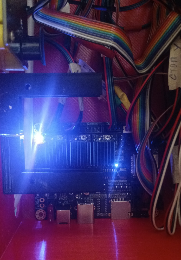

Quick update: I’ve tested the board with the stock MKS firmware, and it works perfectly. All motors move, which means the hardware and the Z-driver slot are 100% functional.
The issue is strictly with FluidNC configuration. When I flash FluidNC, the board becomes unresponsive because I don’t have the correct config.yaml for this V2.1 revision.
Can someone please provide the exact GPIO mapping for the Step, Dir, and Enable pins for the Z-axis slot on this board? Once I have those, I can finally sync my dual Y-axis.
Did you try here?
I lost a disk drive and it’s backup, so I can’t really help you. Seems to me most of this is laid out in the schematic on GitHub…
